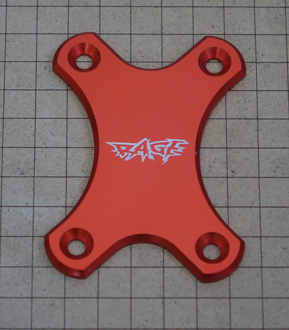

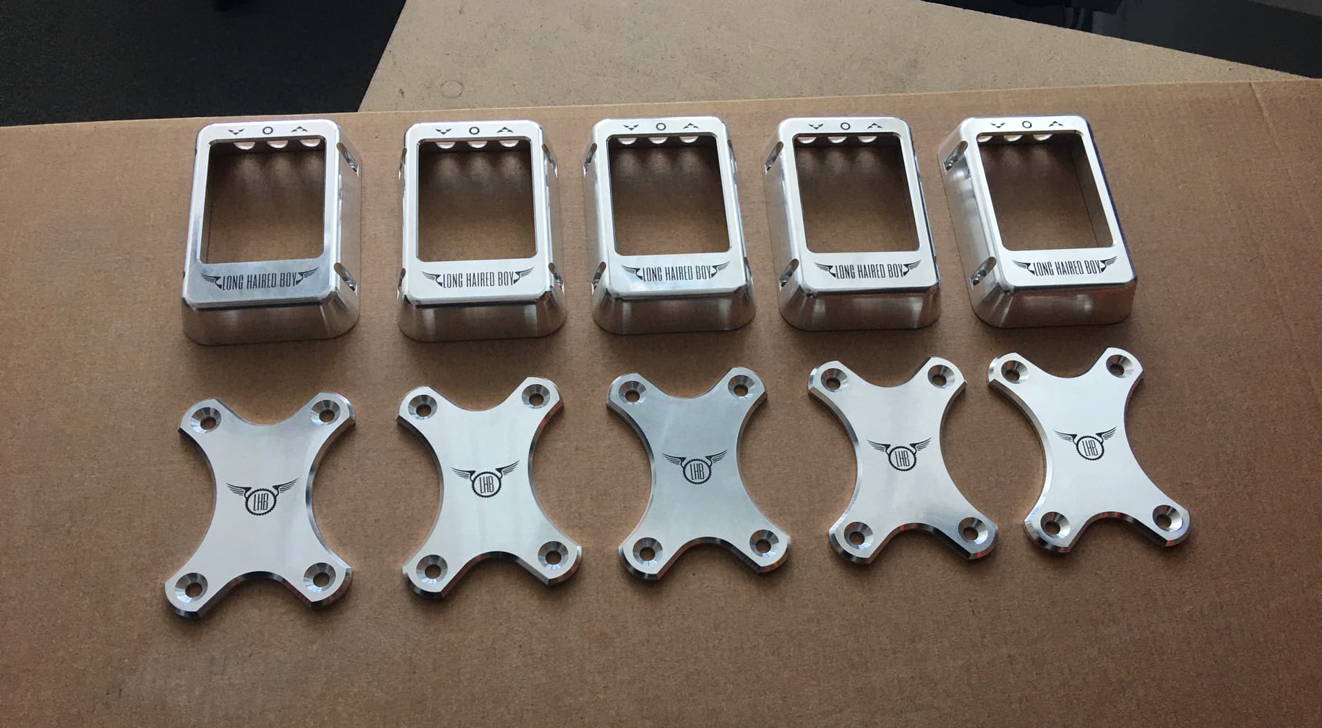

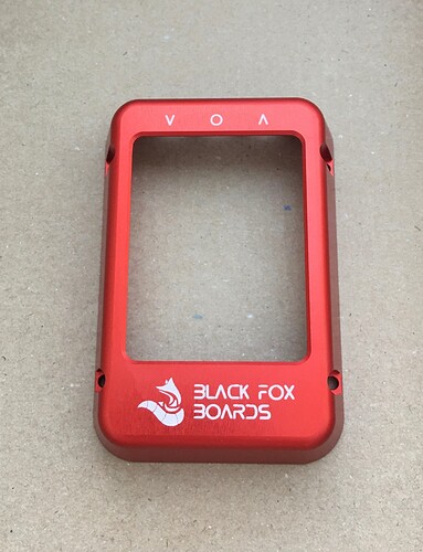

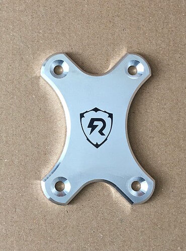

How do I get the laser engraving?
Please PM me and we’ll sort out the details. I currently have blank housings in these colors:
  • black
  • red
  • blue
X-brackets in all colors available in the e-shop can be laser engraved, except for the raw. (My diode laser does not have enough power to do it.)
How do I prepare the graphics for the engraving?
I will help you with that. No worries. If you have an image/logo you’d like engraved, best if you can send it to me in a vector format (svg, eps, pdf), but I can convert/vectorize other formats as well. If you just have an idea and no experience with graphical software, just tell me the idea and I’ll see what I can do.
Before running the laser, I will send you a preview for approval. It will look something like this:
Examples of branded/personalised parts
