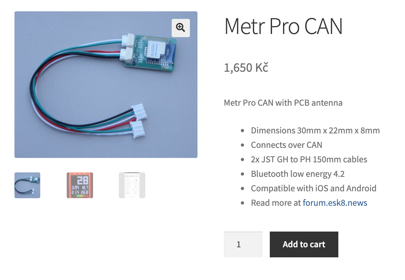

Metr Pro CAN is now available from shop.davega.eu so you can grab one along with a DAVEGA X and make use of the MeGA features (currently there are not many but more are planned).
The price is slightly more expensive than if you buy from metr.at but you save 12 EUR on shipping.

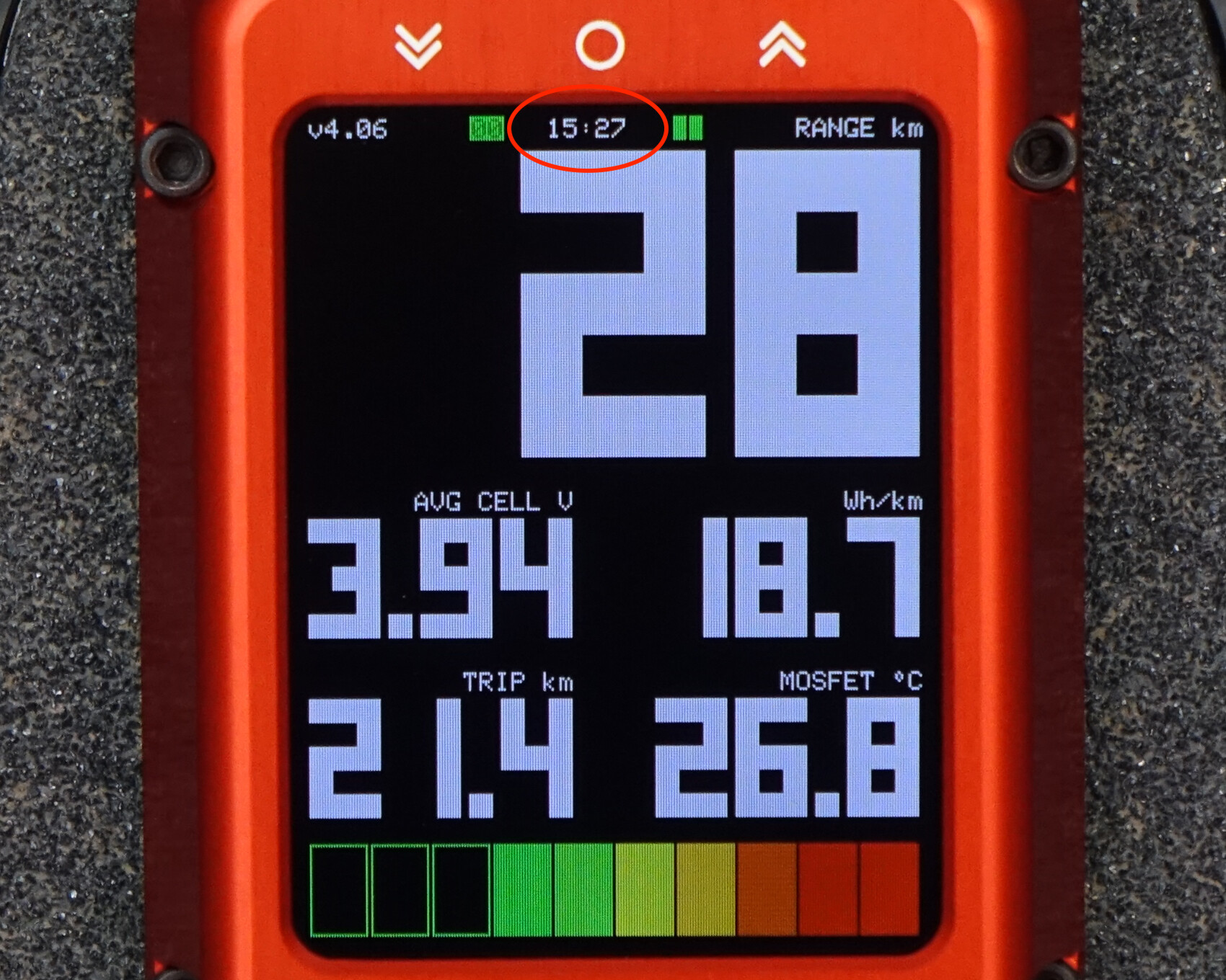

Firmware v4.08
Most important updates:
  • ENNOID BMS support
  • cell voltages display for up to 24S
  • range ramp up (range temporarily projected from lifetime data after session reset)
    • demo below
  • lifetime max speed can be reset
CHANGELOG entry:
- ENNOID BMS support
- cell voltages display for up to 24S
- range ramp up (range temporarily projected from lifetime data after session reset)
- lifetime max speed can be reset
- battery capacity settings: step changed from 1 mAh to 50 mAh
- session mAh in/out changed to Ah and values above 9999 mAh can now be displayed
- fix: odometer not saved upon stopping
- fix: fixes/improvements to the landscape mode view
- fix: updating config from Metr CAN with empty wifi settings
- various other minor fixes
Range ramp up demo (if you haven’t seen it yet):
I’ve been holding the v4.08 in the RC state for an embarrassingly long time. The main reason is that I wanted to test the ENNOID BMS support. I received a sample BMS unit from Kevin to use for testing but I haven’t been able to get the communication working. After double-checking I’m not doing anything wrong with Kevin we concluded the CAN circuitry must be faulty on this particular unit. So I shipped it back and now I’m waiting for another one.
Unfortunately the ENNOID support hasn’t received the testing that would be appropriate for a stable release. There are probably a few loose ends that will need addressing later. I don’t want to be holding this release back in RC anymore though so it’s coming out as is.
