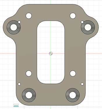

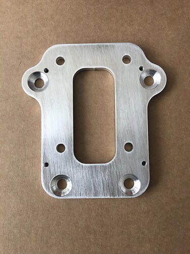

Here’s what the prototype looks like:
The idea is you use it as an adapter for the angled baseplate that gets attached to the M5 threaded holes using short M5 countersunk bolts:
Then everything aligns perfectly.

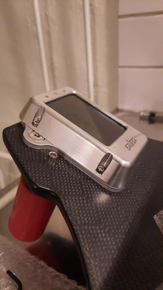

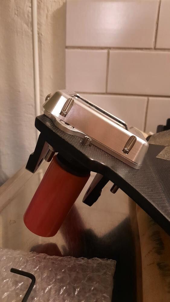

Alternatively, the adapter can be used as a baseplate and the housing is attached to the M3 threaded holes (photos credit Fredrik Jouper):
Then there’s a little bit of a misalignment since the profile of the bottom side of the angled baseplate is different from the profile of the top side (and the housing). It’s not too bad though.
Also, the adapter is not flush with the deck so it would be better to move the holes so that it sits lower. That’s unfortunately not so easy to achieve though. If moved by 2mm the top M3 holes get in the way of the truck bolts:
I could move them just 1mm. That may still not be perfect but would be slightly better.
Or, I could get rid of the M3 holes completely. Then it can only be used as an adapter for the angled baseplate but there would be more flexibility in positioning.
I’m leaning towards the former. Any thoughts on this?

I dont have a kaly so I have no skin in the game, but I would say it’s better to have the option to use it without the angled baseplate. I use my DavegaX flat on the 30 degree tip of my Haero Bro, and I like it at that angle.
