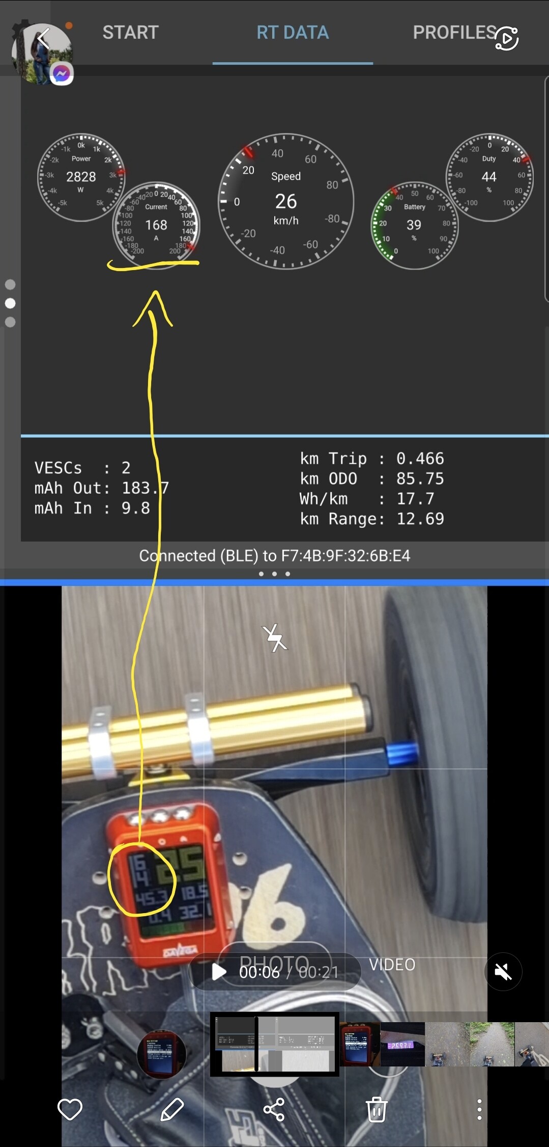

Turned to motor amps to cheat the numbers a bit and:
I think something weird happened when i did hit 200A (not on this occasion) but beyond that i understand what’s going on there now.

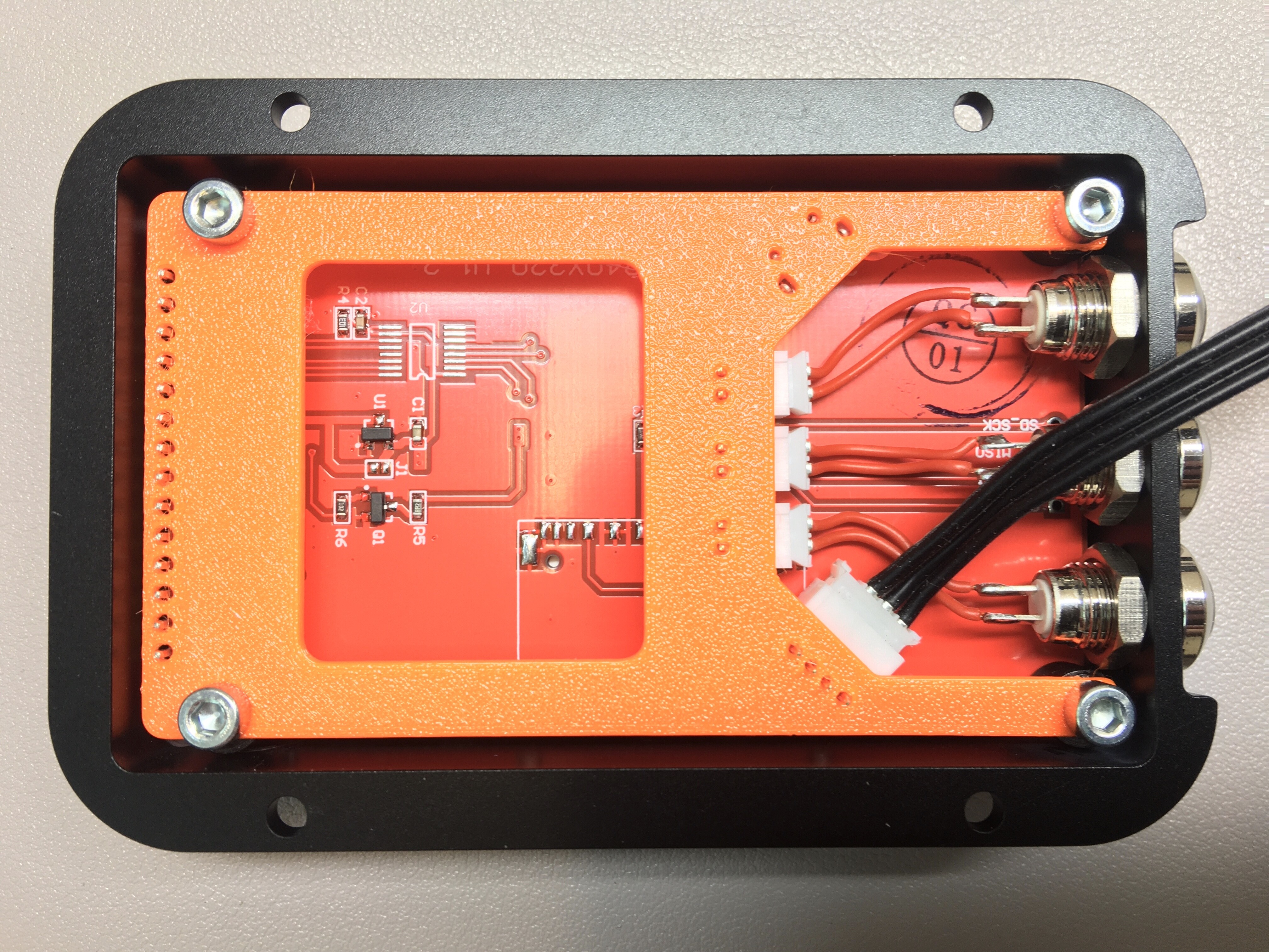

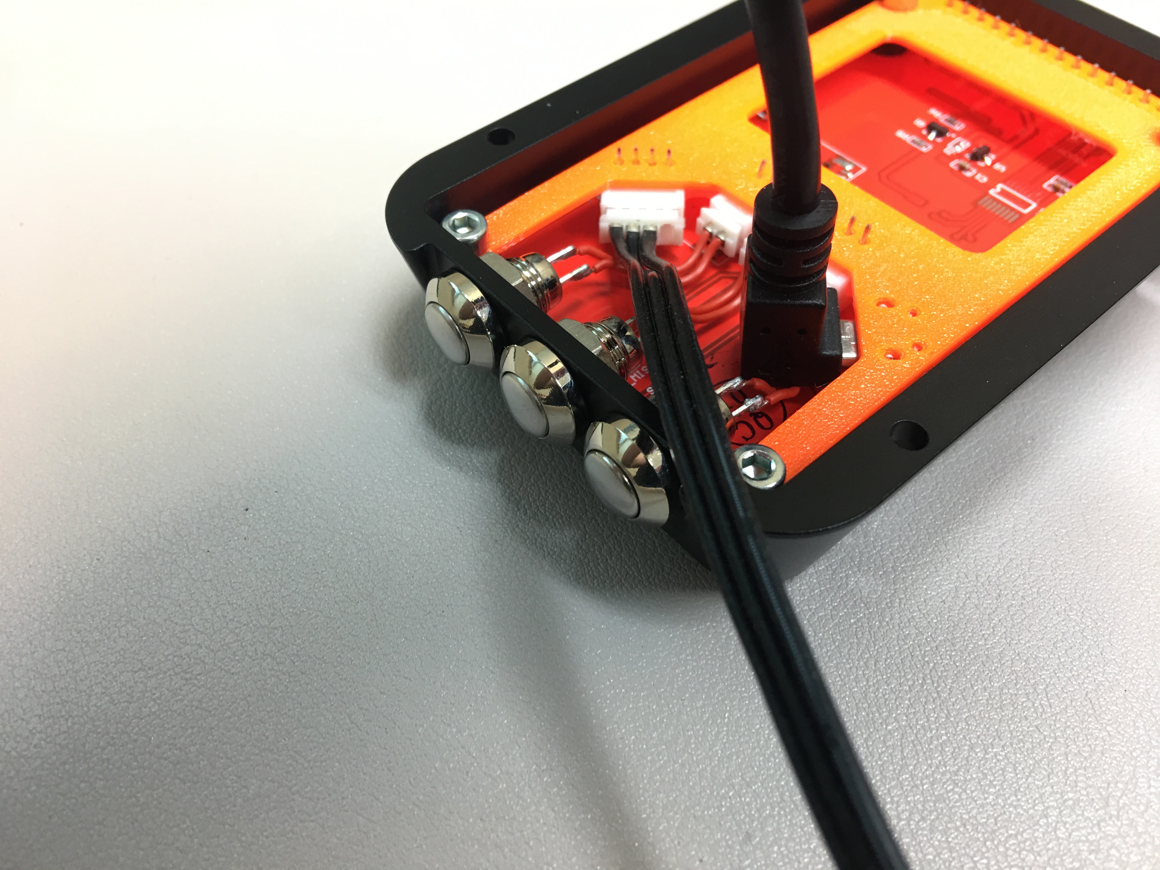

I’m reworking the DAVEGA PCB with the idea of no longer relying on ESP32 development boards, which would make the design cleaner and would speed up manufacturing. Soldering the ESP32 development boards on the current DAVEGA PCB is tedious.
Since I’m already at it, I would like to make the USB port easier to access, ideally such that you don’t need to take the DAVEGA apart to access the port.

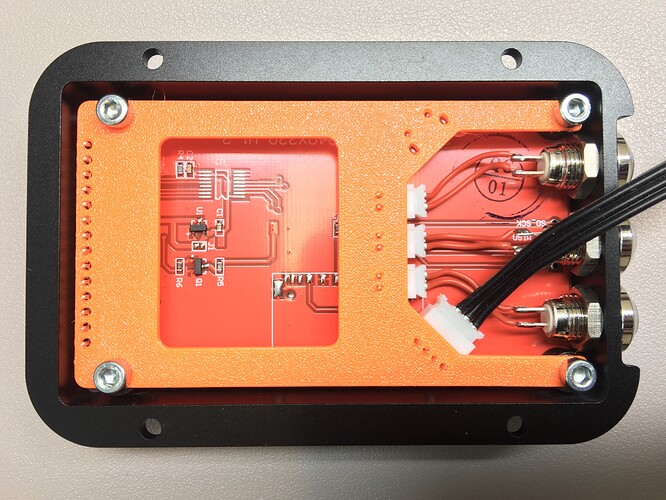

Here’s what I came up with so far:
This seems to work but there are a few problems with it.
First, the UART cable is now slightly more difficult to plug in since the nearest button wires are a little bit in the way. This is very minor and essentially a no issue. I can also make the button wires longer which will help. It’s still slightly worse than before.

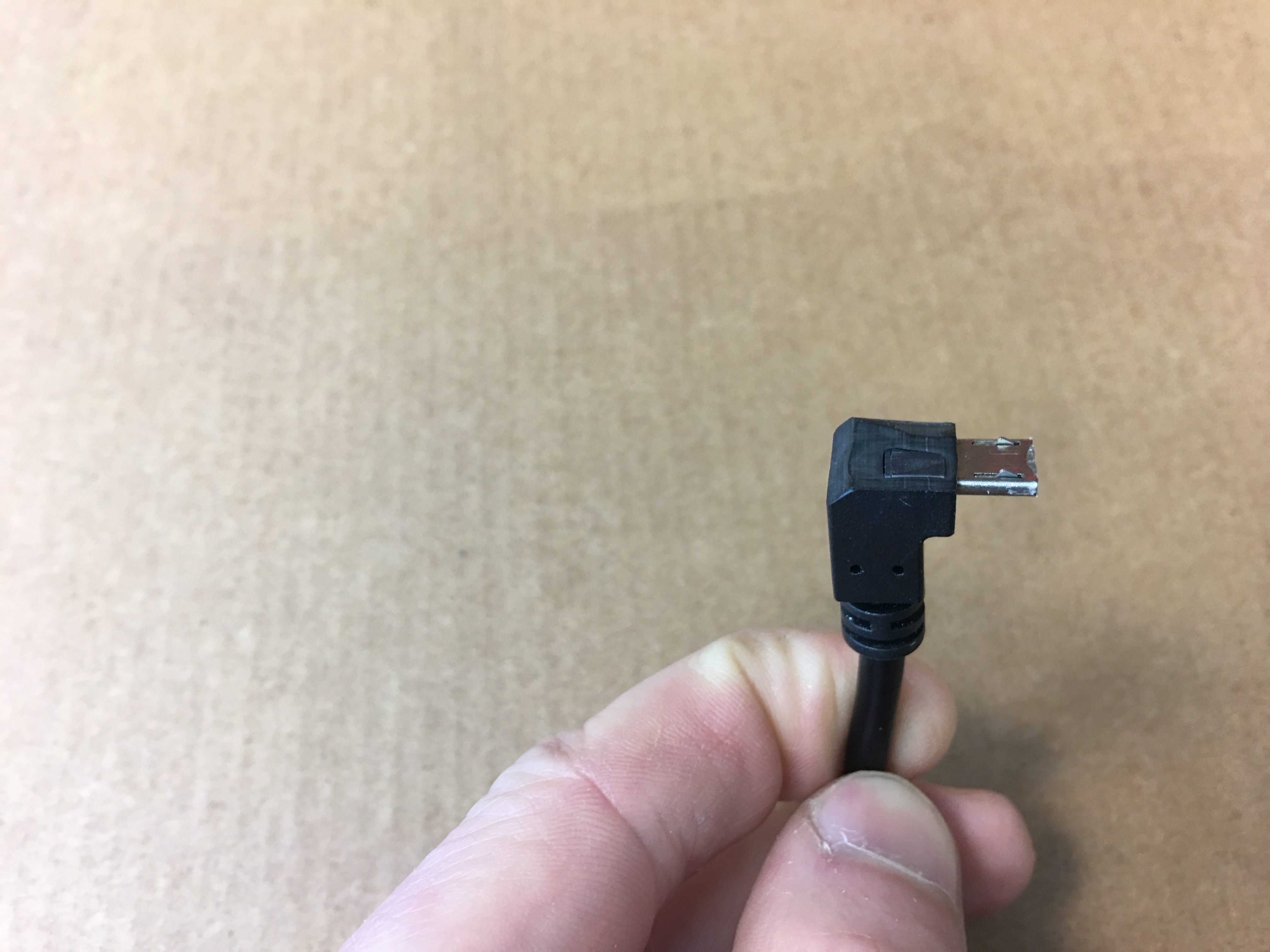

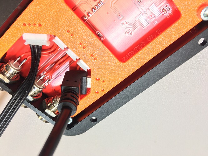

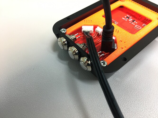

Second, there’s not enough space for a standard USB cable. You need a right angle USB cable, which most people won’t have at home so it would probably have to come with the DAVEGA. These are cheap so it’s not a big deal. It’s still another thing to worry about.
Also, the insulation on the USB connector needs to be cut so that it fits. Again, not a problem but not ideal either.
Overall, I’m not sure whether this design change wouldn’t actually be a step back.
With the firmware v4.xx it should be very rare that you need to access the USB port. It’s actually only in case of a flash memory corruption, in which case you need to do a clean firmware installation. I haven’t had any reported with v4.xx though so it might be it’s finally fixed.
I wonder what people think. Change the connector positions or better keep as is?

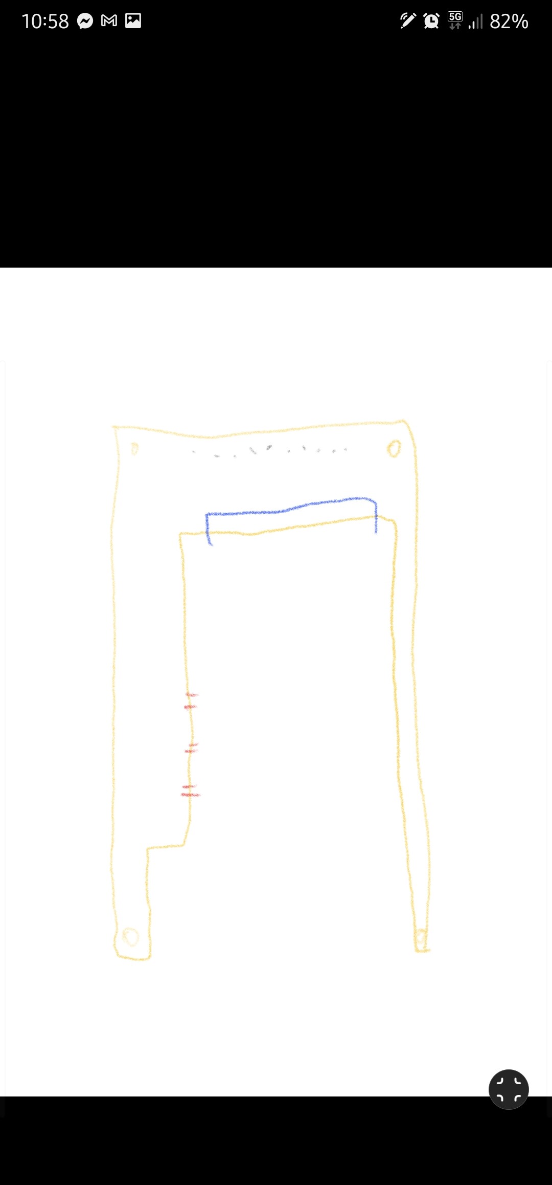

Can you put the usb and connectors on the first pcb and cutout the correct holes through the second one?
Same way trampa does it
This way everything fits on the first pcb and the second one is just a mask/protection (i did not open mine to see if there’s more going on there)
Modifying the display PCB is currently not an option. Otherwise, I agree that would be the best solution.
Then:
Hope it’s somewhat readable. Blue parts mean places usb can be soldered on. That leaves quite a bit of space for the usb plastic handle/shell to fit
Or:
No, thanks for trying but that won’t work. I still need to put the MCU and other stuff on the PCB. There’s not that much space available. The cutout I have on the mockup can’t actually be much larger than that.
Edit: The big rectangular cutout in the middle on the mockup is just to save filament. That area will be populated on the actual PCB.
Ah, didn’t realise there’s more going on on that pcb. Usb would need 3-4cm straight line to connect, not easy to do.
One more idea i have is to take a micro usb pcb and put a 4pin jst plug on it, that way it can be removed just like the uart cable. That will cost a bit more in parts and the usb thingy can be lost in time
I say keep it as is. If access to the USB port is needed, whats the difference between removing 4 bolts (to take the unit off the mounting plate) vs 8 bolts (to also unscrew the PCB from the housing)? Seems like a lot of headache for not a lot of gain.
I think you’re right. The main advantage I can think of is for me to do the provisioning. I could potentially tinker with the firmware even after the electronics have been installed to the housing without taking it apart. Probably still not worth it though.
