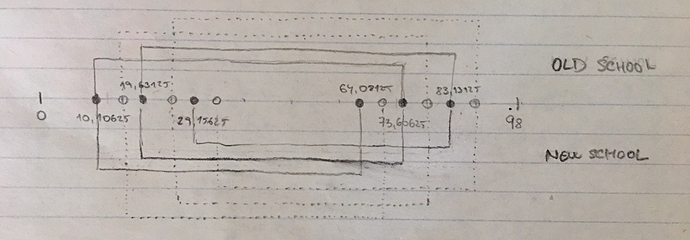

Here is the dimensions of the base plate for those interested.
This is a hole pattern for new school and old school, it can fit both.
Old%20School%20New%20School%20bolt%20pattern%20skateboard
There is one issue though the front most counter sunk truck holes leave a small gap where water could get in. So I’m considering removing these extra holes so you could get a nice gasket seal all the way around. But you would loose the adjustable positioning. It would still fit old and new school.
Then the plate would look like this.
What you guys think, would you give up the adjustable positioning for better waterproofing?

Cool but that won’t fit me :frowning: I think trampa threw old/new school out the window on their mini Carver trucks
How about keeping just 4 holes but position them in asymmetric way so that you can get a different position by rotating the baseplate 180 degrees?
If we positioned the holes like this it would give us 2 mounting options for old school and 4 for new school.
The empty circles are the mirrored holes (if you rotate the baseplates 180 degrees). The offsets are such that the 4 positions for the new school pattern are equidistant.
I hope it makes sense. I don’t even have a ruler around to make a better drawing, sorry. :sweat_smile:
Edit: Oops. Wrong. The new school in my drawing should actually be old school. Let me correct it.

Corrected. This way we would get 4 options for old school and 6 options for new school.
