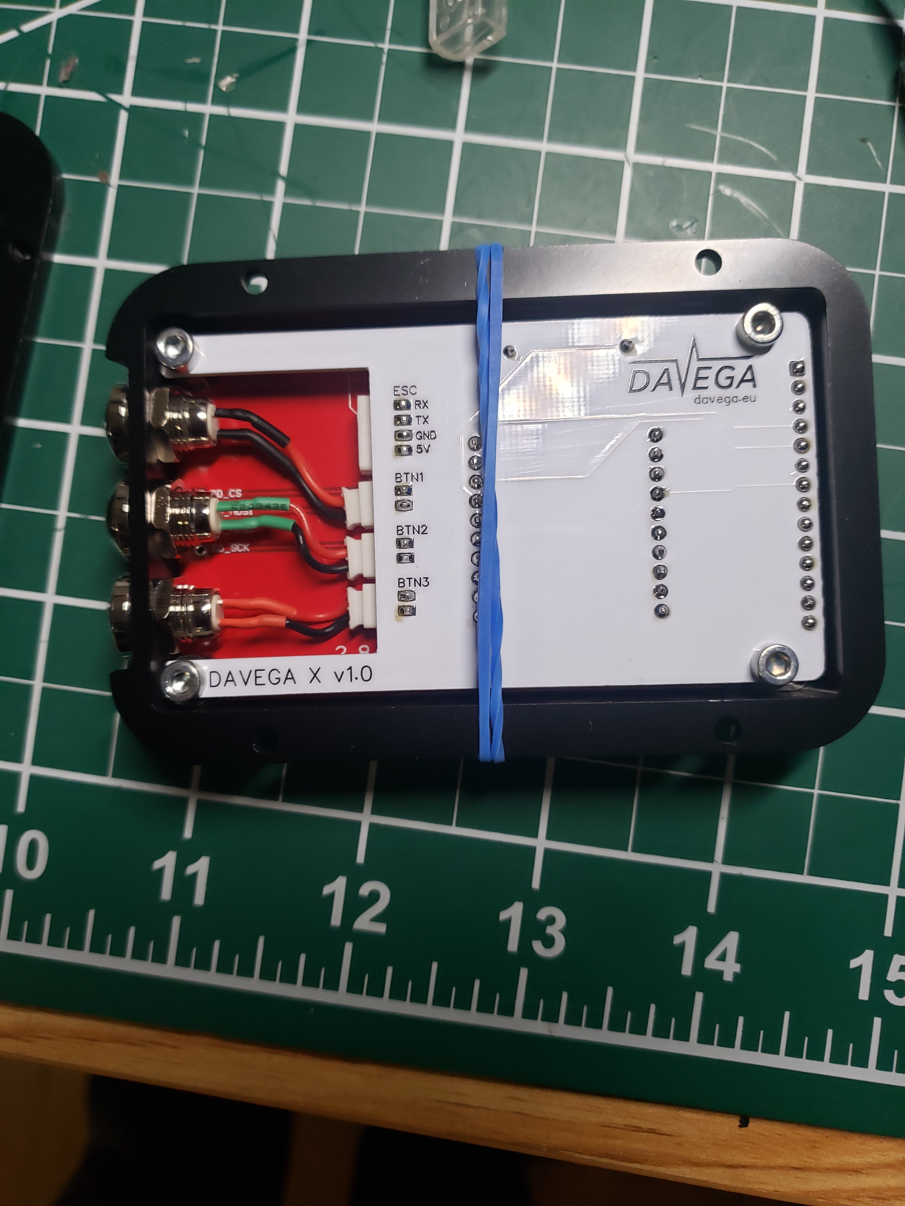

I know it’s not visible but that bottom plate looks nice so I don’t really want to cut anything into it :sweat_smile:
I also figured a plastic spacer is either much easier to cut or just print directly to shape. The spacer may also act as a dampener too. Which gets me thinking, maybe I should just cut up a rubber riser.
Another benefit with spacer is you can increase the cavity space underneath DaVega. Not sure why you would want to but I’m sure somebody can figure out a good use for that space haha.

Or you could make a thick-ish gasket to put between the baseplate and the housing. That would also help with waterproofing so you would kill two birds with one stone.

I am planning to keep the metal base plate and just adding a plastic spacer between the base plate and top so I can snake out the vesc cable.
