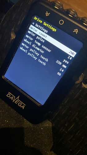

Anyone know what drive inputs I need to add to get the correct speed, my davega speedometer says 3mph and my wand is saying 22mph.
Input I put in the drive settings for my 9inch pro belt are:
Wheel:220
Motor pulley:14
Wheel pulley:66
Please send a screenshot of your drive settings.
Has anyone else had the issue where davega reads a fair bit under what the VESC sees? Mine is showing 49.5V fully charged and the VESC is seeing 50.2V, it doesn’t fill the battery meter up on the davega and it’s triggering my OCD!
I had a similar issue, and Jan said that the davega reads only what the vesc sees, and that there’s likely a slight variation between your vescs (I figure you’re plugging the non-davega vesc into your computer… Otherwise I dunno). He reccomend I switch the vesc that it’s connected to (though I was too lazy to bother )
That’s a VESC issue. A well known one.
I thought this was normal. I’ve been seeing this on my units for a while now. I just quickly pull up my smart bms to check the “real” reading.
Mine is always .6-.7 below the actual voltage, no matter where the battery is sitting on the voltage curve.
Does yours change as the battery pack depletes?
This. Always.
It doesn’t show speed when you’re stationary. Then the speed is 0 and you know that so it would be redundant information.
Ahhh! Lol right on. Thank you!
