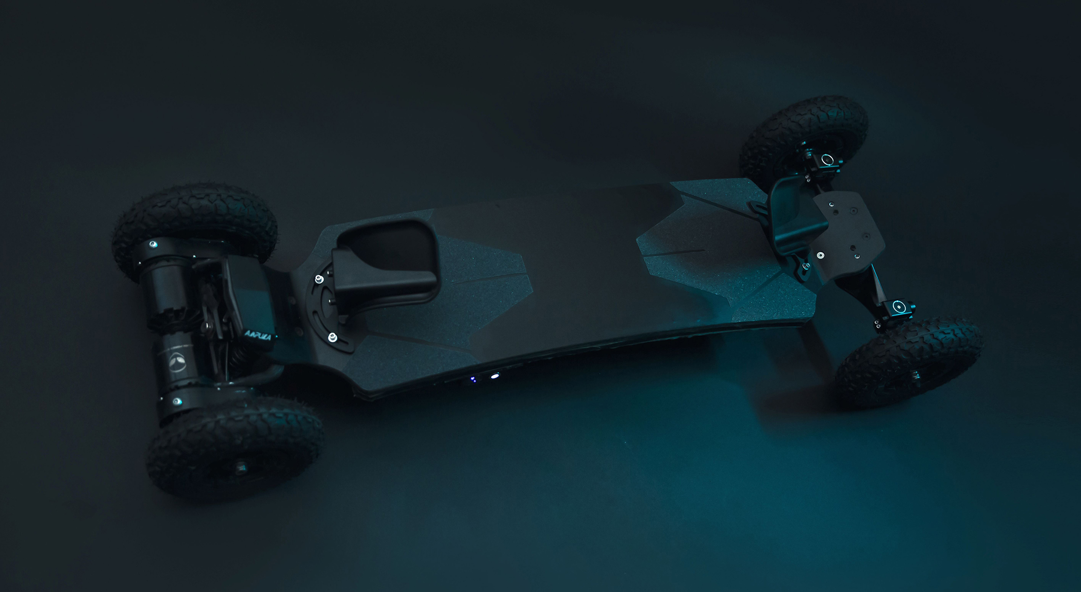

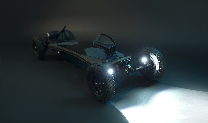

Hey guys! Here are some photos with the board I build last year. It is a mix between Urban Carver and Mountain board. Basically, it’s an Urban carver with an ATB Hanger, cause I think it gives the board a more muscle car look, plus, I had room for Kaly’s light stands. I have used the FatBoy SS Mini Drive V3 1:3 with 2 APS 6374 170KV motors, Unity speed controller and a 12S7P battery made by me. Below there is a link to the tread in which I posted images with the battery progress:
The grip tape is designed by me, it’s called Double Camel Toe :)). It wasn’t intentional, I just realized the resemblance after I finished it. I’ll post more updates with custom accessories that I will create for this board.

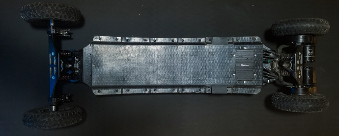

@glyphiks Here are some details about the enclosure. As I said earlier, it’s a Trampa enclosure to which I added a layer of rubber of 1cm thickness between the deck and the enclosure to make room for a double layered battery pack. On the sides, I added 2 mini enclosures for the start button and a Bioboards display on a side and a Rosenberg charging port on the other.
And here is the final look with the artwork printed on it.

I had a Trampa Urban Carver before and since I loved how it handled sharp turns I decided the build one with a bigger battery pack ( this one), instead of a Mountain board.
While building it I realize I don’t have space to install Kaly’s light stands on the front Mini Truck the Carver has, so I bought a a full size hanger for the front.
I really love how it looks, I think it’s a quite unique look and it gives the board a muscle car feel…and I love muscle cars haha.
