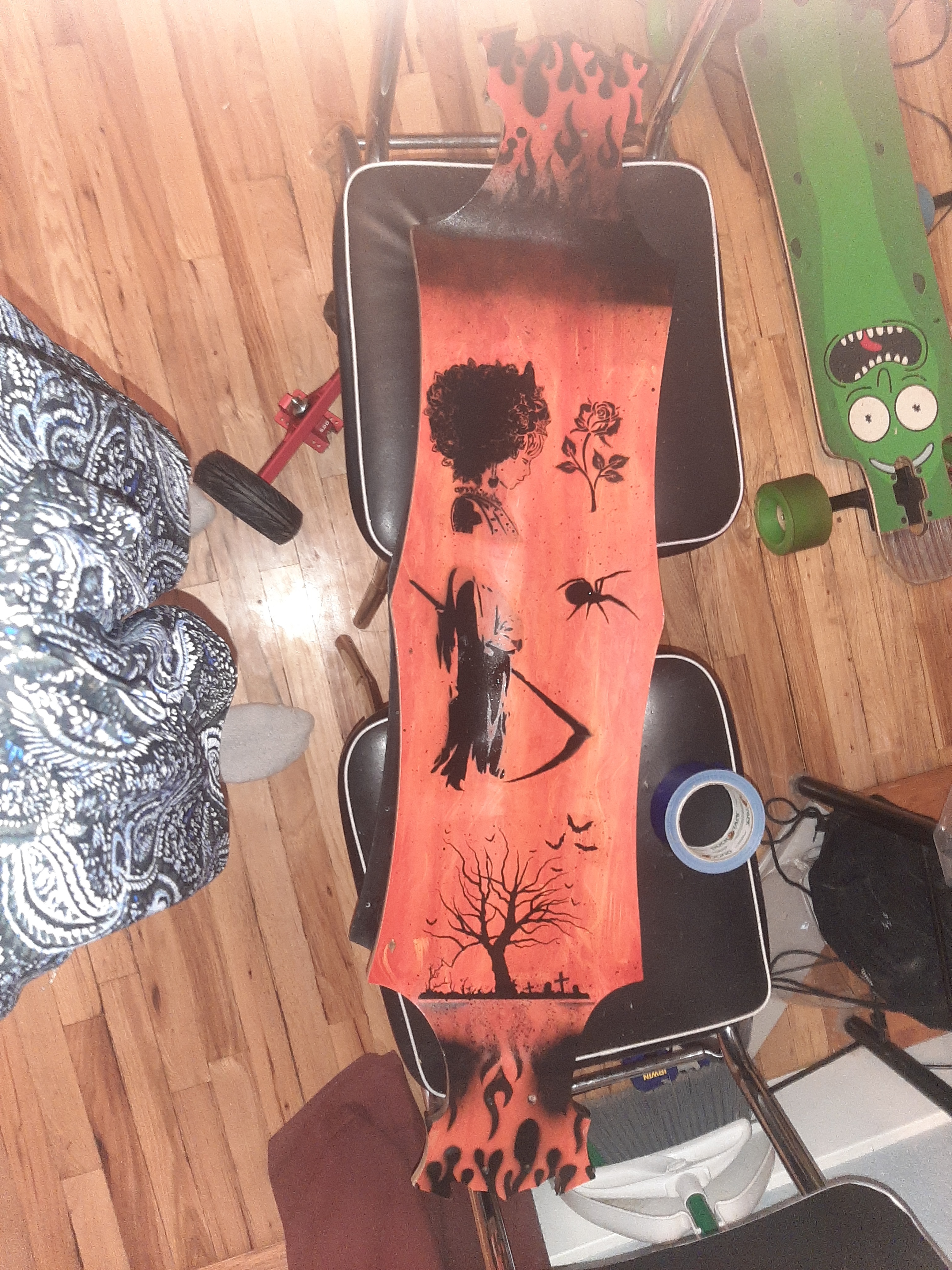

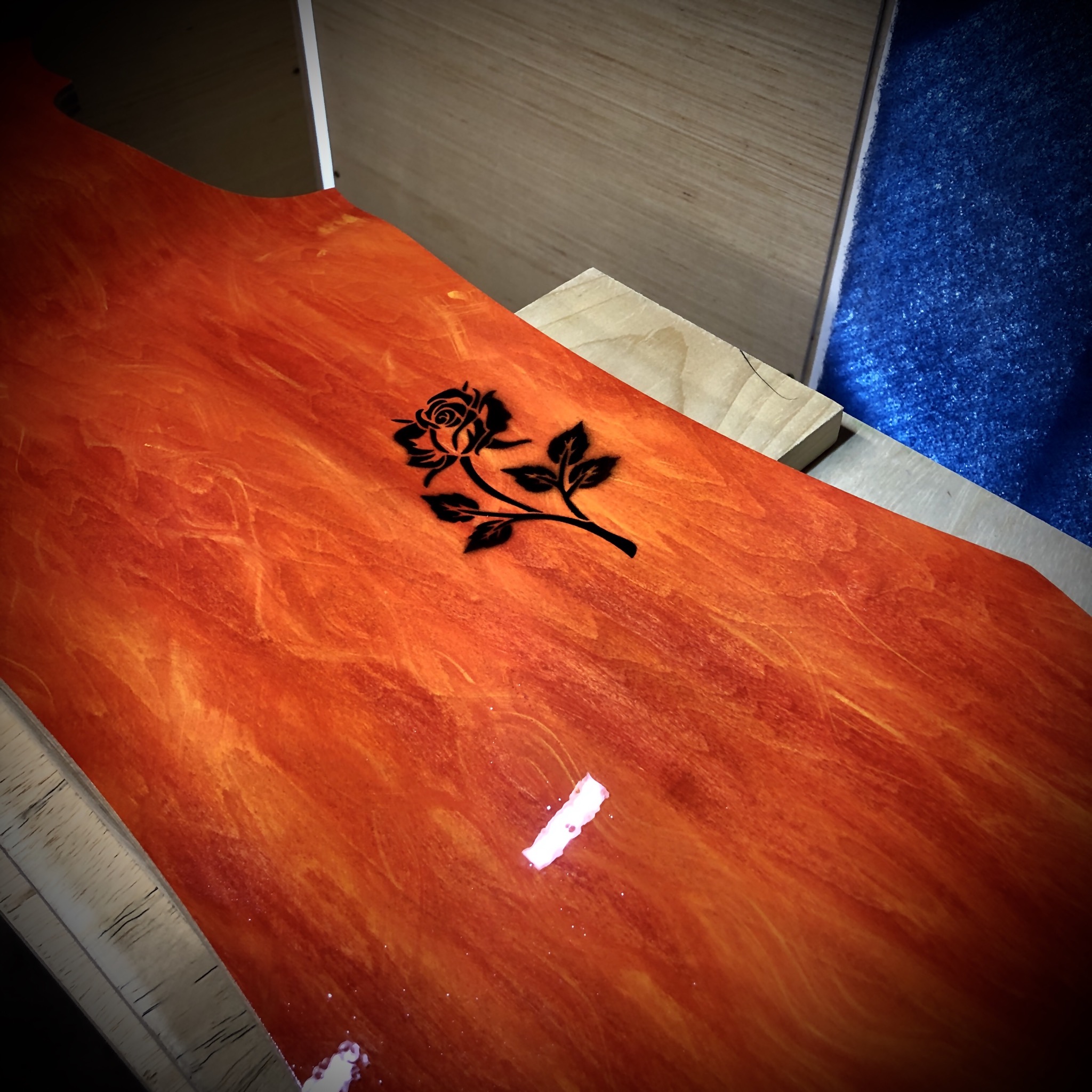

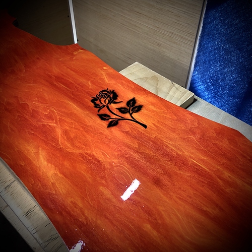

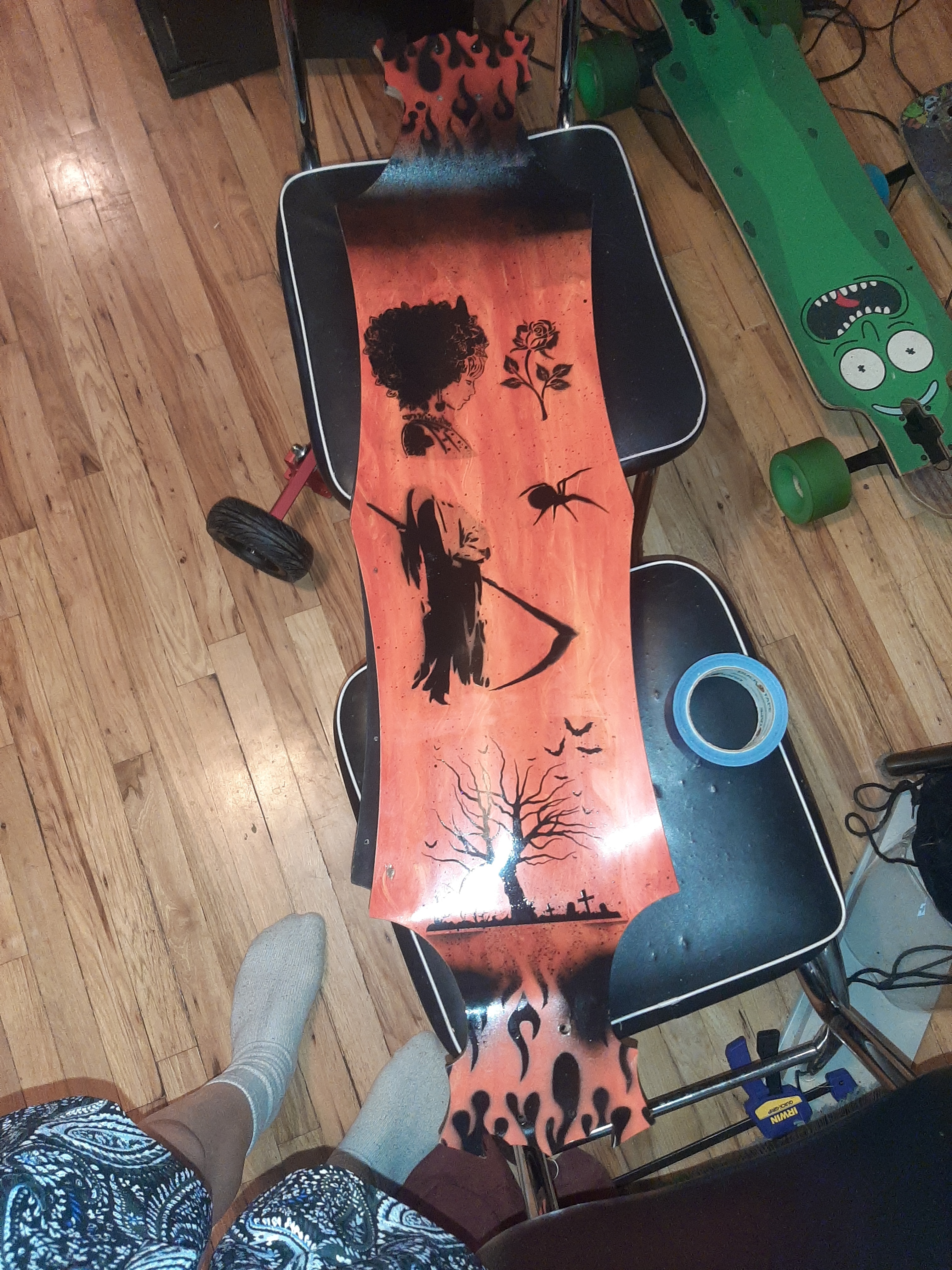

Getting this whole thing finally moving this week. Been spending some time painting the board to do some glass frit, then hopefully hooking it all up this weekend! Pics of the paint process!
looks like you got an airbrush beginner set hahahaha…nice flames though
peace
I got spray paint and stencils :yum: I’m pretty happy with how it turned out
ahh ok just the stencils ahhahaha, so you used a can to get this things on there.
Yeah, its sweet. Reminds me a bit of helloween stuff and things.
Is that a black widow?
Yeah, I’m no artist, picked out some fun spooky stencils and just taped em to the board and sprayed it down. I’m not sure if it’s a black widow but sure looks like it!
