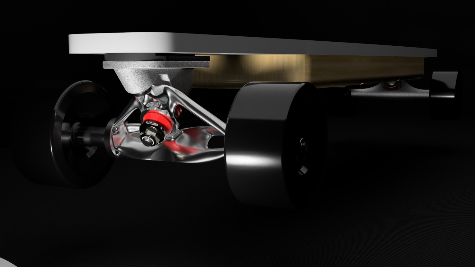

Here is the shape that the software came up with.
I then generated the toolpaths for machining it (I use Autdoesk Fusion 360) and machined it in a few stages. First on the CNC mill, and then turning the ends on my Dad’s manual lathe.
I soon realised this design had some pretty serious flaws. There wasn’t enough ground clearance, and I wasn’t happy with the load cases. I refined these, and came up wit a 5-axis version which ticked more boxes. A friend with a 5-axis machine offered to make it for me, which will be happening soon. Here are some pictures from the CAD.
This design has much better ground clearance, uses less material, and I think it looks more interesting.
I also prototyped the flange and kingpin design here. I’ll make the motor mount from 6061 plate, and the stub axles from 4140 steel.

Before I criticize you, I have to say this is really cool and I love what you are doing.
With that out of the way:
  1. Why not force the truck to be symmetric?
  2. Seems like you are letting the rake of the truck be whatever the computer wants…
  3. I doubt you’ll achieve something groundbreaking with your current constraints. You’re having it design an RKP truck hanger, and everyone knows what those look like. Making it more complex with all these additional holes / beams has no practical purpose from the looks of it. (Edit: I recall airplane manufacturers used generative design to decrease weight while remaining the same loads. I guess your truck might be a few grams lighter than other trucks, so that is actually useful.)
I think it would be better if you had the constraints of: mounts to board like this, has 2 ends for wheels, when you apply sideways pressure, it must turn. Then see what the computer comes up with! Maybe it will make a TKP truck, maybe a DKP one, maybe something that doesn’t exist! Now that would be cool! :smiley:
Cheers. I’m happy to share the Fusion design with you if you want to check out the loads and constraints. We are a bit limited with the constraint and load types in Fusion at the moment, but there are definitely ways to represent the scenario accurately enough to get meaningful results. I used the Fusion Generative Design environment. Surprisingly, it’s some of the most sophisticated Generative tech out at the moment, due to the advanced solves for manufacturing method and materials etc. You should have a look at what VW have been working on with Autodesk.
Good points.
  1. It’s assymetric because the loads are assymetric. I have a motor on one side only, so there is a torque on that side that is not present on the other side.
  2. The rake is set by the preserved regions at the connection points, so it’s as-designed.
  3. I did it mainly because I think it looks cool, but generative design will put the material in the most efficient places, so if I get the loads and constraints right, I can make the lightest possible truck, that will be strong enough, in theory.

Here are some examples of different results generated from different loading conditions.
1st, the standard hanger for reference
And here are some of the generative outcomes
Sure, no problem. PM me your email address. Would be great to get some discussion going on the loading conditions, and get you guys to critique my assumptions.
if they’re for hub motors remember to factor the torque
Great point! I mentioned an assymetric loading due to the torque above, but you’re absolutely correct, it’s not actually an additional torque on that side, but instead a force from the belt tension.
with a belt you’ll get much less torque but the motor mount itself still acts as a lever, applying some torque to the truck, though i haven’t calculated how much
Hmm… ok, that makes sense. I’ll go back and look at what I did there. I can’t actually remember how I loaded that flange.
That last one looks pretty visually appealing. Have you considered mirroring the motor mount for 2 motors? Most of us on here find one motor to be annoying to ride with a single motor because of torque steer, loss of traction, weak power, etc lol
I have to wonder how much that would change the generation too, having uneven loading conditions would obviously make it run differently
Wouldn’t the force of hitting a bump with a heavy motor attached to a long mount be way more than the torque could ever be?
