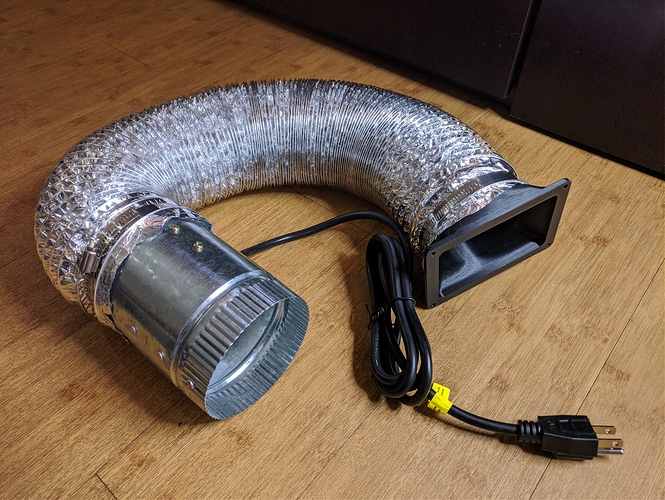

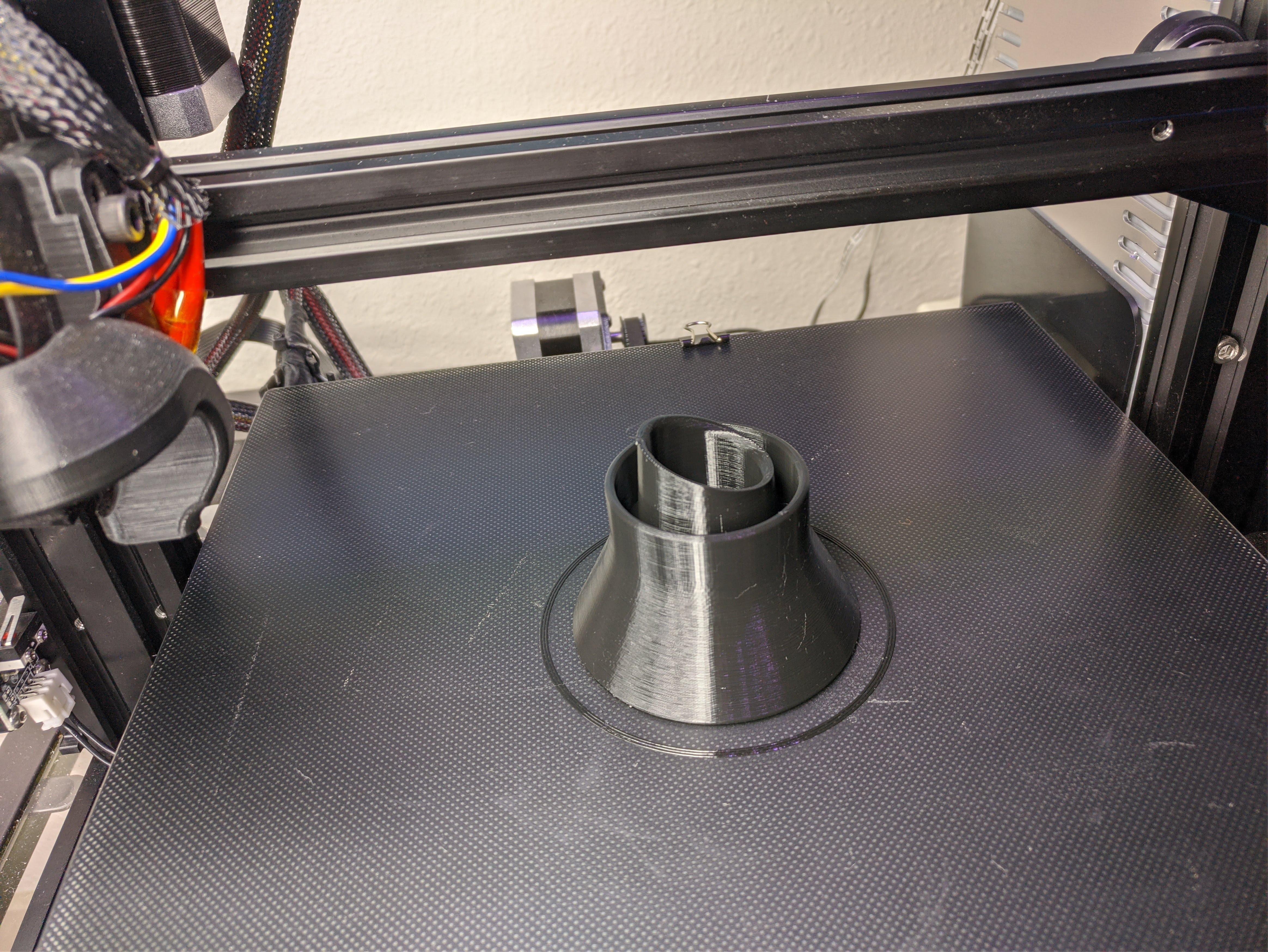

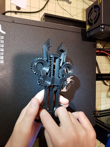

What are the second third and fifth photos?
Those are all parts I use on my sla printer I just got.
2nd picture is part of a ventilation system for it. Resin smells like shit and I live in a tiny city apartment.

3rd is a funnel that locks onto the resin bottles. It’s been the part I’m most thankful for lately.

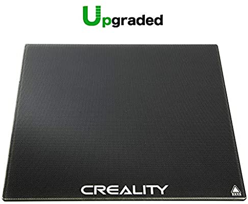

I upgraded the feeder to an all metal one, capricorn tube, and glass bed.
Bed

The glass bed helps a ton with bed leveling actually. Since it sits higher up the springs are tighter which makes the bed leveling for me usually only takes a minute or two…
