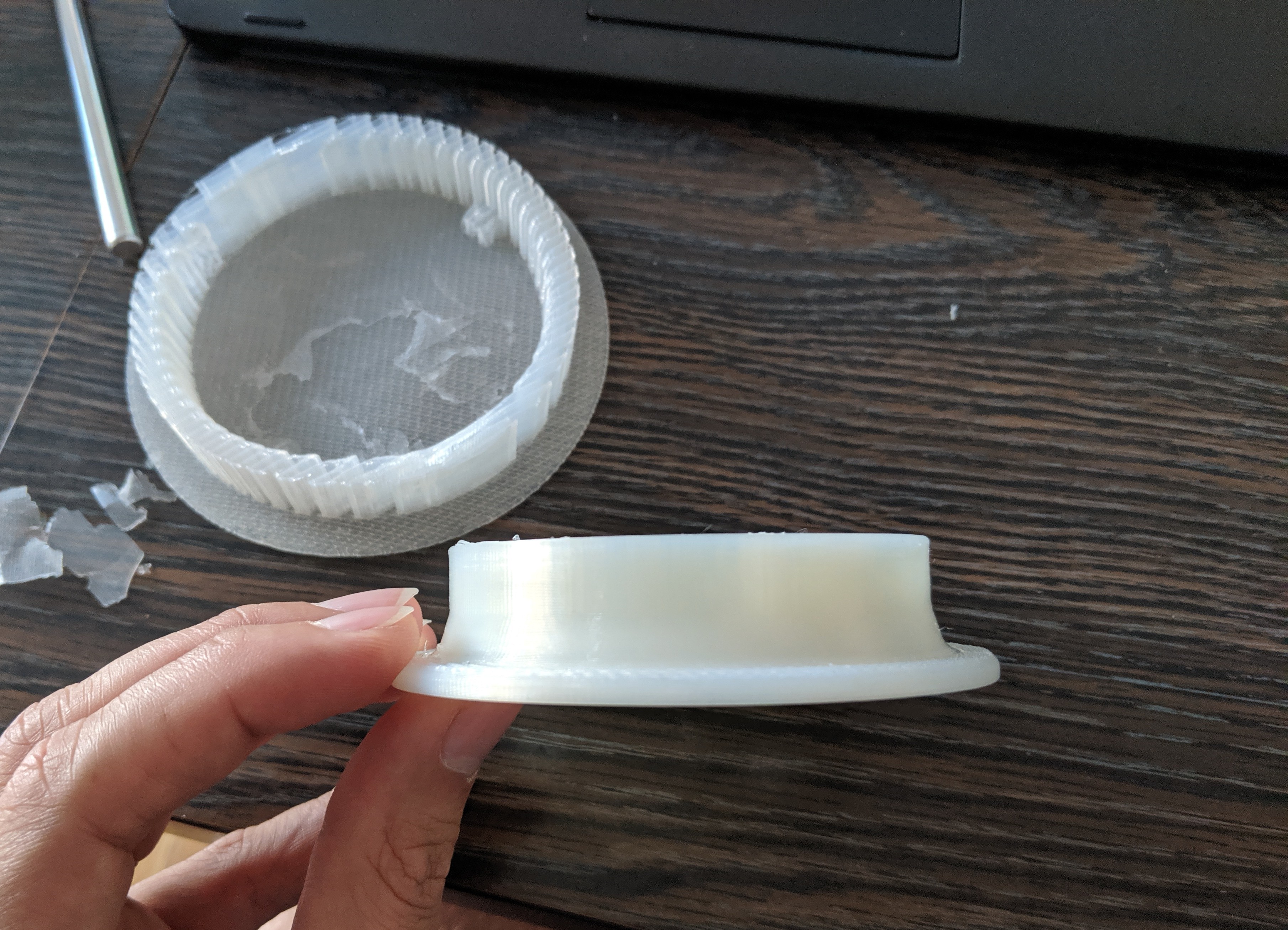

How are the brim and raft removed? I have to cut and sand?
i cut brim off with a exacto knife and I remember using them for NESE modules before I had an enclosure.
Raft should just break off. Just like supports.
I just peal it off some times little bit left behind I trim with a scalpel Easter then removing the object from the bed. Rafts don’t leave a very nice base so I avoid them or end up sanding
Umm, if the z gap is tuned properly and fan is blowing at 100% then it snaps off clean. I don’t see a reason to avoid it. Except that you waste a bit of plastic.
I especially use them while printing wheel hubs and gears because I get a perfectly flat surface and 0 warping or distortion.
It even works with nylon, which is hella sticky. I had no cooling fan so a bit got stuck. But you can see how clean the bottom is and no elephant’s foot. I always used to have that if I didn’t use raft.
