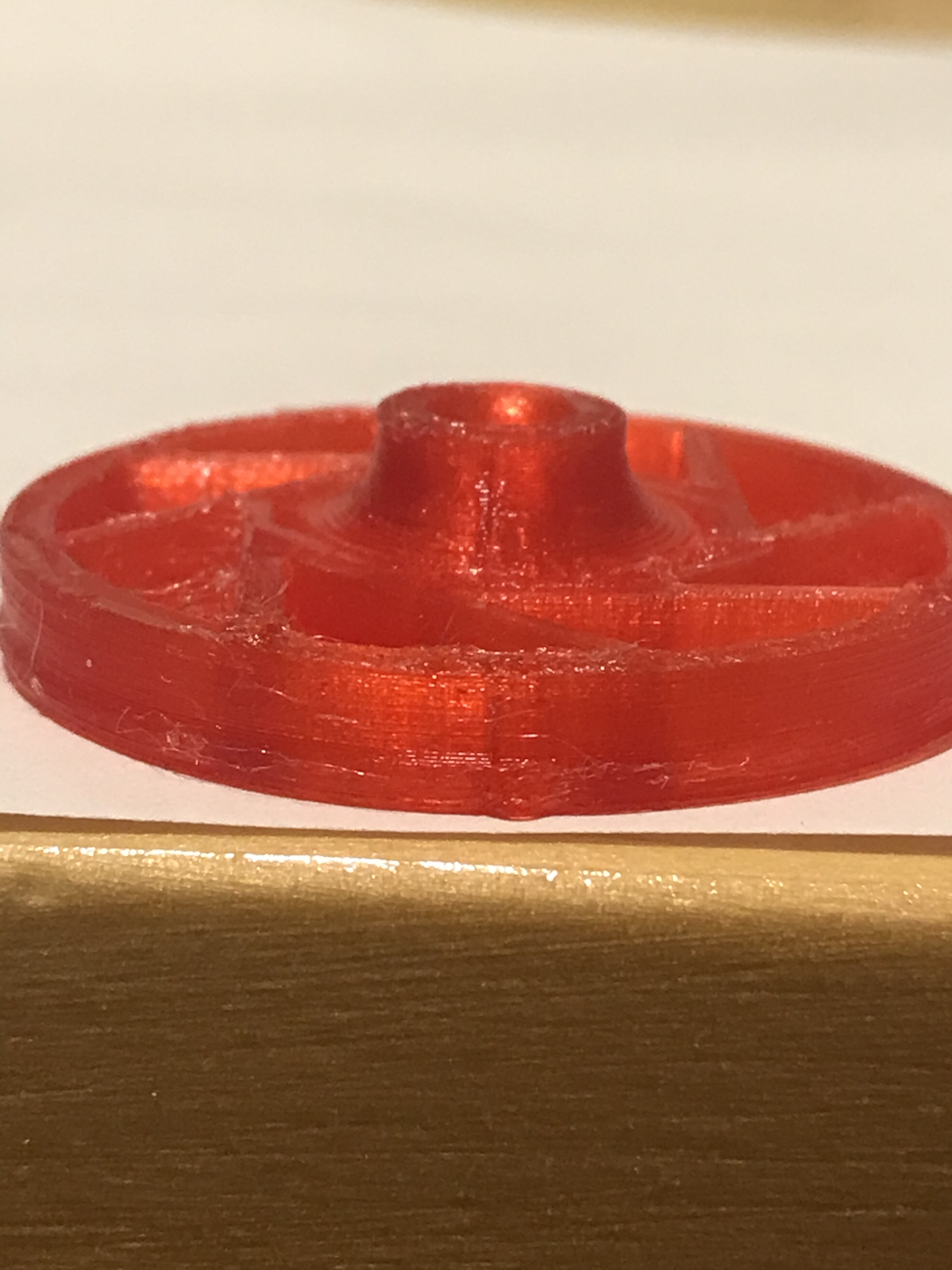

Looks like I need to change some seam settings as well.
What’s your layer height and nozzle temp? That seems too hot
PETG is hard without a direct drive and needs a lot of playing around to get the settings right.

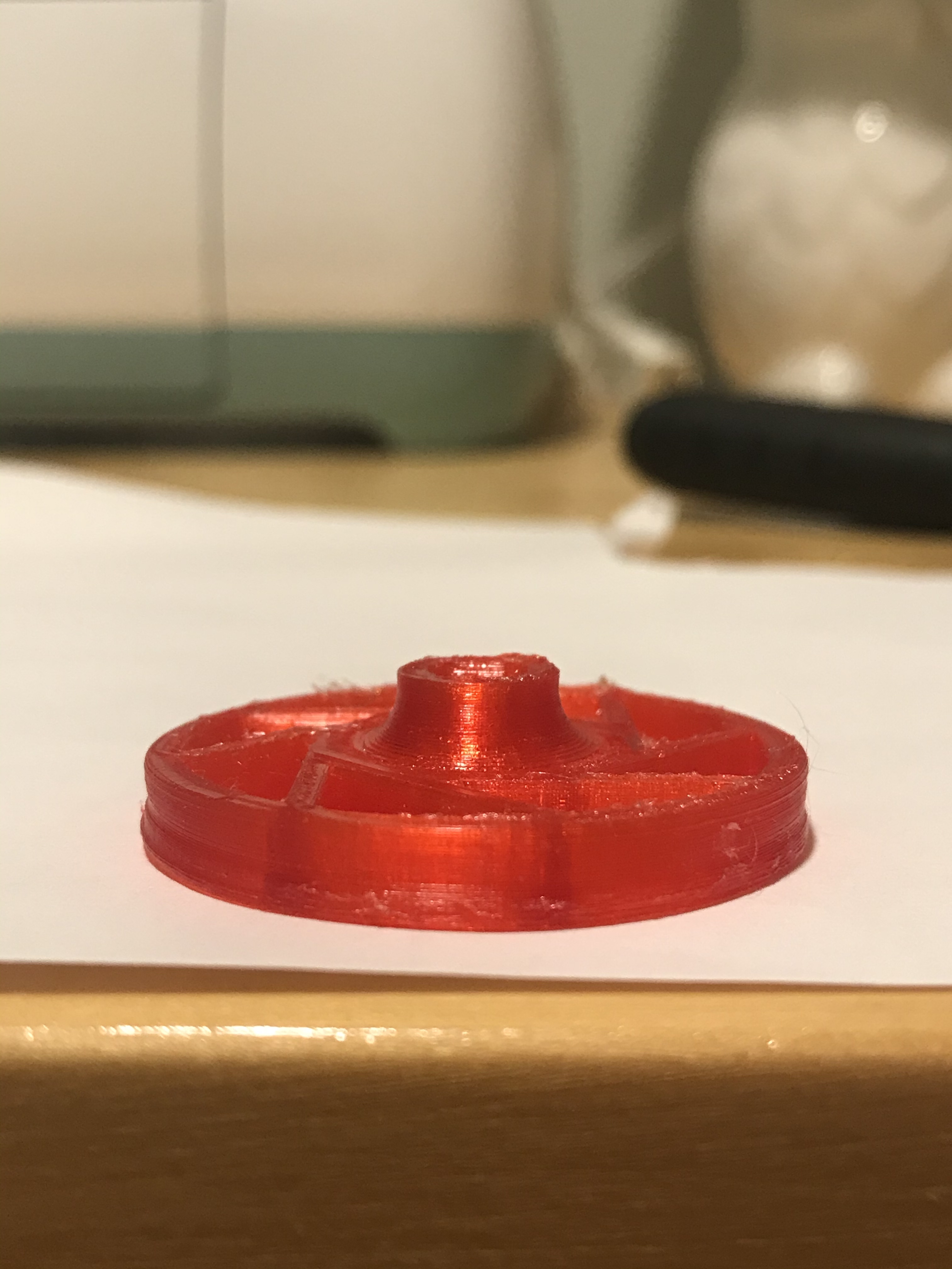

Looking at the print, I think you are over extruding. So either do a esteps calibration or just reduce the flow% a bit and see how the print looks. Also set the “outer wall wipe distance” to .2mm.
Whats your “retraction distance”? “Retraction speed” and “retraction print speed”?

I would reduce the retraction distance to 6mm max and increase the retraction speed to 40mm/sec. I don’t think you need the retraction prime amount. Just set it to 0.

What did you use to make the temp tower? But from the results it seems like it’s good starting from 230. BTW, any changes to retraction like I suggested or not yet?
BTW, I don’t see elephant foot, so that’s solved I guess?

Any idea how to get better accuracy? The little cones are off layer by layer
Unless you are making figurines you shouldn’t be concerned about accuracy of very small parts. The cones are really tiny and that’s why they can move around. If you want to print figurines, go for .8layer height.
