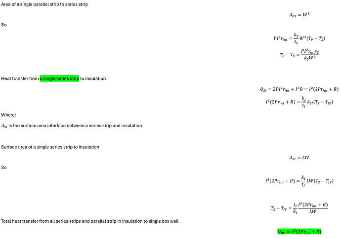

I’m surprised a generic formula hasn’t been developed yet. I’m getting closer, but the formula I’m getting is not producing good results.
Assume that there is no convection within the battery box (or that the thermal resistance of it is essentially zero), so the insulated strips is more or less in surface contact with the box walls and conduction between the cells, the strip, insulation, and the box. We will have to assume that the box is at the same as ambient temperature. We have to because convection of the box cannot be determined, it’s a function of temperature of the box. Regardless when doing this, the formula I get is not producing good values.
As you can see the results I’m getting are obviously not correct. So if anyone finds anything wrong, please let me know! In fact I actually hope someone finds something wrong.
I even consider if I have a P parallel packs and S series connections. So if I had like 5S3P pack for a power tool battery, I would have 6 series connections and 1 parallel connection in contact with the box wall. If I consider heat transfer from all 7 of these pieces, even then I don’t get good values for the current allowed through a strip.
Some of my analysis in those photos, are when I was trying to go down that path, and may no longer be relevant. But you can see how I get my formula. It’s just some of the values I don’t use.
The chart @b264 graciously bestowed and updates is pretty accurate based on my tests of nickel sheet / copper cable. Not sure its worth trying to re-invent the wheel.

That’s a bit closer probably, but does not take into consideration heat transfer from cells underneath it.
