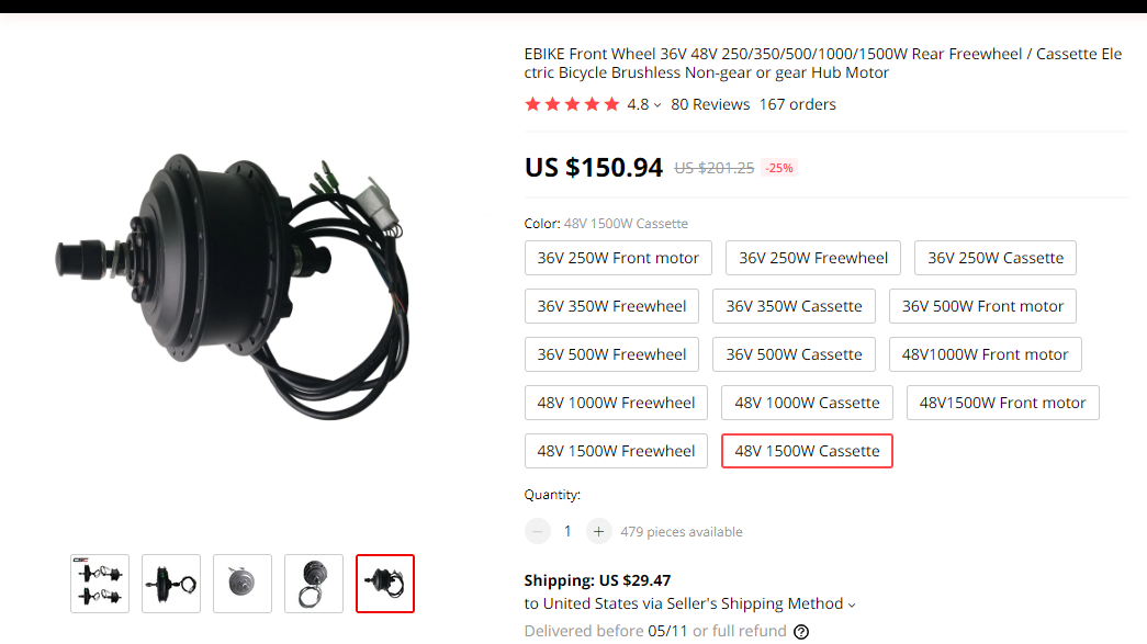

This listing has a bunch of options, which one were you referring to? I really want to build and ebike at some point. Maybe an emotorcycle.
48v is common for companies because 50v and up is considered Very high voltage and comes with safety regulations
Totaly! I guess what i mean is due to the extra room for weight, volume, and less requirements on functionality, a scooter might be better served with a simpler esc. Thats also true for my ebike adventures so who knows
The last one :grin:
