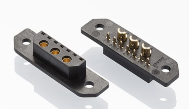

So was looking around for ideas for motor sender cable connectors as iv still not found any I’m content with yet and was trying to get more spec on AMASS MPX 6 connector
(tho I’m starting to think is not AMASS product at all)
I came across these

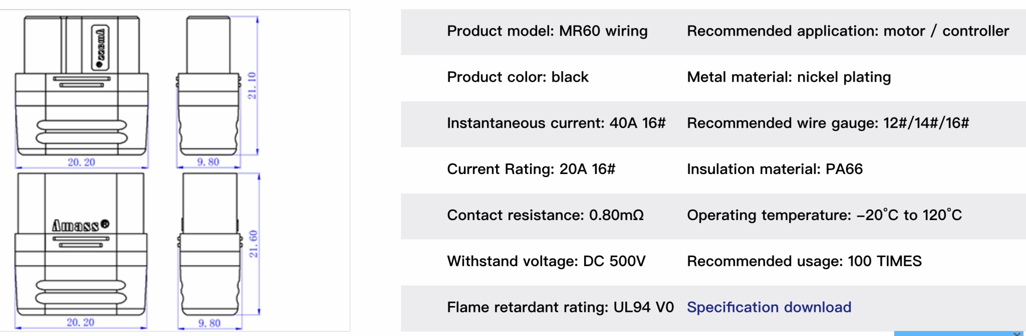

https://translate.google.com/translate?sl=auto&tl=en&u=http%3A%2F%2Fwww.china-amass.com%2Fproduct%2Fcontain%2Fiy1675471075p9H8
It almost has the same spec as the MR60
https://translate.google.com/translate?sl=auto&tl=en&u=http%3A%2F%2Fwww.china-amass.com%2Fproduct%2Fcontain%2F01G5do45298528b9
The only difference is the MR60 takes a cable 1 AWG size bigger
I came across these a while ago, but never found where to buy them

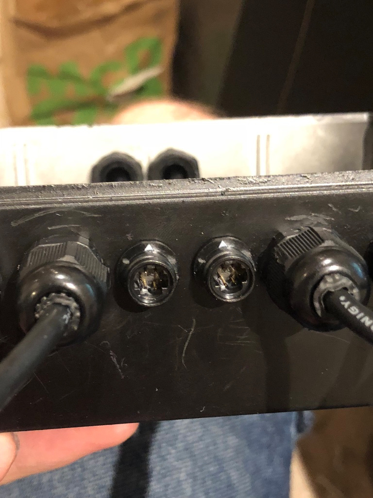

GX12 are good solid connector but I was looking for some thing better
https://www.amazon.co.uk/Aviation-Connector-Ltsstoreuk-Circular-Waterproof-Black/dp/B07GBFHTZJ

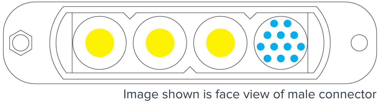

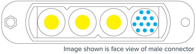

https://www.binder-connector.com/se-en/snap-in-circular-connector-ip67/?gclid=Cj0KCQiA7aPyBRChARIsAJfWCgIGNm40tpeZeKTUcL0imzIzQC4n0fvblsS9jFDvwlQAT-z1ISVrZ5QaAsHZEALw_wcB
Interesting connector. Can do upto 200a. Company is based in France.
Custom Minimum order is 25 units
Group buy? Dibs on minimum 6/8 :slight_smile:
Same, I’ll take 8
One more for 9 and we are home xD
this seems painful to solder to :open_mouth:
Send a quote about custom connectors, will see how much it will cost :stuck_out_tongue:
Unfortunately GG series are waaaaay too big :frowning:
Lol, thats awesome… but they are 0awg connectors :sweat_smile:
