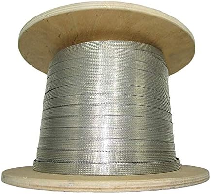

This is what you want. 6AWG equivalent.
Or this for smaller applications. 12AWG equivalent.
Wow, what are feet feet? They only sell those in rolls of five feet feet (5’ FT) through one hundred feet feet (100’ FT)
Curious, that 1/2" braid says it’s 10AWG which would be half the rating in the chart above. @BenjaminF do you think the chart should be amended? Or that maybe this is just a really thin 1/2" wide braid?
