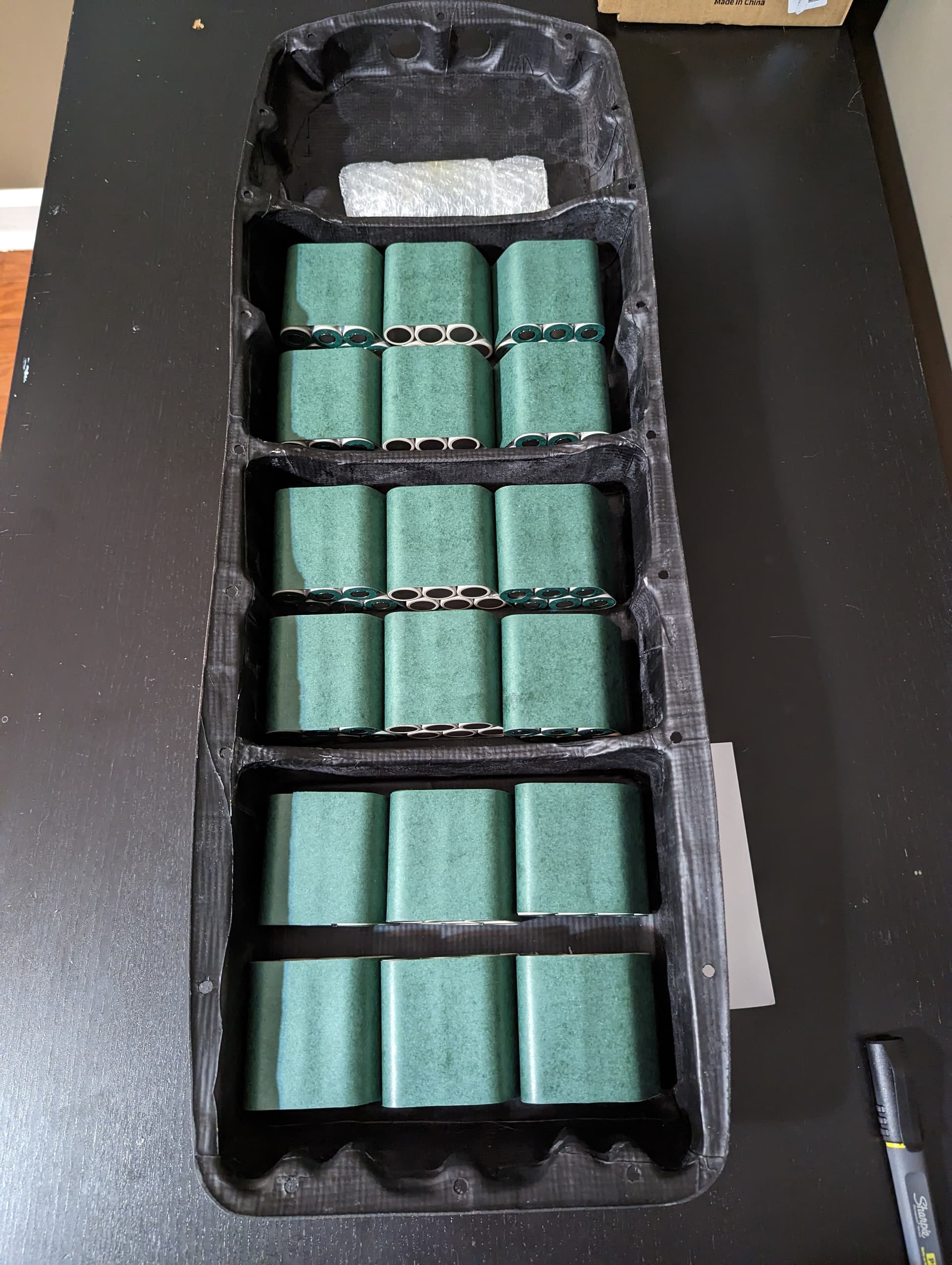

So that realistically would be more power less range?
Same power, same range.
Possibly less heat thou.
Interesting, my brain doesn’t understand the concept there. How does that work?
With the same amount of cells → more volts, less amps → same power.
The same cell number will put out the same power, regardless of series/parallel config.
Delivering the same power with less amps and more volts → less heat.
Since heat loss across a conductor is proportional to the square of the current, so x2 current is x4 heat, x10 current is x100 heat etc; there’s a potential benefit in keeping current lower.

Still trying to figure out a bms, charger, charge port and I’m sure plenty of other things.
Will probably get around to soldering in the next few days, still need to source a BMS.
Lookin good bro but you missed out not grabbing a @tomiboi deck. Top shelf shit right there.
Gonna be a beast of a battery!!
Yeah tbh I went back and forth with the idea of what deck to grab and I do like both options, so I just went with the cheaper/faster option.
Currently learning how to solder, so I can finish the battery LOL. Also why does no one sell a smart bms for 18s in the states.
Put extra care into your iron prep and tip maintenance. Learned this the hard way.
what is considered iron prep? Tip maintenance I understand for the most part.
