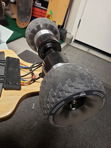

Anybody know offhand if the 120mm foamies fit the Carvon V4TD-XL with abec adapter? I know it’s abec but does it actually fit properly. :yum:
Is there anybody in NYC with a set…?
foamies are clone core not Abec if that helps. slop with the haggy press fit but they go in at least.
Yes, they do. :+1:t3: Although you may need a little heat shrink on the prongs for a nice snug fit.

The XL’s have been pretty great for me. Although I don’t have a huge amount of miles on them, but so far, so good. The motors do heat up if you’re a bit aggressive with the throttle or do lots of starts and stops, and will hit the thermal throttling limit sometimes, but that’s about the only issue. Sad that Carvon went the way of the dodo bird, cause they had some solid products. And as @BillGordon said, foamies over 107s all day especially on rough or uneven surfaces. They just soak up so many bumps and imperfections and still somehow have really good grip despite the smaller contact patch.
