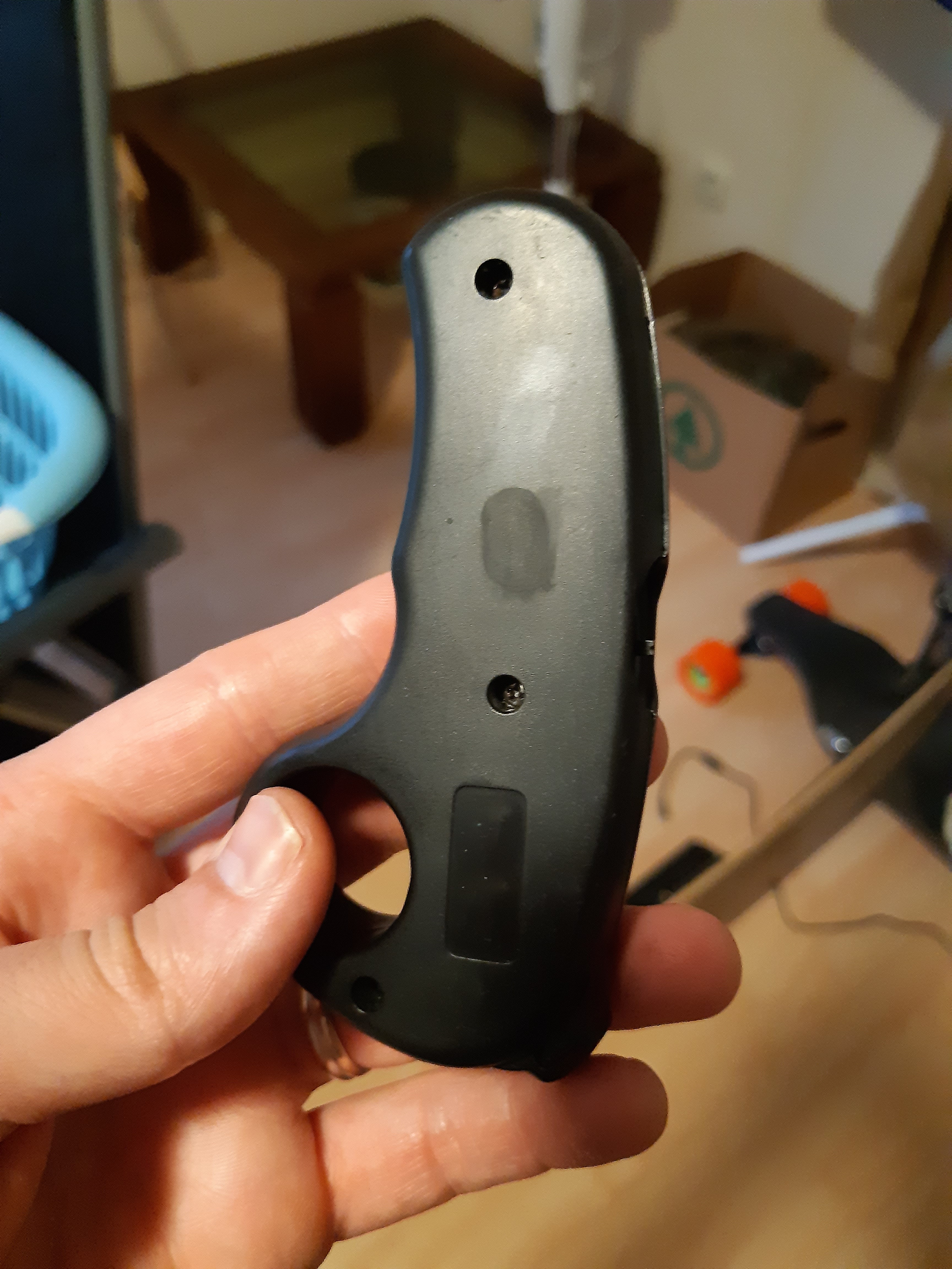

No visual affect on the core piece that I took out with a chisel.
I wanted to find something that had an reaction so I started putting drops on everything. Turns out my remote had a reaction.

So its definitely not ABS if the acetone did not liquify the plastic chip.
The manufacturer says it’s polycarbonate (PC) which would be the right choice.
The Acetone test demonstrates that the factory did not accidentally substitute ABS.
So the other possibility is tha some were poured with a poor quality PC or they were molded at the wrong temperature.
