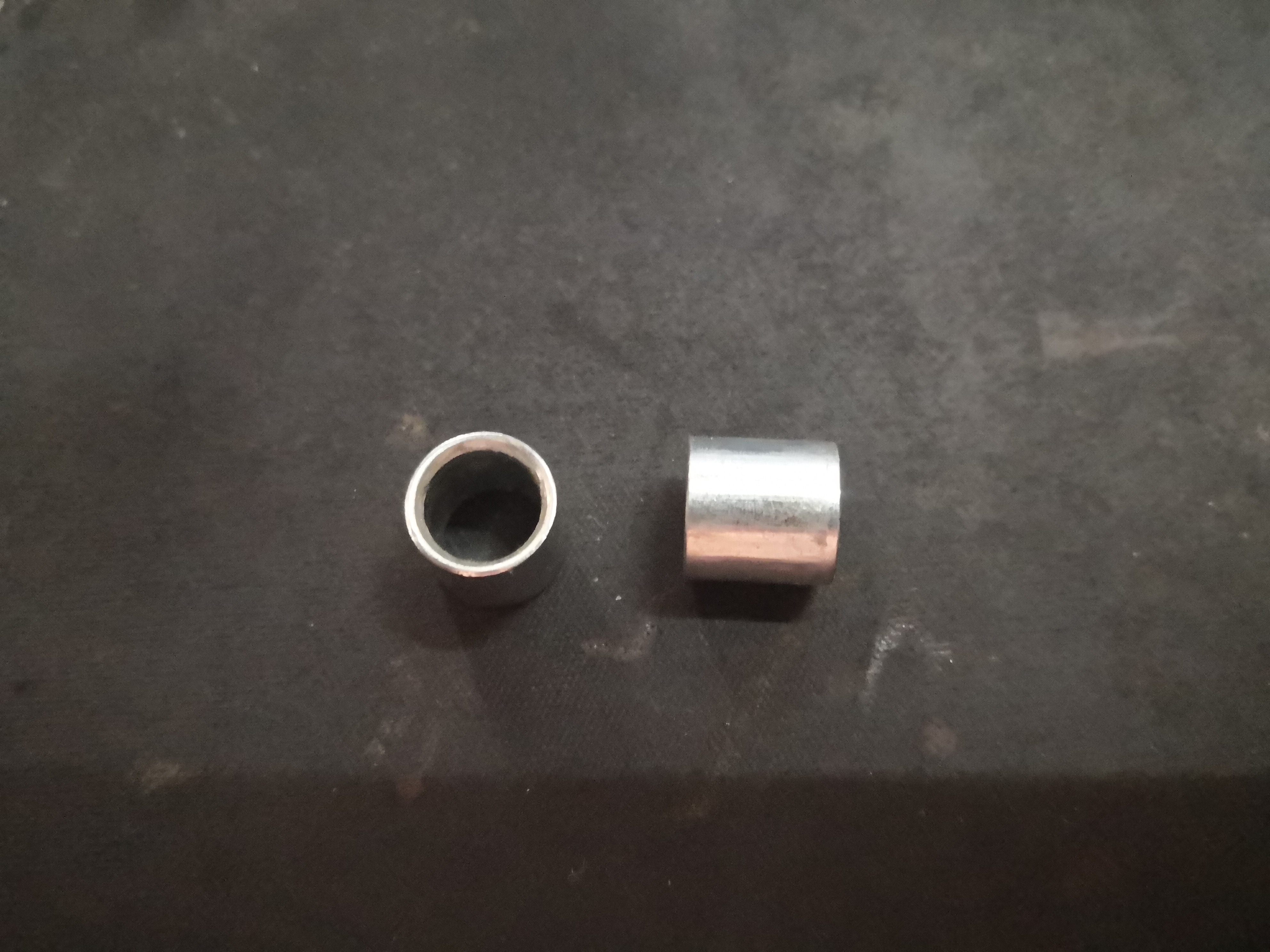

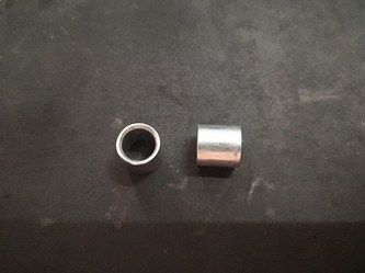

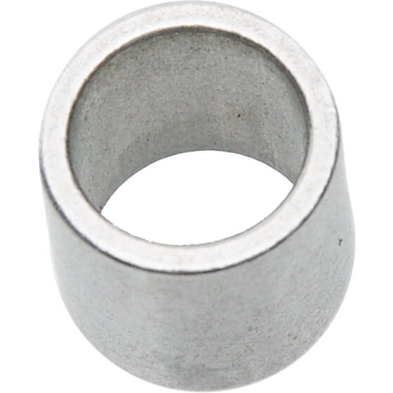

No, that’s part of the core. We’re talking about the little metal bastards that keep your bearings in place and hop out of the wheel and hide when you’re swapping bearings.
this is what it looks like

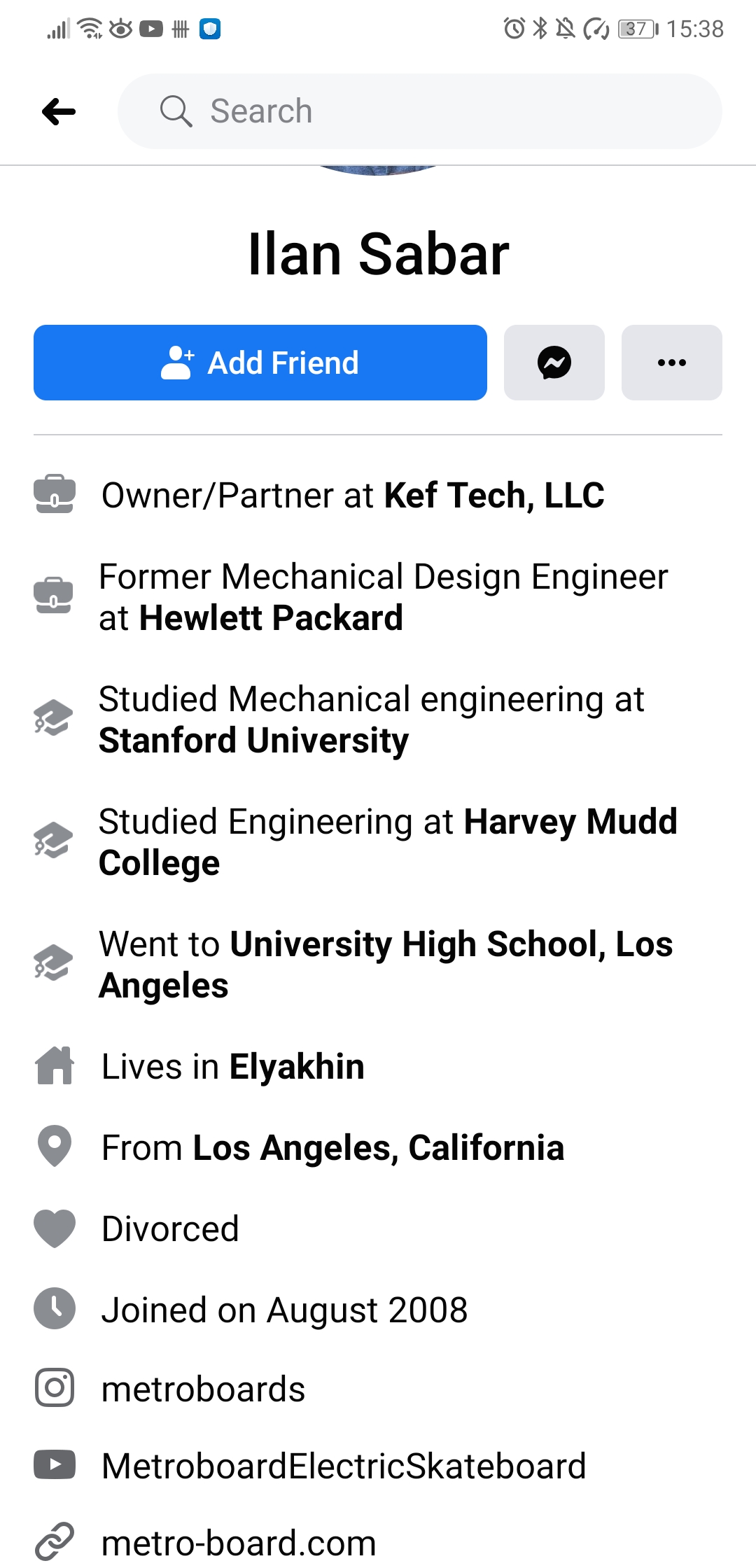

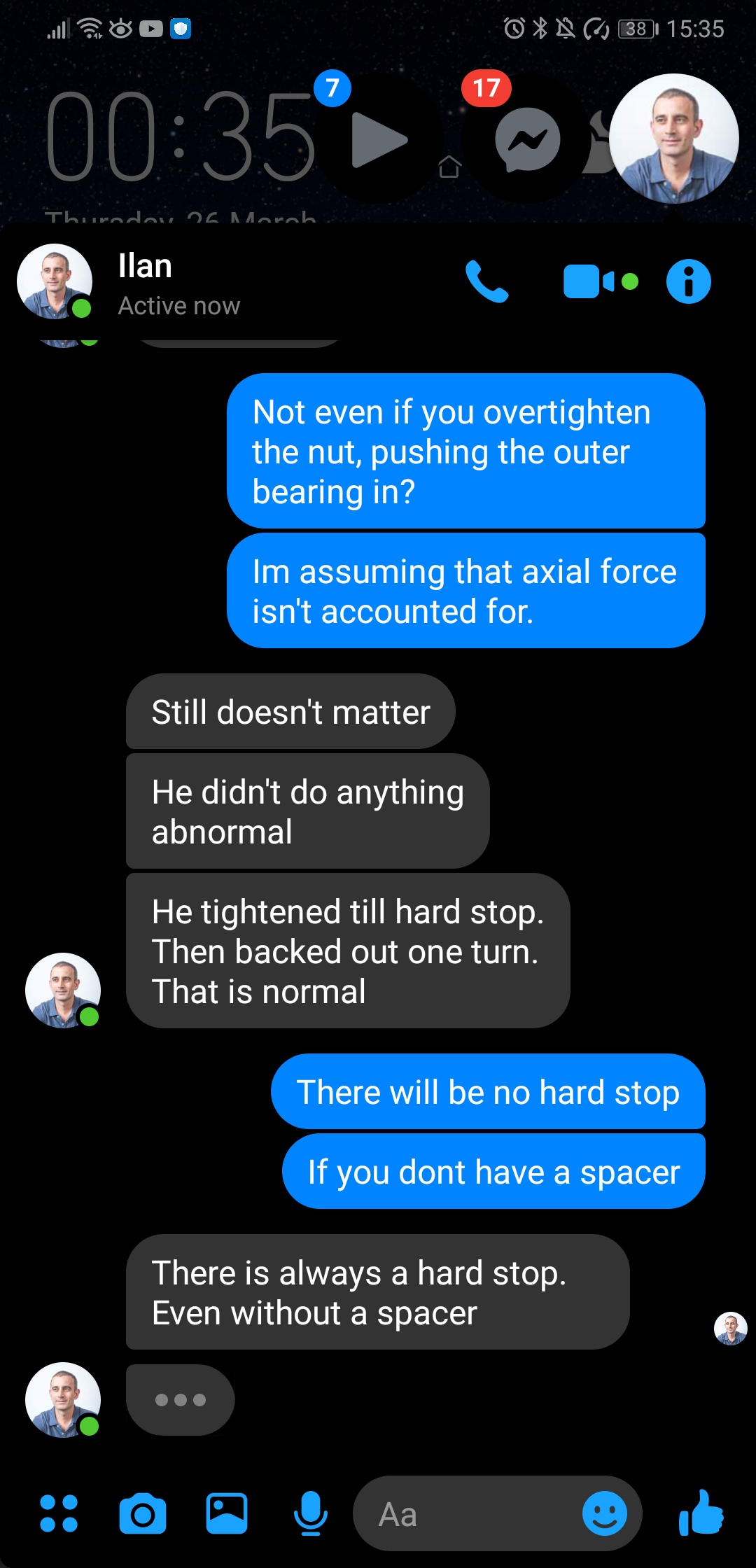

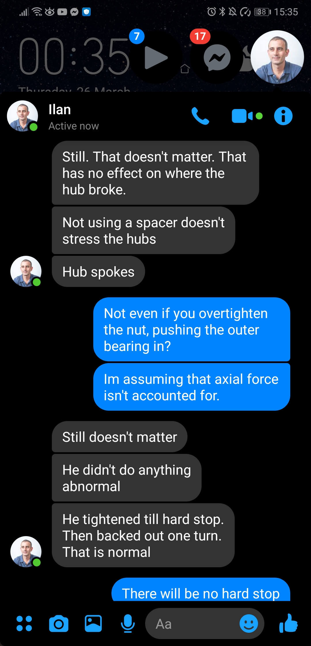

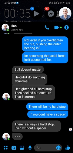

You know, metroboards doesnt seem to think they are of any use. I don’t understand this. I messaged him because I thought it was premature of him to post that without an investigation into this matter. When asked whether the lack of a spacer could’ve caused it, the above was his response.
Edit: WTF?

I know what myself and everyone I’ve done downhill with over the years believe. Spacers and speed rings matter.

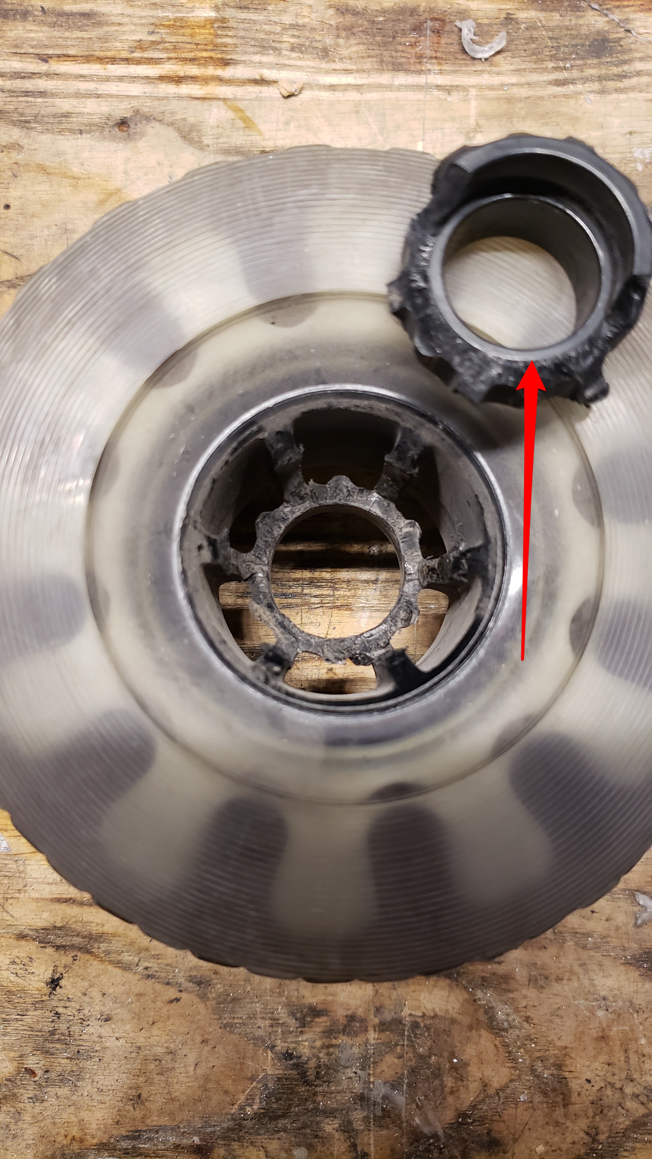

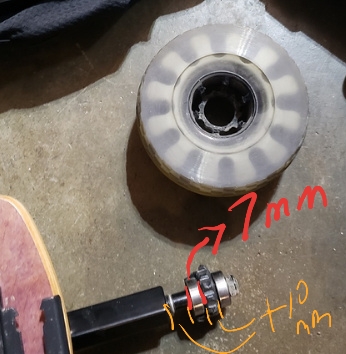

Wheel installed without spacer, nut was not tightened properly due to lack of compression, vibration cause nut to come loose, one bearing slipped out to edge of core, angular stress cracked core shell at the lip, rest of core failed catastrophically.
Inspect close up of where the nut is. Was not loosened by sliding on the ground, its on the right hand side. Gap much bigger than 10mm spacer allow with 608 7mm wide bearing as reference.
20200326_004717
Tl;DR no spacer, nut come loose, bearing come out, shell break. Cry on FB.

Also mechanical engineer thinks that you will get hard stop while cranking on bearings seated in plastic? Has he calculated the compression force of a 5/16-24 nut compressing onto a 2mm thick, 8mm diameter nylon lip?
No? This is why I don’t by HP products.

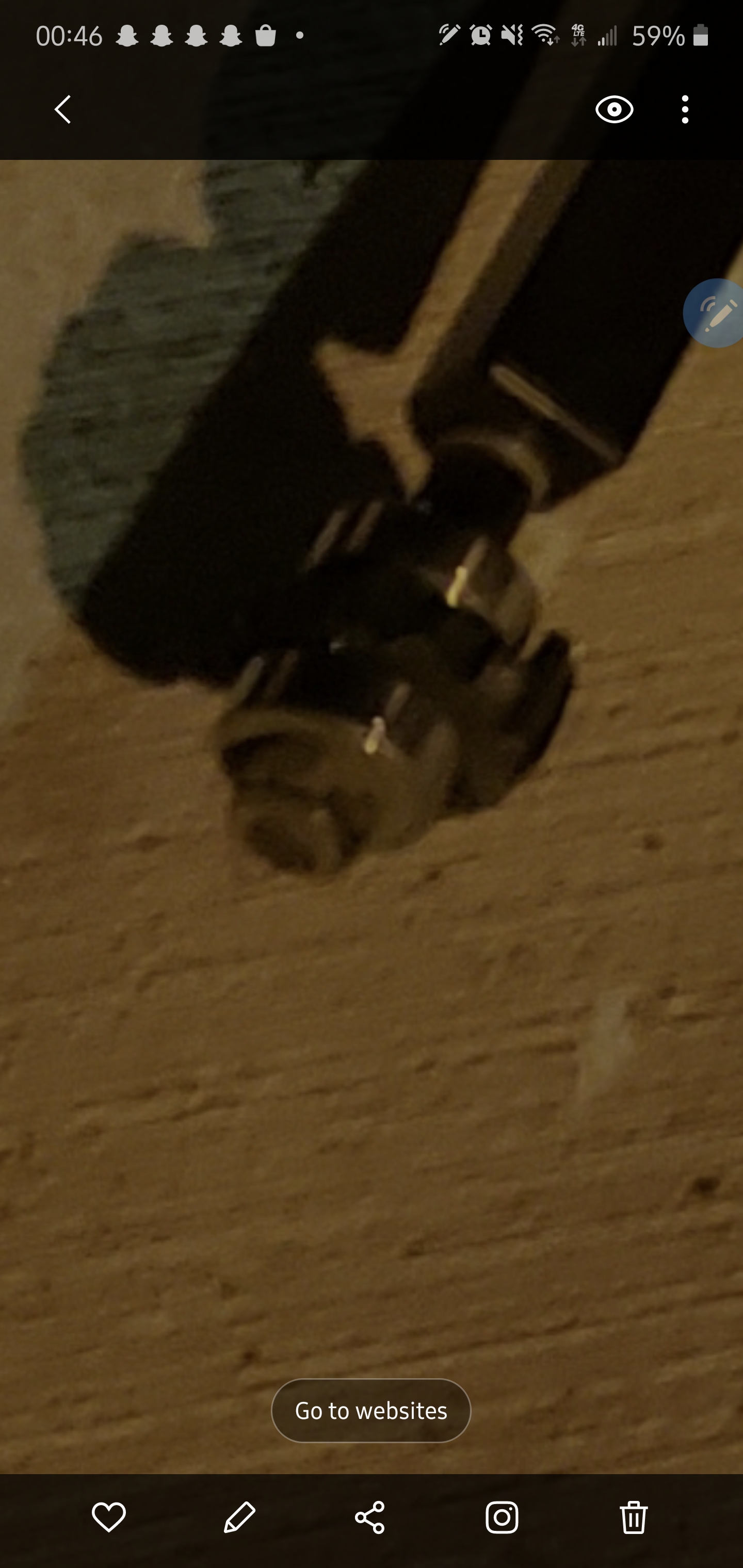

I hope he sees the picture of that nut almost bout to fall off the axle. He posted the failure reason right there lol.
I tried telling him otherwise.
Yes there will be a hard stop, when your core is complete crushed by overtightening. Good lord. I’m sorry but please return that degree in mechE.
