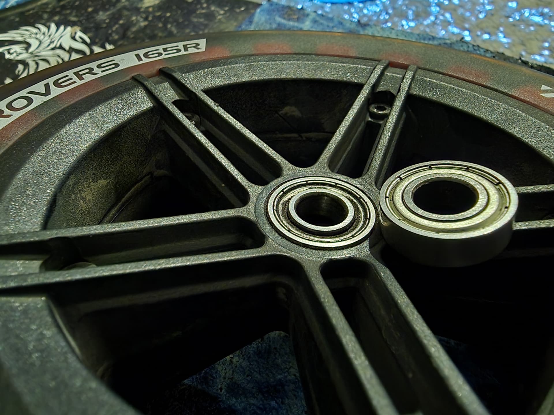

My one only issue with these wheels was discovered when i rotated my tires at 125 miles. I observed my Metroboard rear outer bearing were starting to collapse significantly. I had a discussion with a friend. He felt that with such a large difference in a larger will and a smaller 22mm bearing, the forces on the smaller bearing from aggressive carving and cornering could be stressing out the bearings. He personally had issues with something similar when he had a set of 22mm bearing blow out on him with larger AT wheels. The collapsing bearings were more obvious on both rear trucks and slightly apparent on the front.
I did have spacers inside the wheel, but one issue i encountered was that the wheel pulley has these cavities on the outer side of them where it would look like another bearing would fit in. But a 22mm bearing is too smaller while a 28 mm bearing is too damn big. Its worth mentioning that the flipsky trucks i use are not step down axles. Its 10mm through out on the axle. And so i learned that the bearings from the side of the wheel that presses against the wheel pulley would slip into this cavity after a ride. I emailed Iwonder about the purpose of this cavity. Idk if its bc of a language barrier or what, but they just couldnt answer my question. Or they also had no idea why they put it there.
I addressed this issues by adding an extra bearing to act as a spacer. However the bearing was not wide enough to keep it from slipping bc the bearing from the wheel would slip out by about 4mm. I got a lil lazy and didnt feel like dealing with it and left it as is.
I emailed Iwonder about this and told them what i learned. They recommend i use their bearings which are the 22mm OD and 8mm ID bearings. I dont have trucks with 8mm axles that can use these wheels. And so i concludee my tests at 125 miles.
So could have the damaged bearings be related to the design or me not properly addressing this? Could be both since the front bearings showed signs of damage as well. Not as significant as the rear but its still there. Tell me your thoughts.
