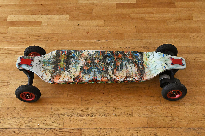

First build: Clandestino I
Clandestino I
Components
  • Deck: Landyachtz Evo 40
  • Trucks: Kahua from @haggyboard.timo
  • Baseplates: Kahua from @haggyboard.timo in the back and Hammock adjustable baseplate from @rey8801 in the front
  • Drive: Mini 1:4 helical gear drive from @NoWind (E-Toxx)
  • Motors: 2 x 6376 160 KV 3800 W from @Trampa
  • Wheels: 150 mm Bergmeister pneumatics from @haggyboard.timo
  • Battery: 12S3P P42A Molicel from @tinp123
  • Enclosure: Double stack from @eBoosted
  • VESC: 2 x MK IV from @Trampa
  • Connectivity module: NRF51 V1.0 wireless dongle from @Trampa to connect to the VESC app on Android and the Wand remote
  • Remote: Wand from @Trampa
  • Heatsink: VESC6 plate from @3DServisas
  • Brackets: FatBoy X Plate Longboard Trucks Braket from @3DServisas

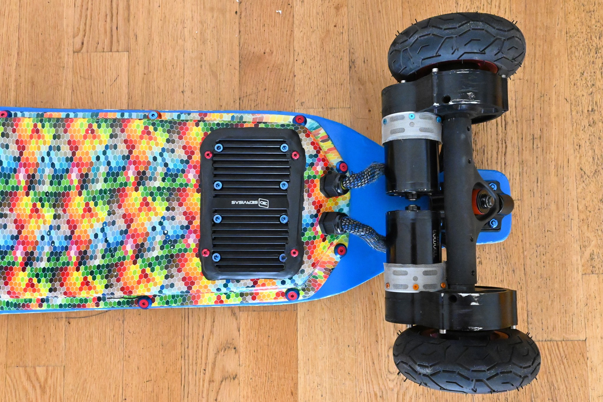

Details of the build

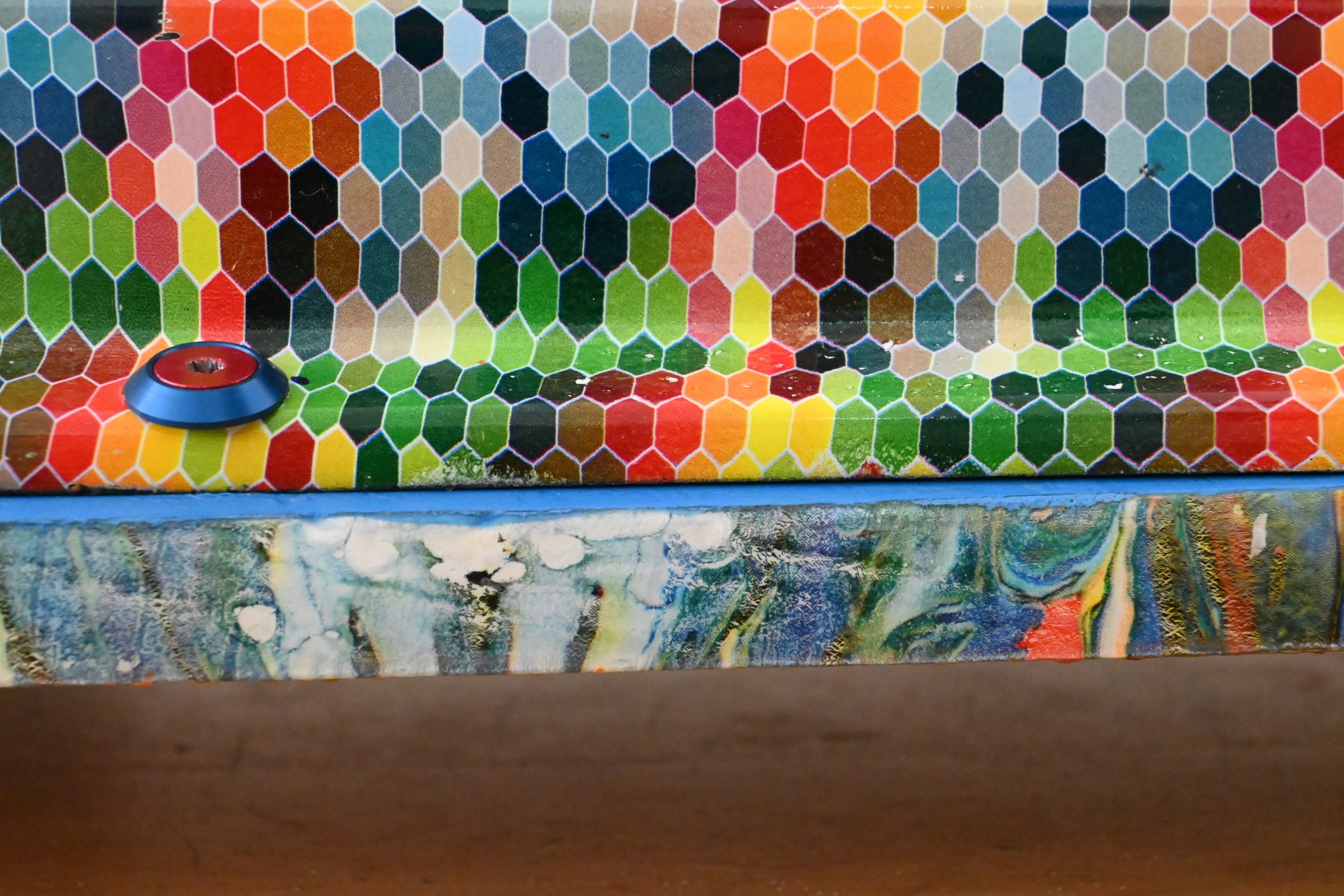

Hydro dipping the board and the enclosure
First, I hydro dipped the deck and added glass frit followed by the enclosure (first hydro dip that actually worked!).
Mounting the enclosure
Although this excellent tutorial here helped me a lot, I was still a little afraid of this step, and therefore decided to first test it on a nearby Landyachtz Evo 36 :stuck_out_tongue_winking_eye:. Using duct tape I secured the enclosure in the middle of the board and then started drilling with a 3 mm drill to mark the deck. I then took the enclosure off the board and increased the drill size step by step from 3 up to 8 mm on the deck and 10 mm on the enclosure, respectively, on the initially drilled holes as described in Pavel’s tutorial mentioned above.
It worked fairly well on the Evo 36 deck so I switch to the real thing using the same technique.
Small insert holes
Final size of insert holes
clandestino1_-6
clandestino1_-7
I used Rampa socket type SK M5 10 mm as inserts which could fortunately be drilled in fairly easily.
First alignment of the enclosure to the board looked promising.
Next, I followed the enclosure’s shape outlined by the inserts with a sticky rubber band, cutting it away from or around the inserts (first with nail scissors which proved more or less impossible and then with a scapel which proved slightly more successful).
Attaching cable glands (IP68) to the enclosure
This was rather straight forward. I simply drilled holes with successively increasing the drill size from 4 to 10 mm (similar as for drilling the holes in the enclosure) and then used a file until the correct diameter for the glands was reached.
However, I made a big mistake in drilling the holes for the cable glands too far away from the deck in an upward position on the enclosure resulting in an unnecessary tight space and steep angle of the motor cables - something I only realized when I got the drive with the motors mounted, of course, and was actually standing on the deck to get a first feel for it. Although I could eventually compensate this with cable binders it would have been much better had I given this issue more thought initially or simpy looked more carefully at the tons of other Evo builds out there!
Attaching the heatsink to the enclosure and mounting the MK IV VESCs onto it
Before cutting with a dremel I made a template that was a little smaller than the heat sink from 4 pieces of paper and then drew an outline of that template on the enclosure (in the shadow in the picture below).
I then spend a long time with a file to get the perfect cut and failed miserably. Again, I found it very difficult to file a straight and not a somewhat angled line.
Next, I added some adhesive foam around the edges inside the eclosure.
After inserting the heat sink and attaching it to the enclosure, I sealed off the edges of the cutted hole with lots of sugru before attaching the MK IV VESCs.

Because of particular shape of the Evo deck, I thought that I would have to use adjustable baseplates to set the angle of the axles/trucks correctly, and Alessio was so kind to send me some of his Hammocks. It turned out, however, that the motors were too big and hitting the baseplate in the middle (see video below). Once again doing justice to my noobie background, this was something that I only realized when I finally got the trucks mounted and was actually standing on the deck. Thus, in the back I changed back to the Kahua baseplates, but kept the adjustable Hammocks in the front.

Thanks to @tinp123 and Dave from Trampa connecting all things electronic inside the enclosure and to the MK IV VESCs in particular was a piece of cake. Labelled photos below on how to connect the power button to the VESCs are a courtesy of Dave.
This is how it looked like in my case:
As you can see in above pictures, I almost fucked up big time again by placing the power switch not in the back but much too far in front of the enclosure. Luckily, the 12S3P double stack battery still fitted just a few millimeters in front of that protuding power switch and I was thus able to close the enclosure - it just took me about 1 hour or so and I was kneeling on it to align with the threaded inserts.
Before that though I thought it could not be wrong to run motor detection. Here’s what I got and a first test.
As already mentioned above, kneeling on the enclosure and repeated tightening of the screws then resulted in good fit of the enclosure to the deck leaving almost no gap between the two.

Wow @hans_maier :star_struck: super sweet build :call_me_hand:
Thanks a lot for all your help along the way! :partying_face:
That looks sooooo sweet! Very clean build bro! Great documentation too!
so colourful, love it
I don’t really know what I’m looking at but whatever it is, its probably one of the coolest first build evos. Also excellent documentation. I love ALL of it. I do recommend adding a layer of epoxy on top of that sugru because sugru is decent for sealing but not the best as far as adhesives go. But again, everything is gorgeous :heart_eyes:
Good idea, thanks a lot!
