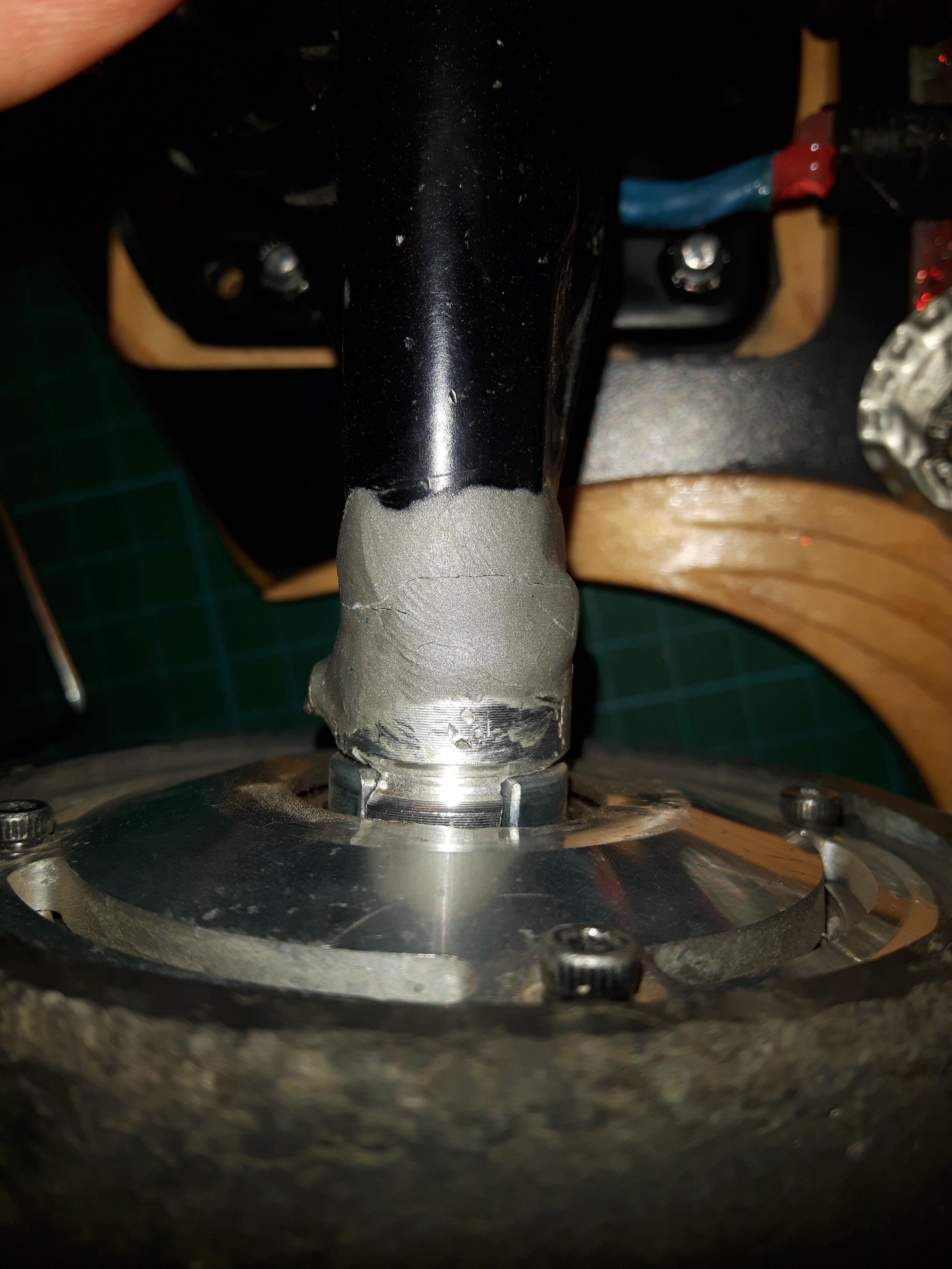

While checking out my board aftee the ride i recognized a small crack in rhe JB weld i applied into some small gaps between truck and motormount.
I have 3 ideas whats going on here.
First is I already bend the axle oder second it cracked bc of vibration and different material thickness or third I fucked up the mixery of the components.
Report back: :ninja:
ON my 4rth test ride a few minutes ago, with no issues or any problems on the hardware, I reached round about 35km range while going a standard bike lane and about 10 times the same small but steep hills up. My ride took 120 minutes almost non stop riding ( did a few stops for carefully checking out my board for sure).
Had a special eye on the cracked epoxy, but the crack is still same size like before and holds up, so nothing to worry about im sure. The trucks are tooooo weak anyways :ninja:

West System 650 mixed with System Three milled glass fiber – and coated with straight WS650 while still tacky after 3 - 4 hours
is the strongest I’ve found

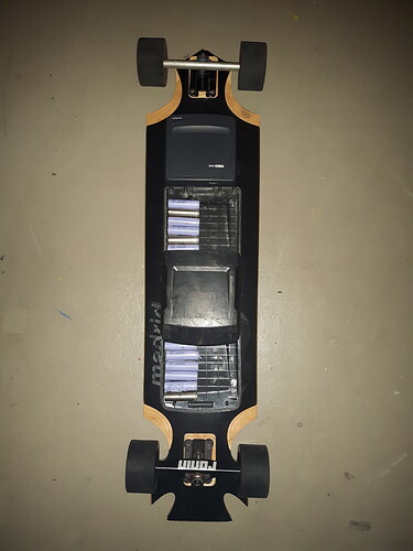

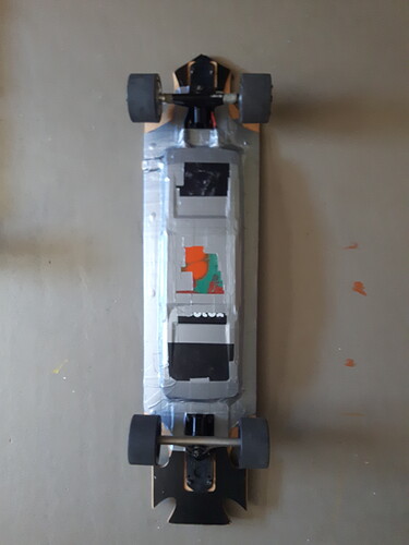

I shortened the WB on the Anvil and prepared for a new GF mold…
WB now
WB Original
Added a wedge for nice tail feeling
them LW hubs ( will mod them after testing)

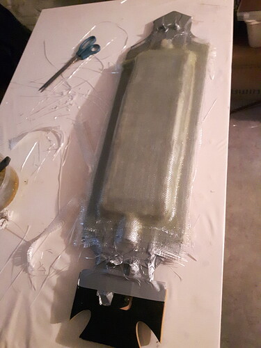

After staring holes in the air for days, or letz say weeks, i finally managed to throw the GF onto the prepared piece I would like to call a murder lightning killer board one day.
Heres the process:
FG applied directly onto the duck taped mold :joy: Hope this piece will come off later on…looks goooooooooooood so far imo… :rainbow:

It will come off i bet!
That would be good news, bro.
I did it on clear tape, came off very well so maybe you will take some tape with you, but i bet you can peel/ scrape it off.
Clear packaging tape releases very well.
Yeah, I had this clear tape at hand for the first try, but Im always greedy on things like that and use what I have at hand.
First I wanted to wrap the whole thing up into foil but that seemed like a tent and didnt wanted to shrink the way I wanted :joy:
