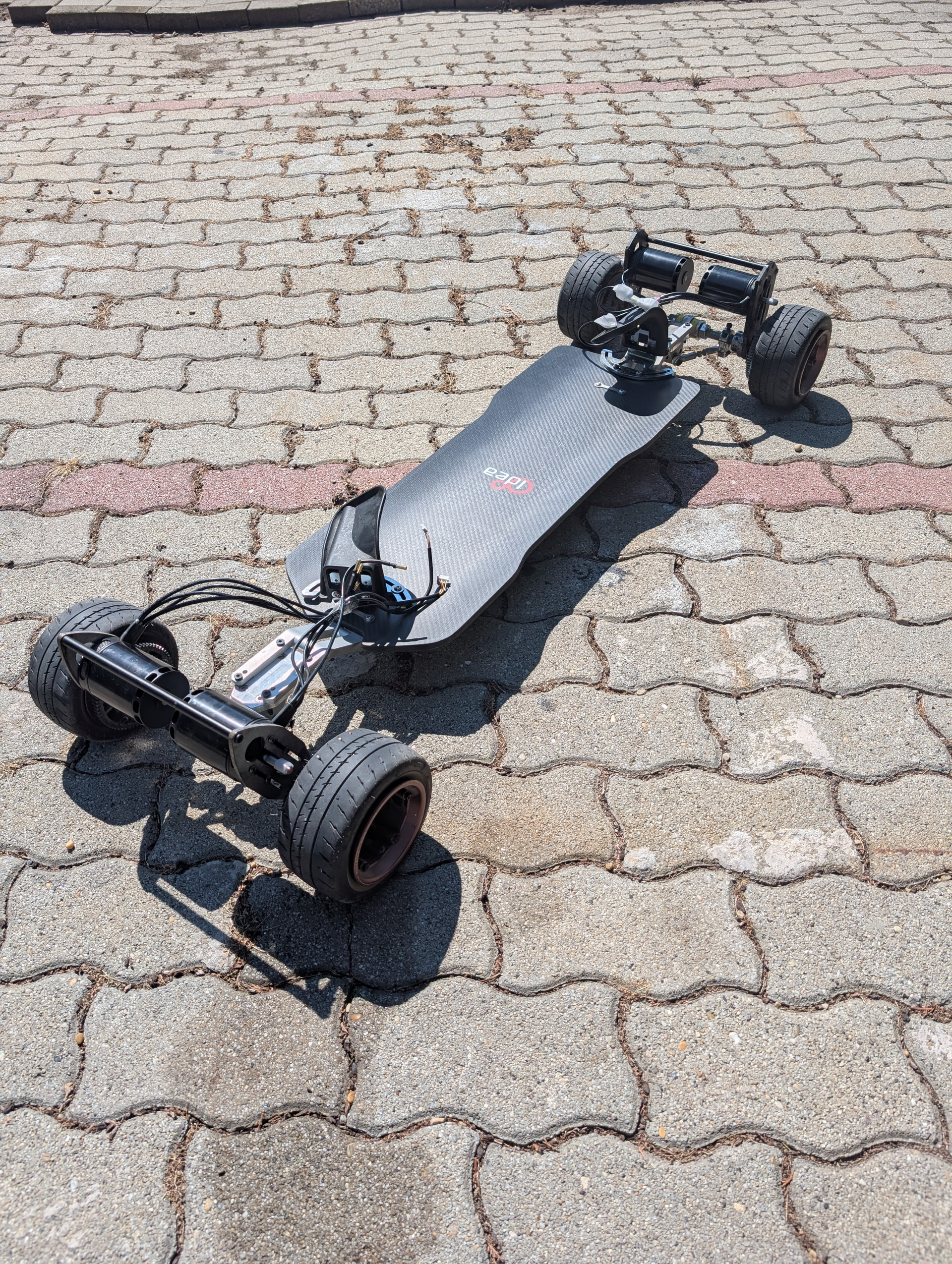

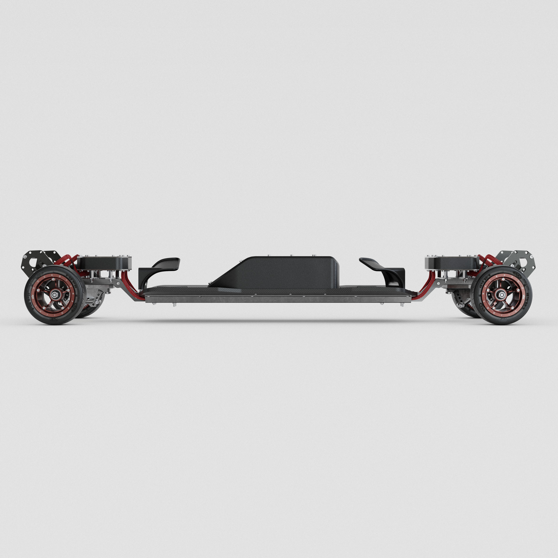

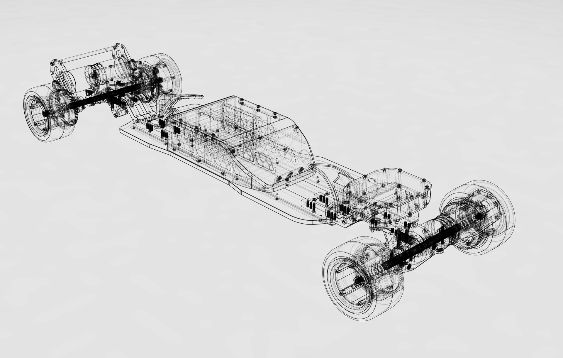

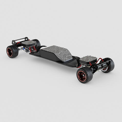

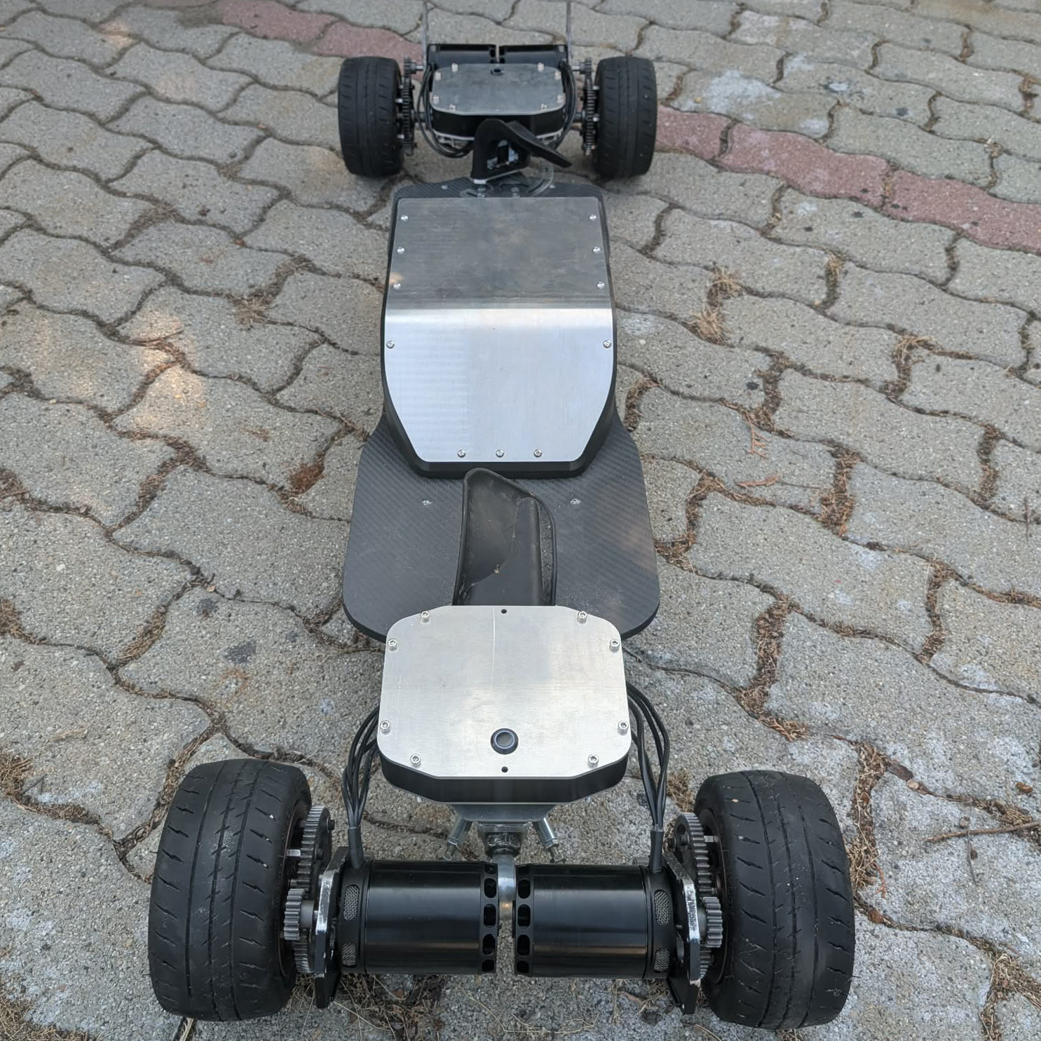

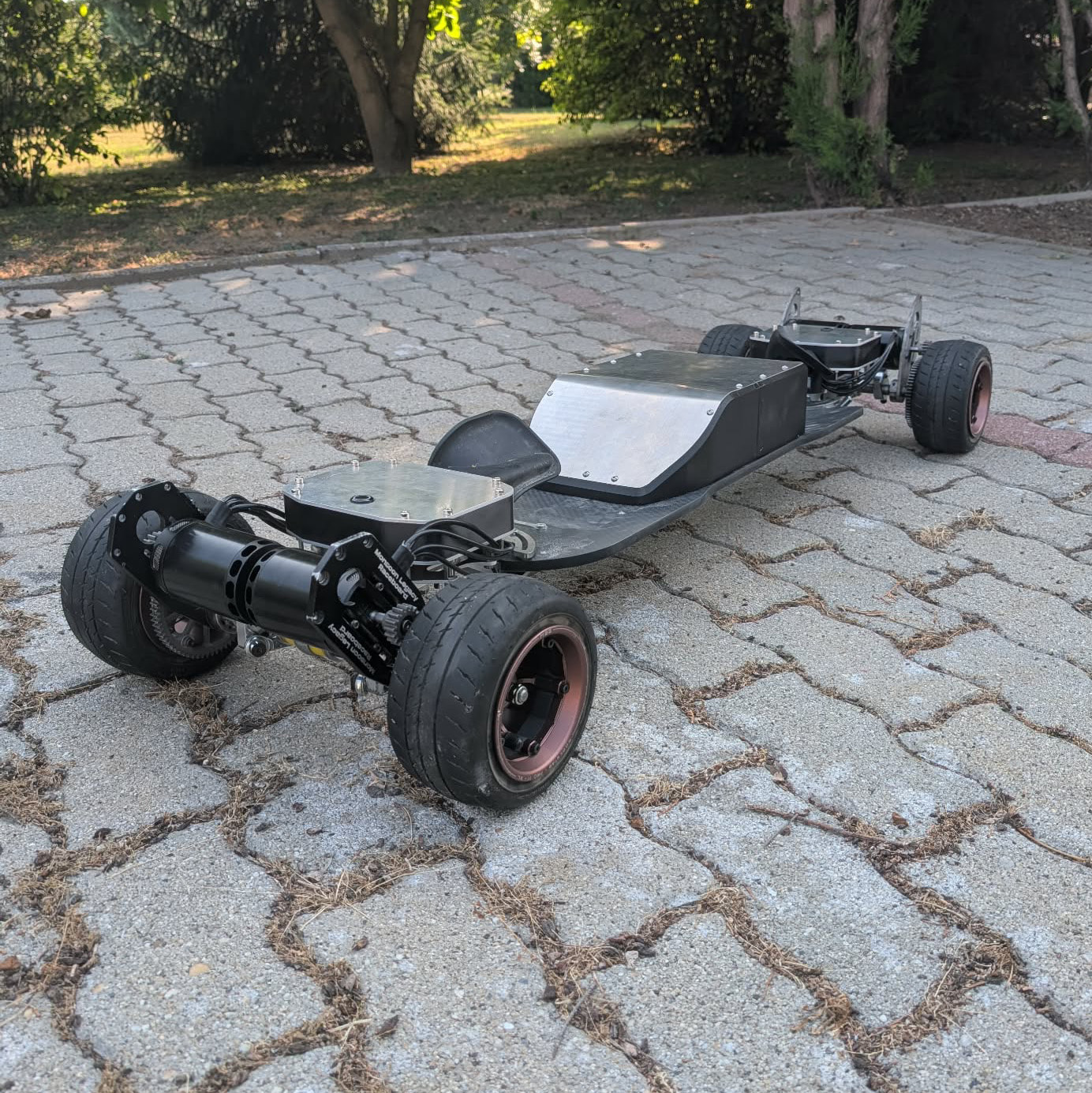

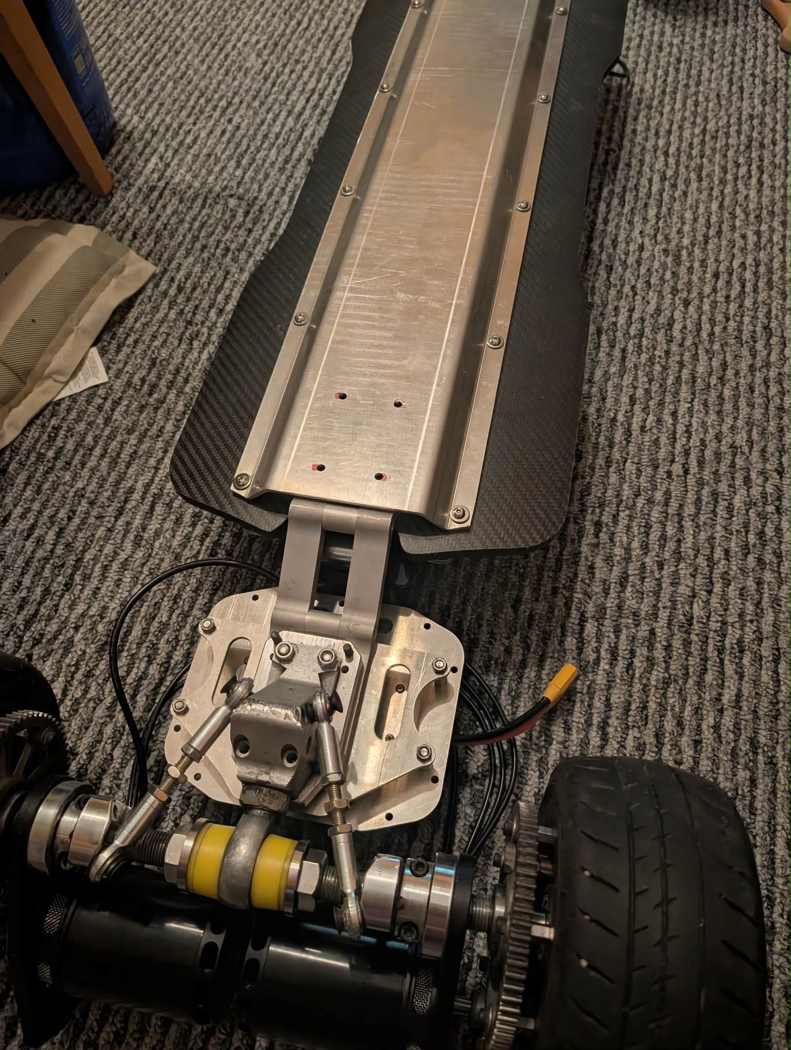

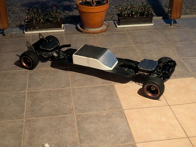

Originally, I planned to convert my Exway Atlas Pro into a race-oriented board, but the more I thought about it, the more it felt like a compromise. Instead of modifying an existing board, I decided to start from scratch and build something purpose-built from the ground up.
(More Than An Atlas - Getting into Racing)
I started by designing it in CAD and ordering the parts. A few components have already arrived, but there’s still quite a bit left to wait for.

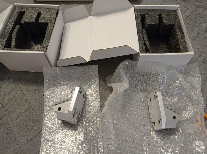

Trucks
3-Link trucks with @IDEA **adapters
The standing height proved to be excellent. The design feels stable while keeping the platform relatively low.

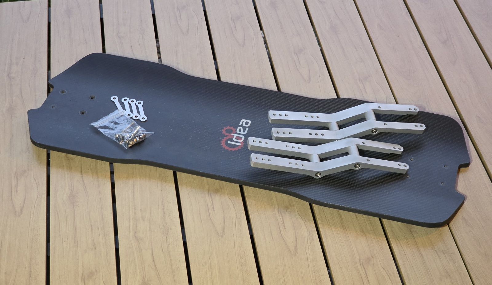

Deck
@IDEA **Deck + 30 mm brackets
I really like the design of the deck. Combined with the truck setup, the axle and deck sit perfectly level with each other.

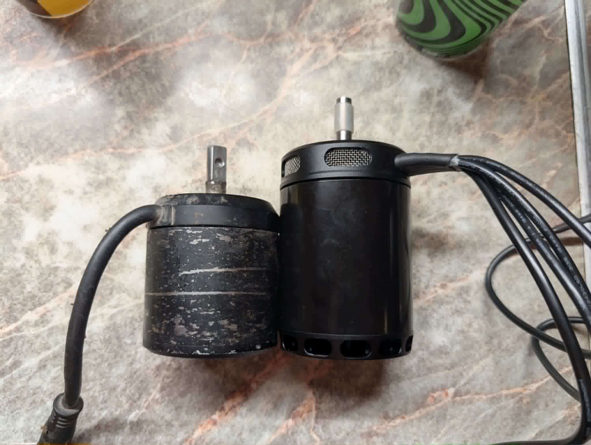

Motors
**4 × Reacher V6.0 6395 – 145 KV
-old Exway - Reacher motors
In my opinion, these are among the best motors currently available for esk8.

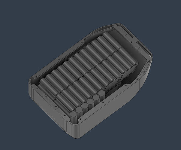

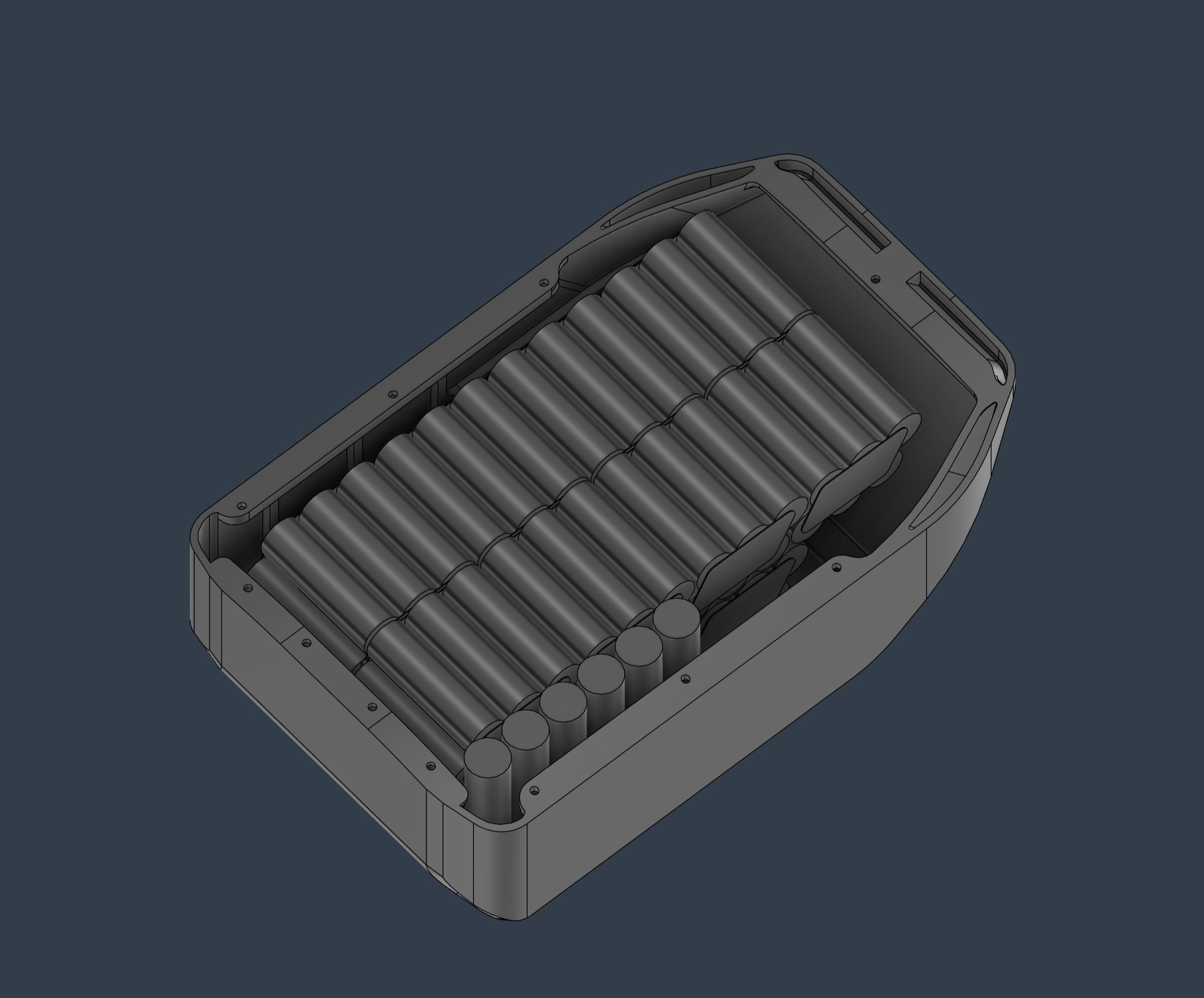

Battery
16S6P Tenpower 50XG

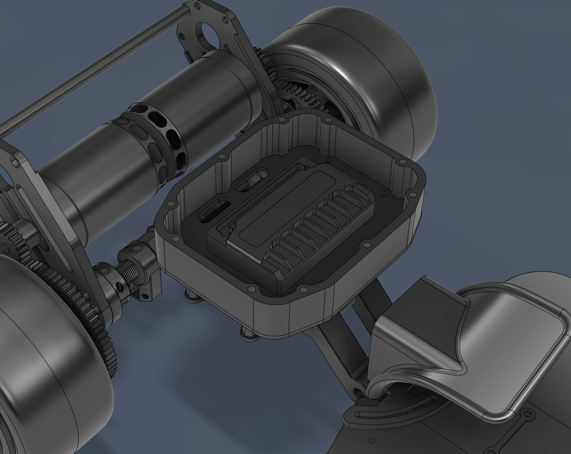

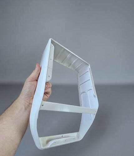

Custom built battery enclosure. (3d print + sheet metal)
ESC
2 × MakerX D100S
Custom built esc enclosure. (3d print + sheet metal)

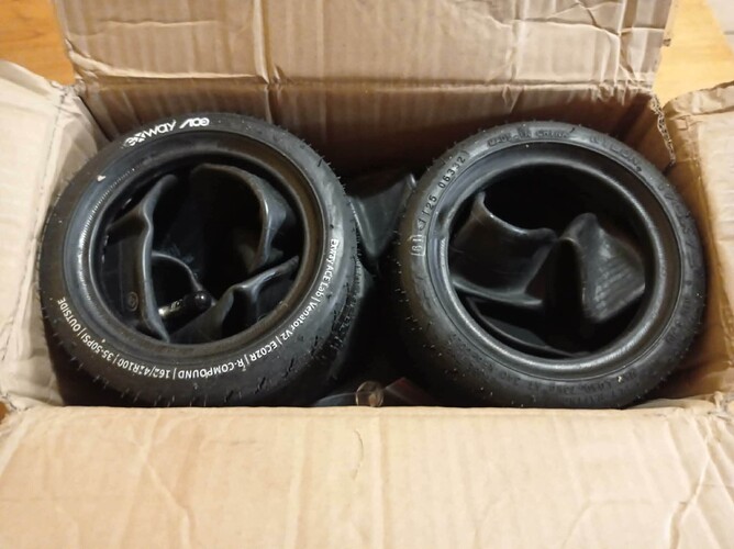

Wheels & Drive
MBS Rockstar Pro II XL + CST-Exway tires
Running an open gear drive setup with:
As soon as all the parts for the project arrive, I’ll be back with updates!

Looking like a super cool build so far, love the renders!!

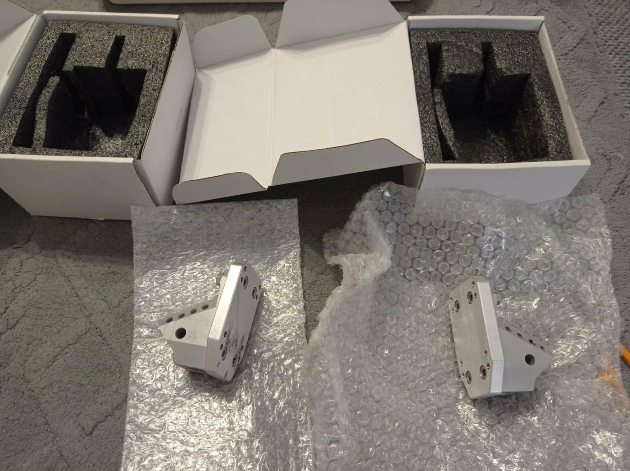

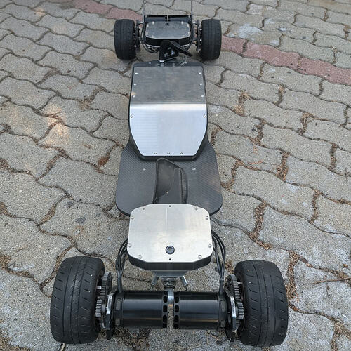

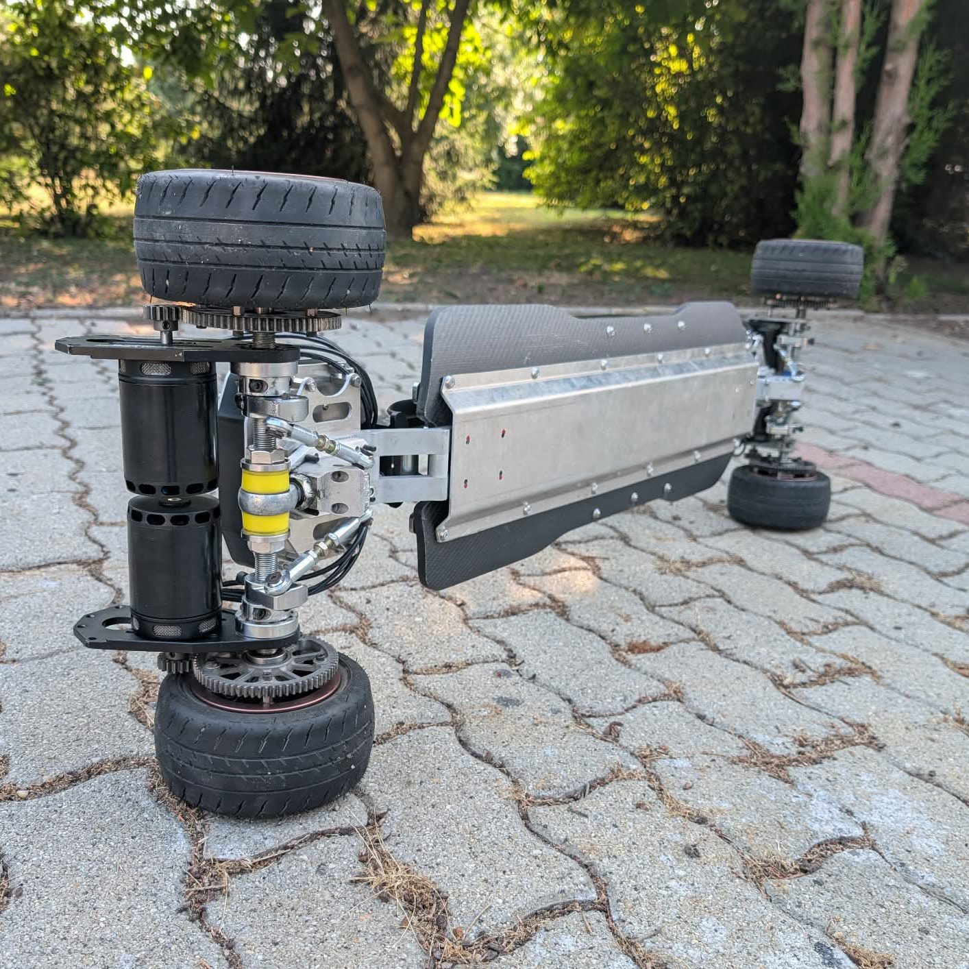

So far everything is coming together nicely. I’m waiting for the sheet metal parts, the 3D printed components, the esc, and the battery cells.
The cells are expected to arrive in early August.

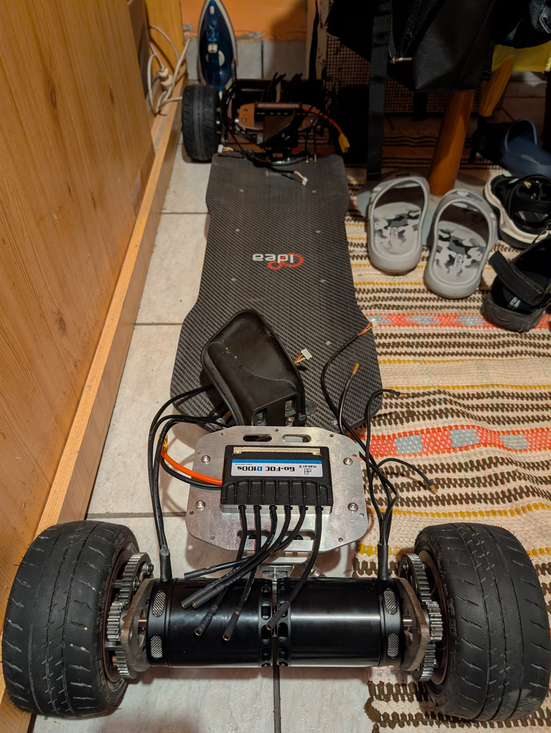

The ESCs arrived!:smiling_face_with_sunglasses:
The best !!!

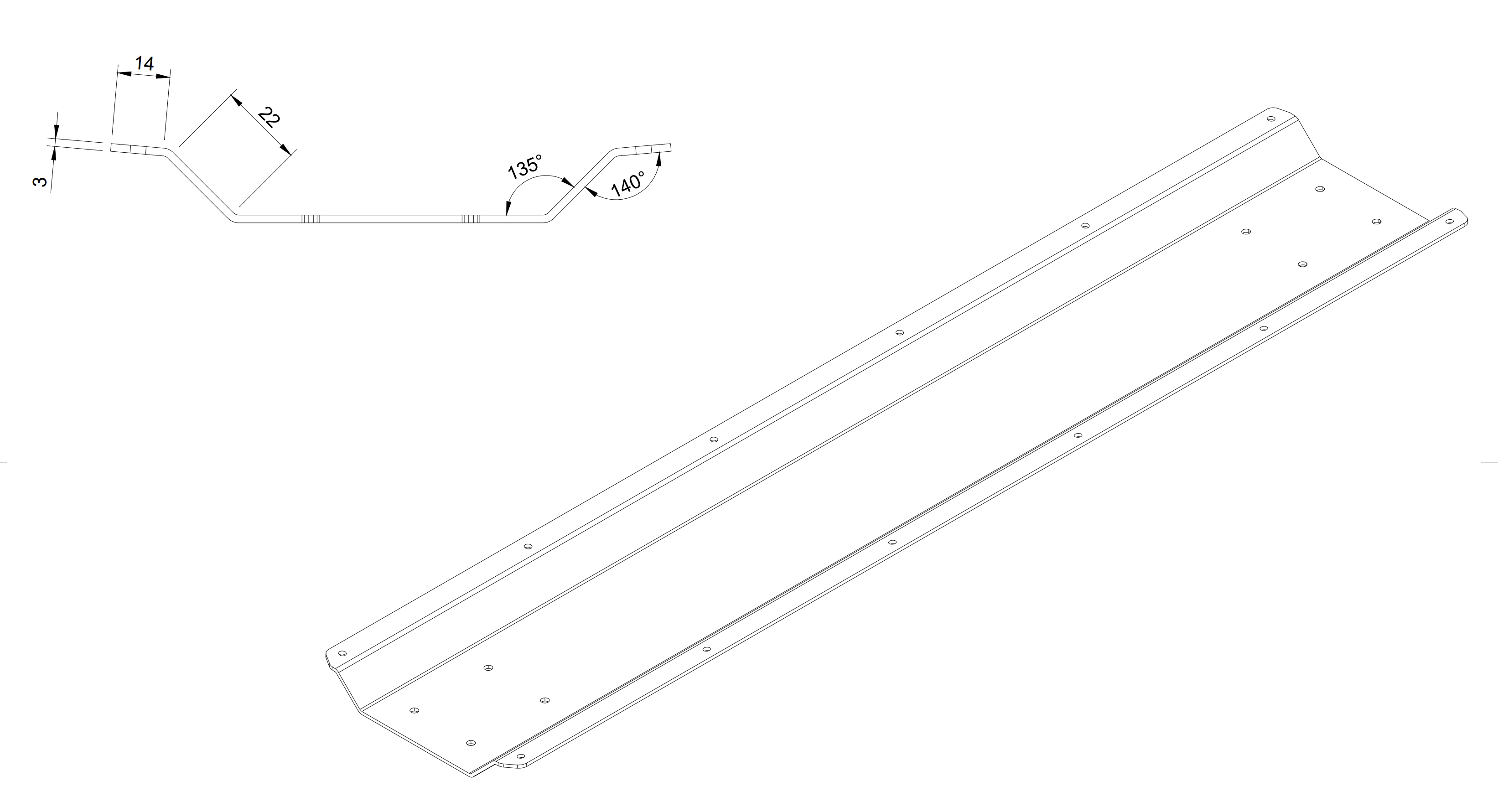

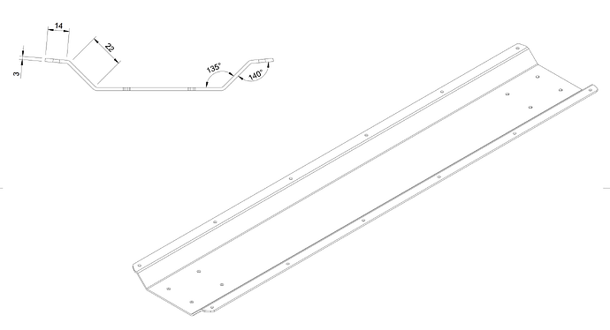

Awesome! How did you do the bottom plate? Is it aluminium?
