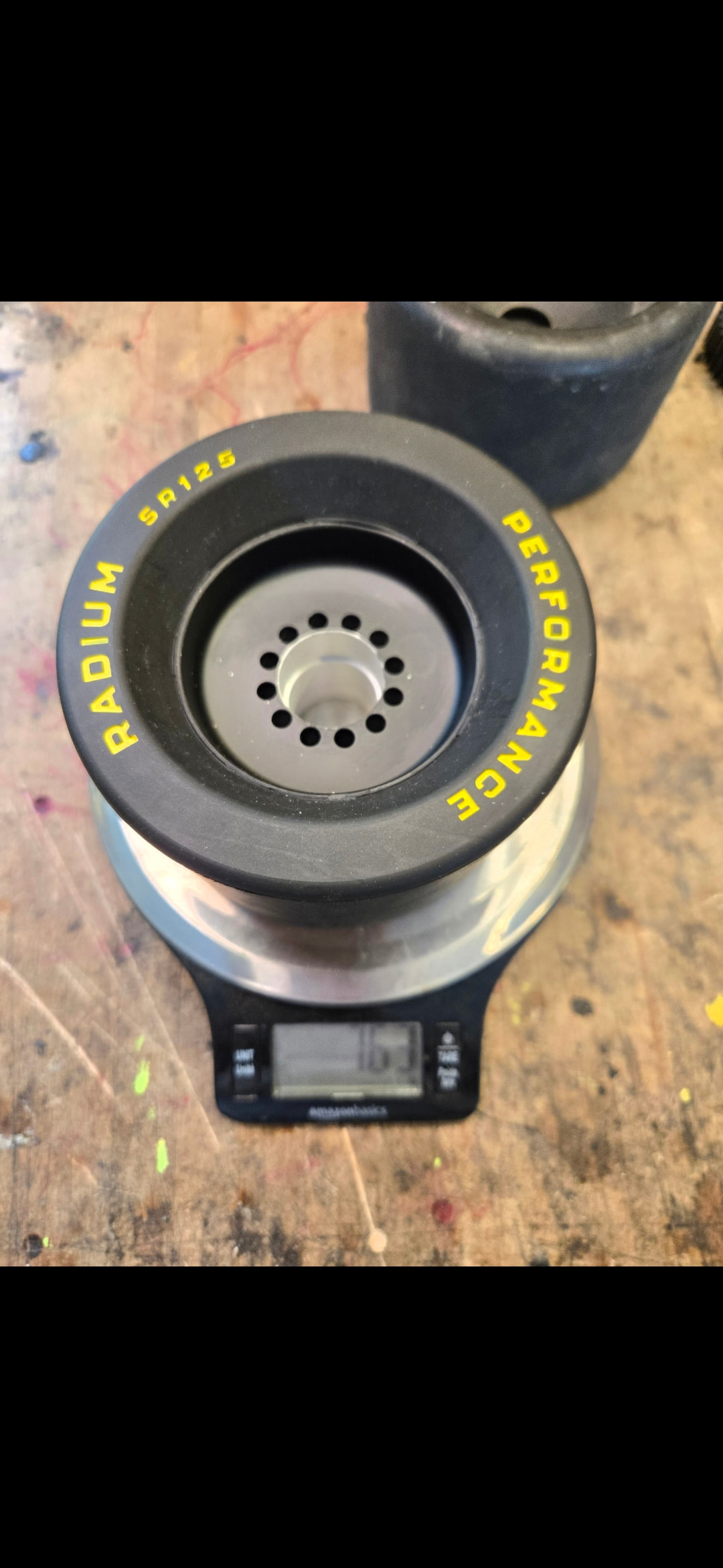

The SR wheels are a rubber compound and heavier.
Can’t imagine heavier than the MAD125, that sounds crazy. Anyone know how much the SR125 weigh?

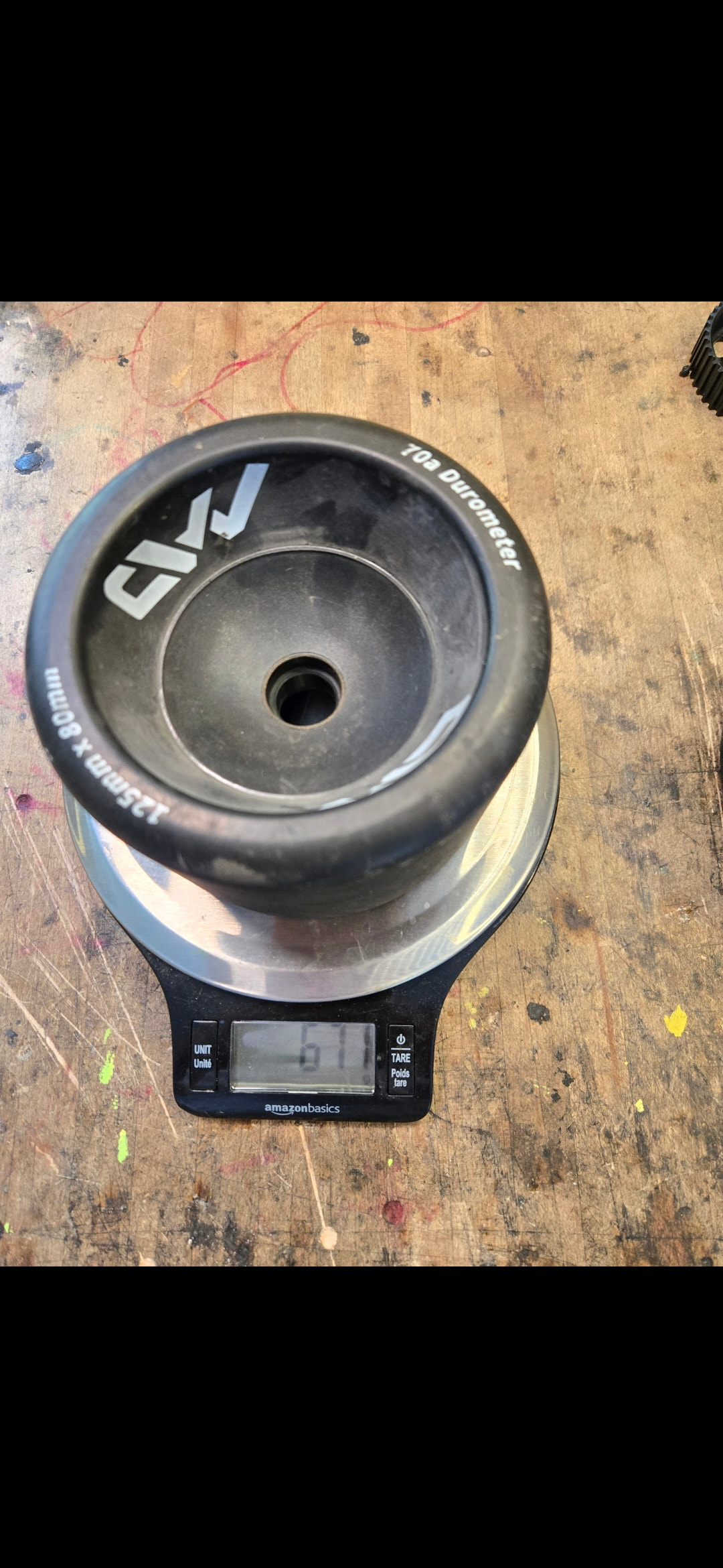

SR125 are 770g per their website. I can weigh a MAD 125 tomorrow.
Looks like less than 100gram difference.

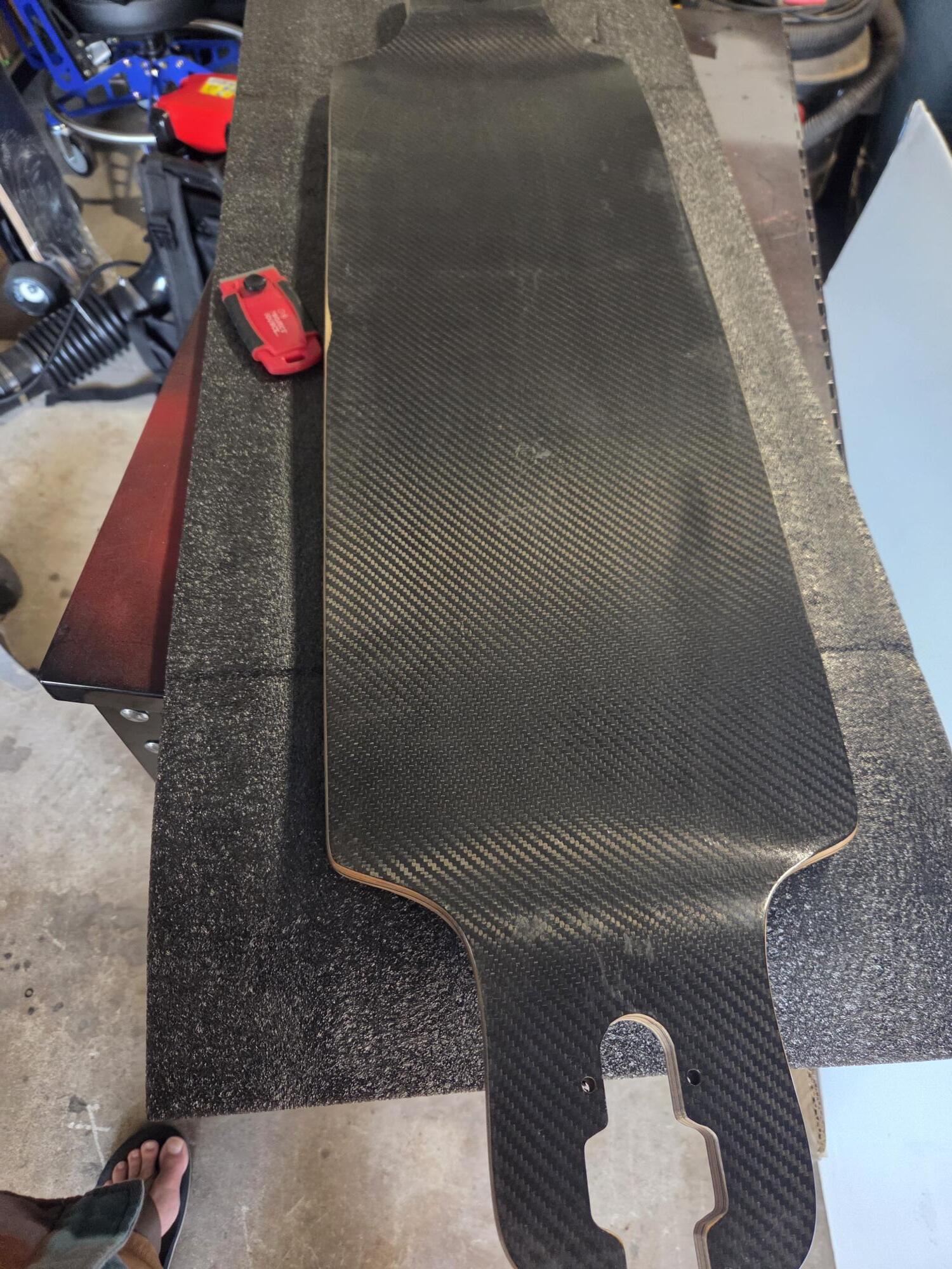

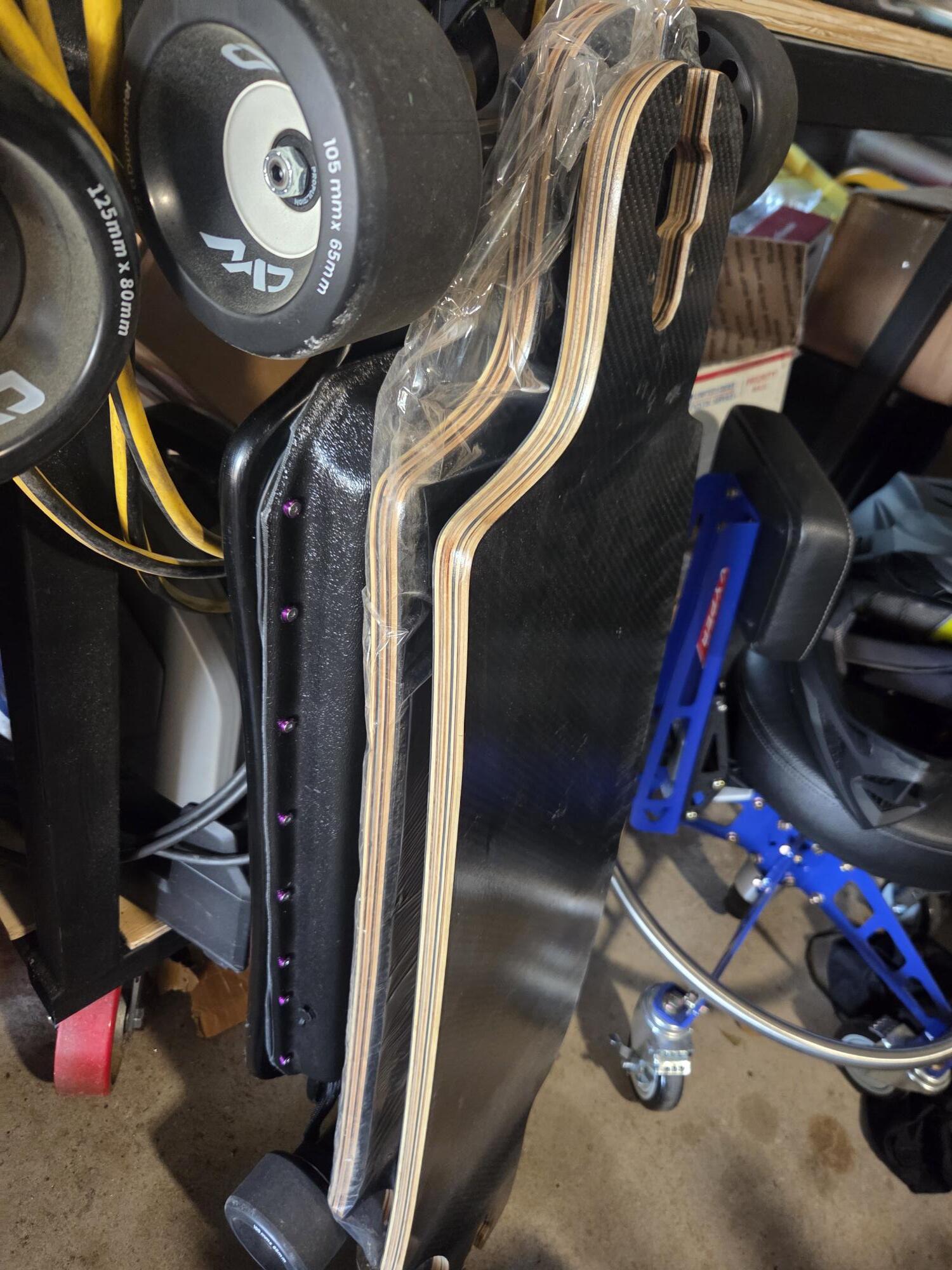

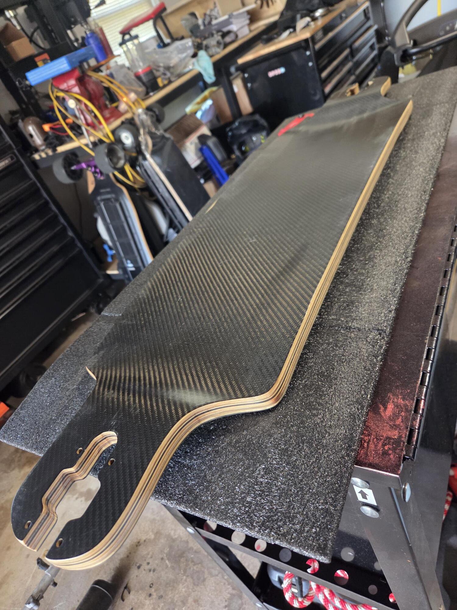

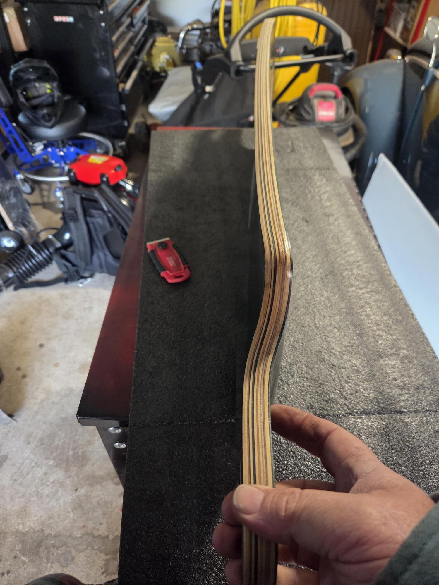

Happy day, I received my boards from Josh. 1 perfect board and 1 with a blimish. To tell you the truth, this blimish board will be my 1st. The imperfection won’t be visible after assembly & board use will scratch it up anyway. I’m super happy, thank you again John aka hummieee!
