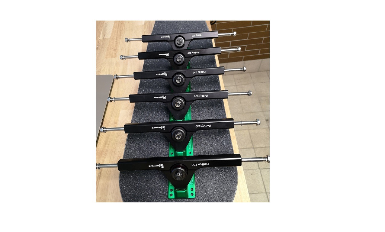

I would like to know the opinions of anybody who has tried 3dservistas trucks or trucks that are very similar in designs and functions compared to MBS ? Bioboards uses them on their boards and I believe they must be stable for high speed however, how well do they carve ?

Are you talking about 3D’s matrix II trucks? Or the extra long caliber profile trucks that bioboards has been posting a ton of?
Regardless… they are both more or less extra long versions of their original counterparts (3Ds matrix II profile is different, but that’s a good thing imo). The extra width/weight makes them feel a little more stable, and the matrix II trucks in particular are a lot more solid in comparison to the OG.
The calibers obviously have a huge range of bushings to dial in the carve/stability. MBS has less, but still a good range to get carvey wit it. Either way, the trucks do not change that b/c the bushing seats are similar enough.

matrix 2 trucks are mtb trucks. unless you have a mtb forget about them. Vice versa if you have a mtb then you can’t use normal trucks without an adapter.
Comparing the 2 makes no sense. like comparing an Airbus a380 with a jet

One is a mountainboard truck the other is a longboard truck.
They’re apples and oranges. Very different.
The longboard truck is meant to be stable at higher speeds.
The mbs will always Carve harder.
But both need decks with much different geometry. Or adapters of some kind.
What do you mean the MBS will carve harder ?
You’ll just be able to carve much more aggressive on them.
Caliber trucks weren’t designed with carving in mind. But can be damn stable at high speed.

If you don’t plan on going over like 35 miles per hour, I would definitely recommend the mbs.
But again both these trucks are entirely different and intended for very different types of boards.
(I do think the MBS could be made stable on the right set-up with the right ridder th0)
Yup. Totally different from the mtb/mbs trucks. MTB/channel trucks (like the mbs matrix II and trampa spring trucks) do not turn when they are compressed, so you need a slanted service to mount them on to get any turning ability (like MTB decks or the kaly/lacroix bois). That’s why ppl are saying they aren’t exactly interchangeable.
