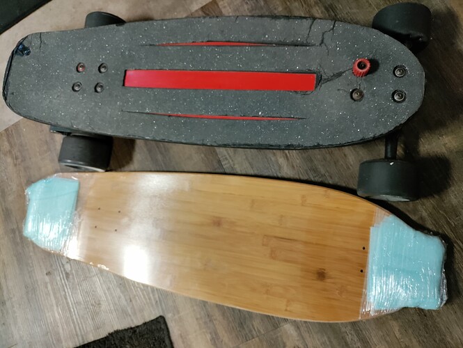

31.5in maple to 33in bamboo
…And 16s maybe?
Nice! That’s the same deck I have on my kicktail board — almost identical build config except for the single motor drive.
IMO 16s is overpowered for that small of a deck, and I’ve gotten the perfect torque & speed combo via custom pulleys and high amps.
What kind of range do you typically get?
Thanks! I expect 15 mile range under normal use and have seen 19 miles with 10% left on the battery at a 6-12 mph average speeds.
I’d love some custom pulleys!. I’m currently running 14/45 pulleys for a 3.21 gearing ratio.
This is the vision, but is this too much power for a shortboard?
@yoyotinker How long have you had your kicktail board?
I guess you’ll have to build it to see if it has too much power for that deck size!
I built mine in March 2022.
