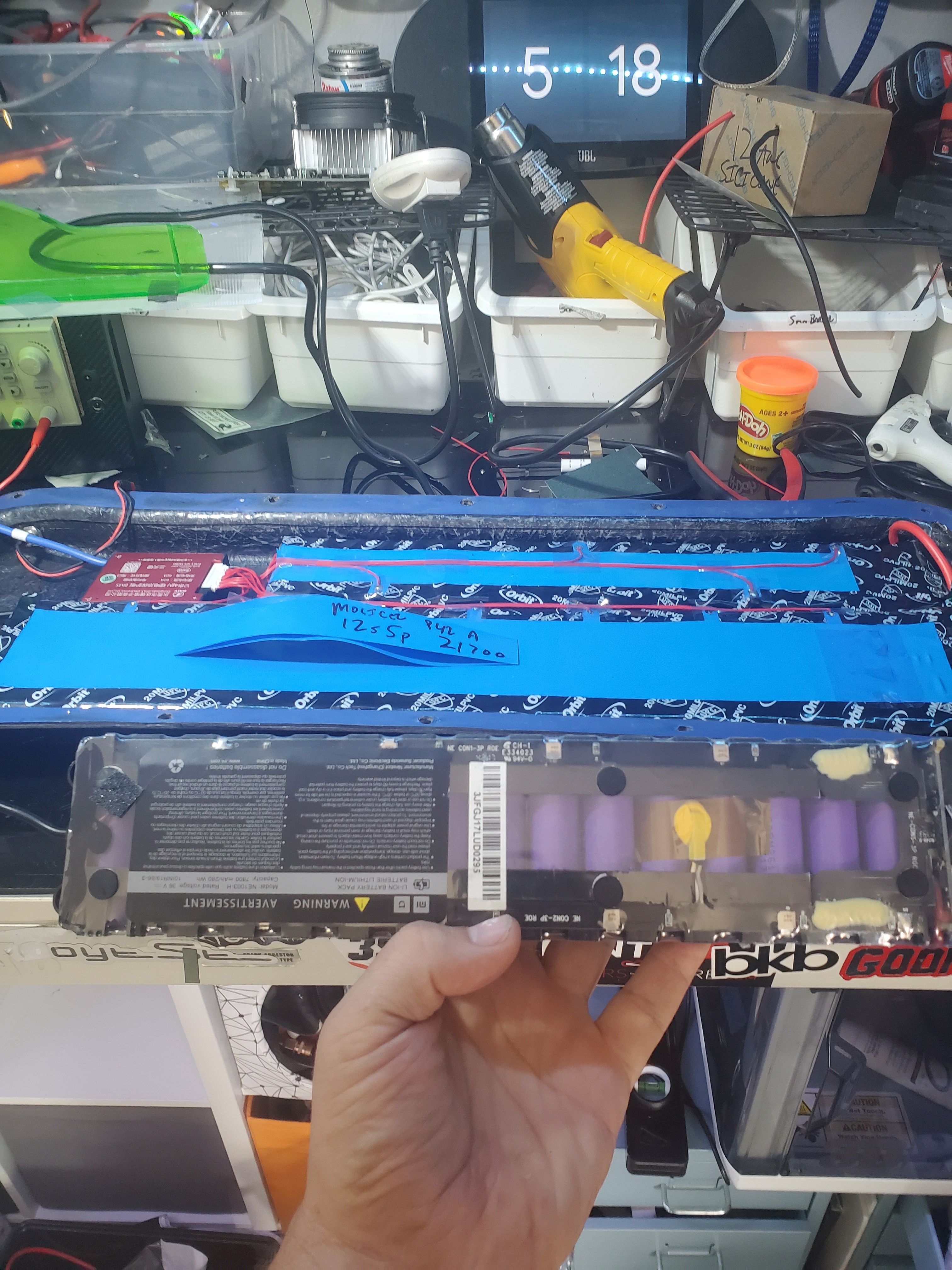

Steal a lime scooter battery. They give me 20 miles

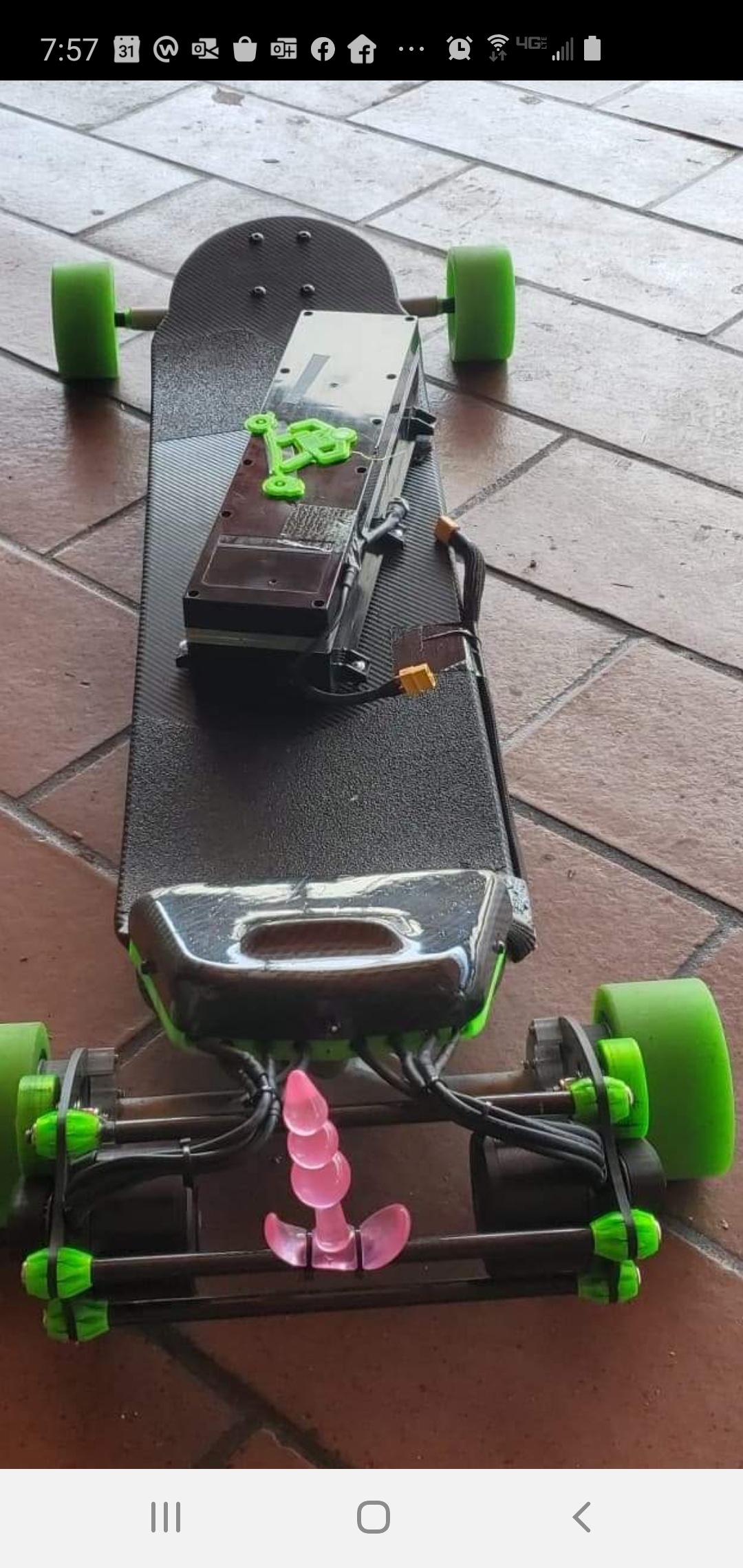

Do you have… a butt plugg on your esk8? Does that help with drag or something? Also I would never steal a lime battery :rage: how easy are they to steal

it’s a ten dollar investment in security torx bits
source: i used to charge lime/bird’s to feed my kids
wouldnt they like check who last had the scooter out and just charge your card for the battery
it doesn’t make sense for you to rent the scooter and then take it apart at home. either just take it apart where you find it, or bring it home in your vehicle and then take it apart. ideally, you would buy it from your city impound for pennies on the dollars so you have all the rights to the scooter. however, i see them lying about all the time in the bushes, treated like trash by their corporate owner, riders, and the community alike. anyways, the first step to “decapitating the bird” is disconnecting the controller board (with integrated gps) from the rest of the vehicle, which is what you’ll need the security torx bit for. the more i think about it, i think the screws at the bottom of the chassis just needs a standard hex drivers. that will let you take the pack out and leave the carcass behind, tracker and all. while you probably want to use your own bms, there is open source firmware available for the xiaomi bms used in most of these scooters.

Very very easy. Just give a tweaker $20 and come back in an hour

It’s a 10s8p lime battery. Smaller lime/ birds are 10s4p
