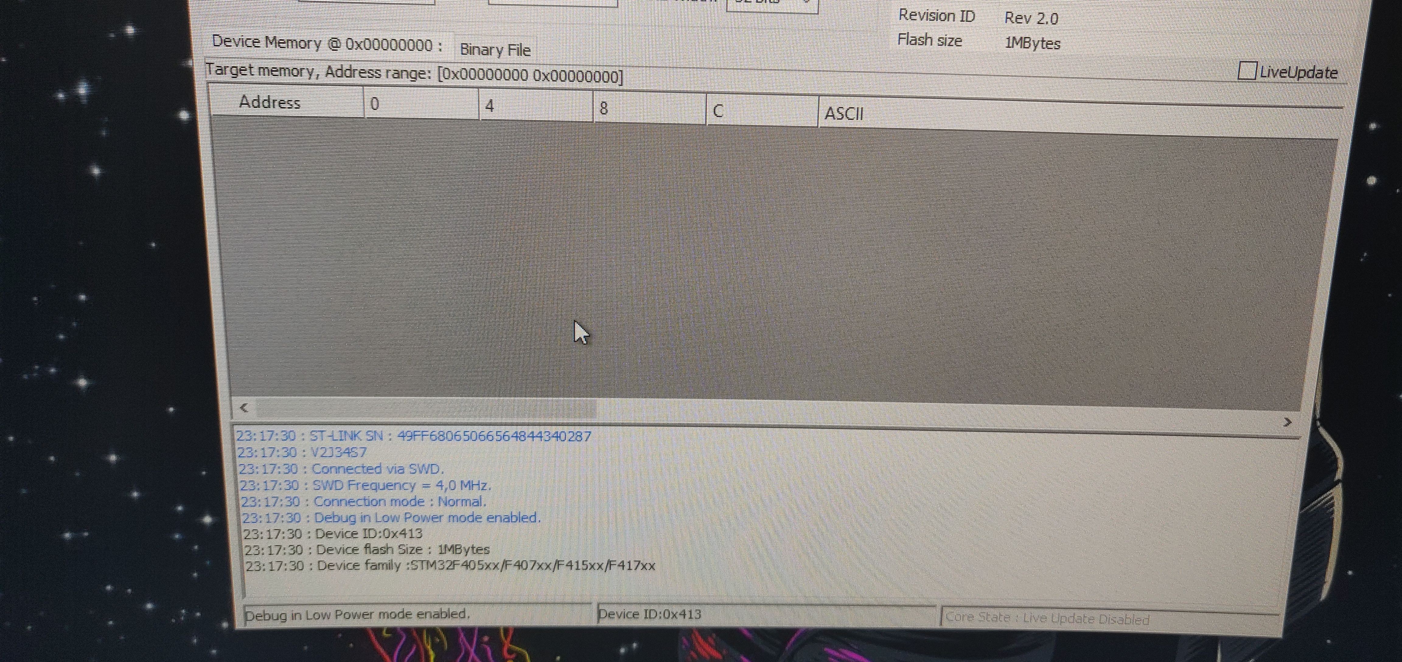

Well i have finally assembled one after ordering all the parts probably a year ago and i can’t seem load the bootloader with an st link v2, i have installed the drivers and st utility, blue light comes on but when i press connect it says failed to connect etc and the light goes off on the st link. Board pulls 60ma when powered with 12v and i don’t believe there are any shorts.
Have you ever been able to connect to a VESC with that ST Link V2 and your computer? I’m trying to verify if you have all the drivers and stuff installed.
Your soldering looks good btw
i have never needed to use an st link before, the first vesc i purchased was a flipsky one so i just changed the firmware etc through the vesc tool, after doing a bit more fault finding i think i installed D5 the wrong way round and i checked the leds using the diode tester on my multimeter and now D4 no longer seems to light up, still shows 2.0v as if its working but no light. Also i don’t seem to be getting anything on the 5v or 3.3v pins.

D3 is backwards. Please double check all of your diodes and LEDs for proper orientation.
some progress,i swapped D3 around but it didn’t seem to change anything i now have , i checked the led D4 and it didn’t seem to be working so i got another checked it first then installed and still i didn’t work so then i changed R48 back to a resistor as i did have it as a ptc fuse as i think you suggested it way back and i’m now getting 3.3v and 5v with the blue led on when connected to the st link but i still can’t get it to connect on the st utility. Any settings i need to change in the st utility?

stm32 ic was also backwards :laughing: checked my st link with a known working flipsky vesc and it connected so i then noticed the stm32 i have has 2 indents on the top and i obviously put the wrong one to the pcb mark, realised properly after looking at others that have built them. connects now yaaaaaaaaaaaaaaaaaaaaaaaaaa
