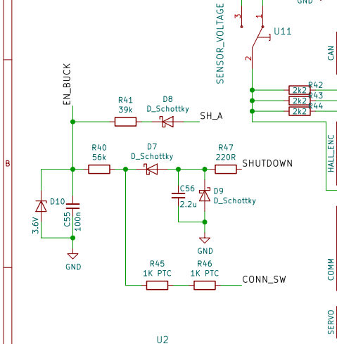

I’d love a momentary power switch, and maybe 1-2A 5v output for LEDs

the 1 to 2A 5v output is doable I think.
I can try the momentary switch support but it will be experimental. There are circuits that basically convert a momentary signal to a latched signal and that’s what I’ll try.

Not sure if you meant circuits as in building it discretely, but if you add a single cheap flipflop IC, and a jumper to configure the switch input as either its normal path or routed through the flipflop, I reckon that could do it.
Yeah discretely is what I had in mind since discrete components are in better supply right now. I could do a flipflop IC or make a flipflop circuit out of NOR gates but the issue again is finding good stock of this stuff.
Havn’t studied the design enough, did you implement the push to start circuitry?
Since you removed the DRV this might be bit harder to since its tied to the EN pin

No I didn’t implement this. Yeah I’d have to adapt this to an enable with different logic since I’m not using the drv

I was hoping for integration with the firmware’s momentary switch features.
Tho any momentary support would be better than a 2 position, I had my EUC shut off when it fell over once (it has an in/out latching switch), and I’m forever worried it might shut off if it hit a gnarly bump.
LED power will be awesome, even if its limited 1 amp, that’s 20x ws2811b, maybe a little less if there controlled by an esp32
Firmware based shutdown isn’t true shutdown in my opinion. Everything but the STM is still fully powered on and sapping energy. I prefer implementing a true shutdown where the drain on the battery is less than 1mA when turned off.

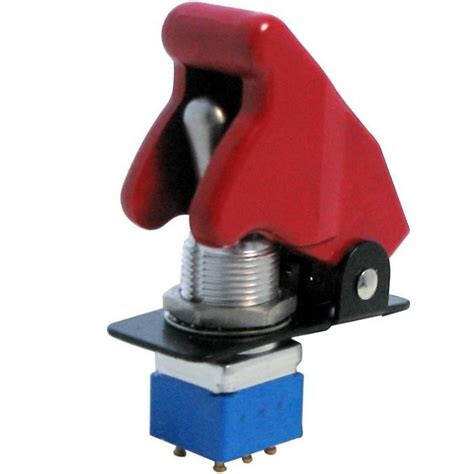

Switch guards might help too. Widely used in the heavy ass military comms equipment I used to haul around. Keeps the bumps from switching/damaging the switch. Would probably work for the button type latch switch too
