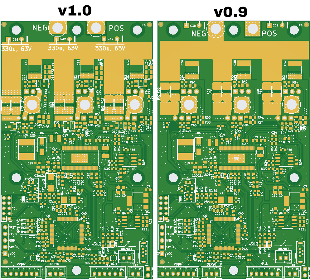

Hi. Again a stupid question, probably. Where do I find v1.0 gerber files (for JLCPCB) ? Do I have to generate them by myself from Kicad? Is it “recommended” to use v1.0, or isn’t it tested properly yet? Thank You.
All the version 1.0 stuff is here…
And the Gerbers can be found in the source directory.
My recollection is that…
  • V1.0 is the best thing going currently.
  • It’s not as much improved over v0.9 as Shaman had hoped. It sounds like there may be further improvements.
  • I think there’s a relatively simple way now to upgrade the v0.9 to a v1.0; but why not just go with the v1.0?
Separately, I think there’s some question as to whether JLCPCB and the sister company currently have all the parts we want. Keep in mind that any part we buy through them gets soldered in place for free.
Please let us know what you find with respect to parts. I might be in for building another one or two. The price per board comes down quite a lot if you do a lot of 10.
if you have 0.9 unit indeed you can (and should) upgrade to 1.0.
More info here, hardware itself:
Firmware:
the ‘‘here’’ button is the link
Cheers
I have some cheap foccers in my sales thread, all proceeds goes back to Shaman as these we’re beta units. 125 eur/each. You cant even buy components to a full vesc6 for that price atm.
Opening Kicad project in the Developer Branch (v1.0) I noticed there are additional PNP Transistors in front of the Mosfets (compared to v0.9).
Does anyone know the reason why these were added ?
Do I need those Transistors or can they be omitted ?
In addition neither the transistors nor the Schottky Diodes appear in the BOM.
Yes they were added as an attempt to have a stronger pull down on the gate to help prevent parasitic self turnon. They ended up not working well and I recommend omitting them.
