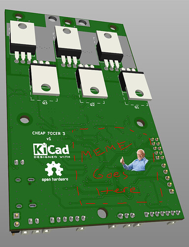

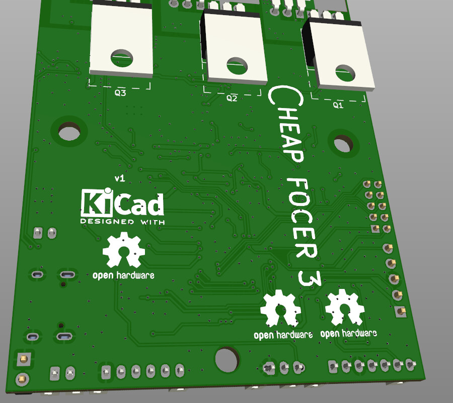

So probably the most important part of the design. Which meme goes on the back?
just a large penis please <3
perfect <3
This isn’t settled btw. I’m still open to suggestions. Then we can cast a vote later to see which one wins

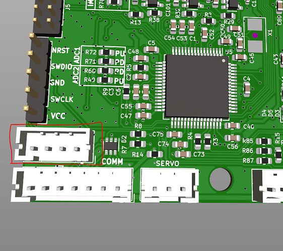

Added a connector for the second UART RX/TX channel. This is meant to easily connect an external bluetooth module of choice.
Still trying to figure out the invertible latching on/off switch and/or momentary switch support. Otherwise this is almost ready for prototyping. Gunna run it through JLCPCB to make sure that whole process still works.
