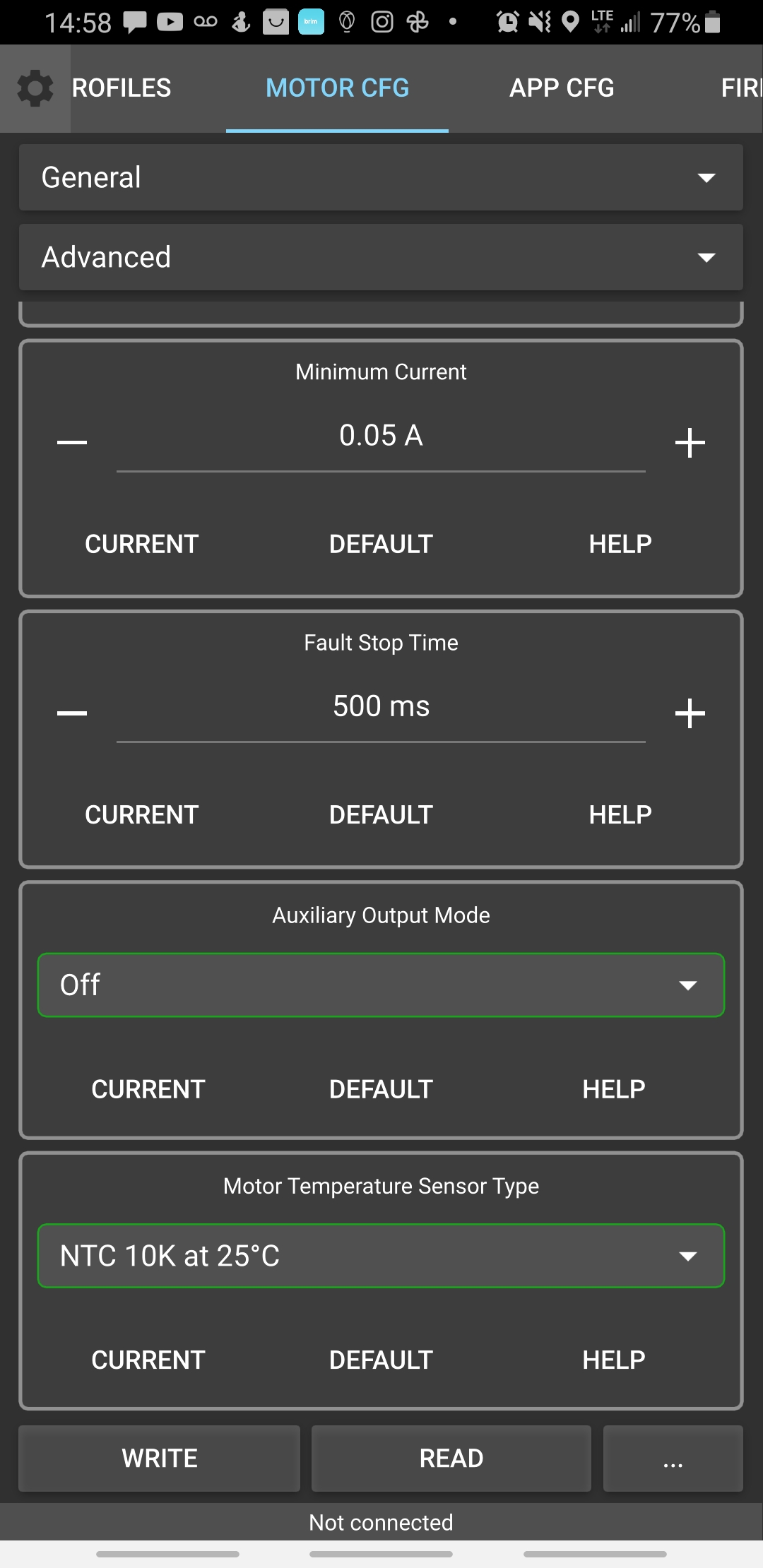

Its Importaint to restart the focer once there is a drv fault and not keep on driving. I have set a fault time of 5s to keep me from doing this. (But from now I dont expect that to happen anymore :slightly_smiling_face:)
Can you tell me more about this? I’m not familiar with that parameter. Does it disable the FOCer after the timeout time so that you have to restart it?
Thanks.
There’s like a fault stop time in the Vesc tool. I’m guessing giving the DRV some extra time before trying to reboot is a little easier on the electronics
I’ve mostly seen people decrease it for less of a hiccup when experiencing a fault but never increase it to something like 5 seconds.

Setting a longer fault stop time will make me aware that I need to stop and restart.
I chose 5s since I could get into a stop using my disc brakes within that time. Hopefully faster :crazy_face:. The focer will resume operation after the fault stop time has passed automatically but It has to be restarted.
If I have too short fault fault stop time, I might accidentally do throttle or brake and the focer could blow the DRV.
