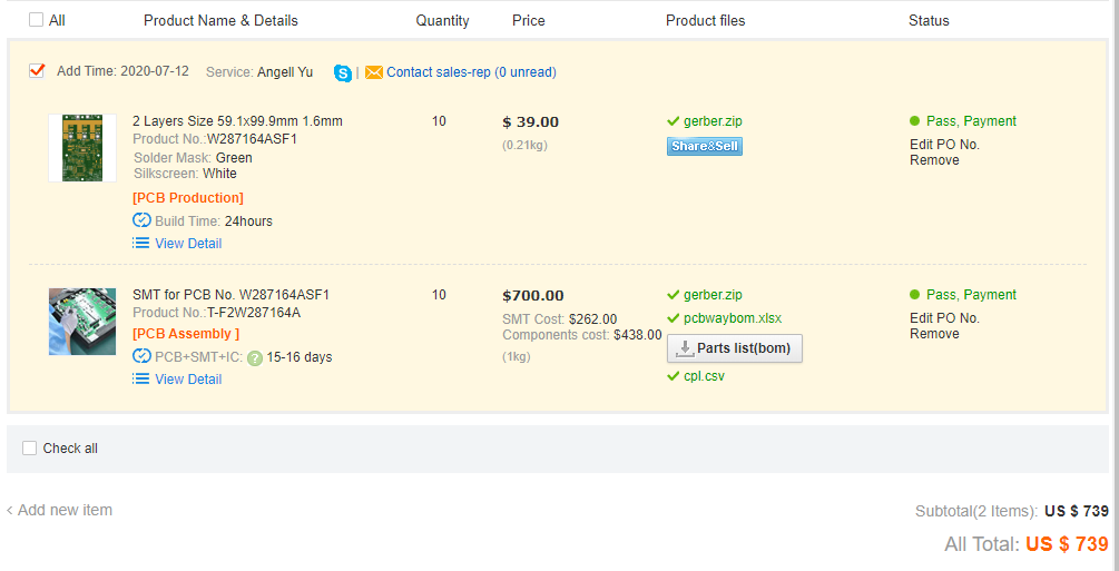

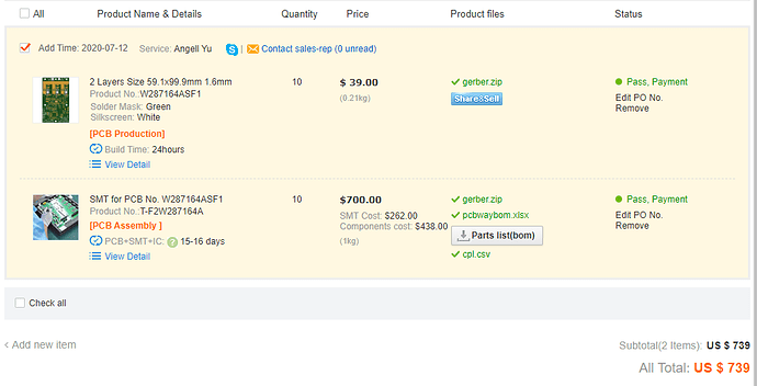

@shaman So following up on the PCBWay Guide/Pricing.
I still need to push in another quote request for simple SMT assembly rather than Turnkey, but I can say that the Turnkey prices are rather exorbitant.
Note These have not been purchased.
So not counting shipping Turnkey (which means all components soldered) sits at around 73.90USD per CheapFocer, add another 15 dollars or so a piece for some misc parts such as a heatsink, case, etc. This turns out to be just as expensive as any other ROTM v6.
As I said, I’ll check to see where we stand on pricing when the through hole components are removed from the quote. Though I cant imagine that it will drop the price 200 dollars.
They wont drop much. Only plus side with pcbway is that if you get it fully assembled with the imu and stuff and order like…20pieces, its worth it.

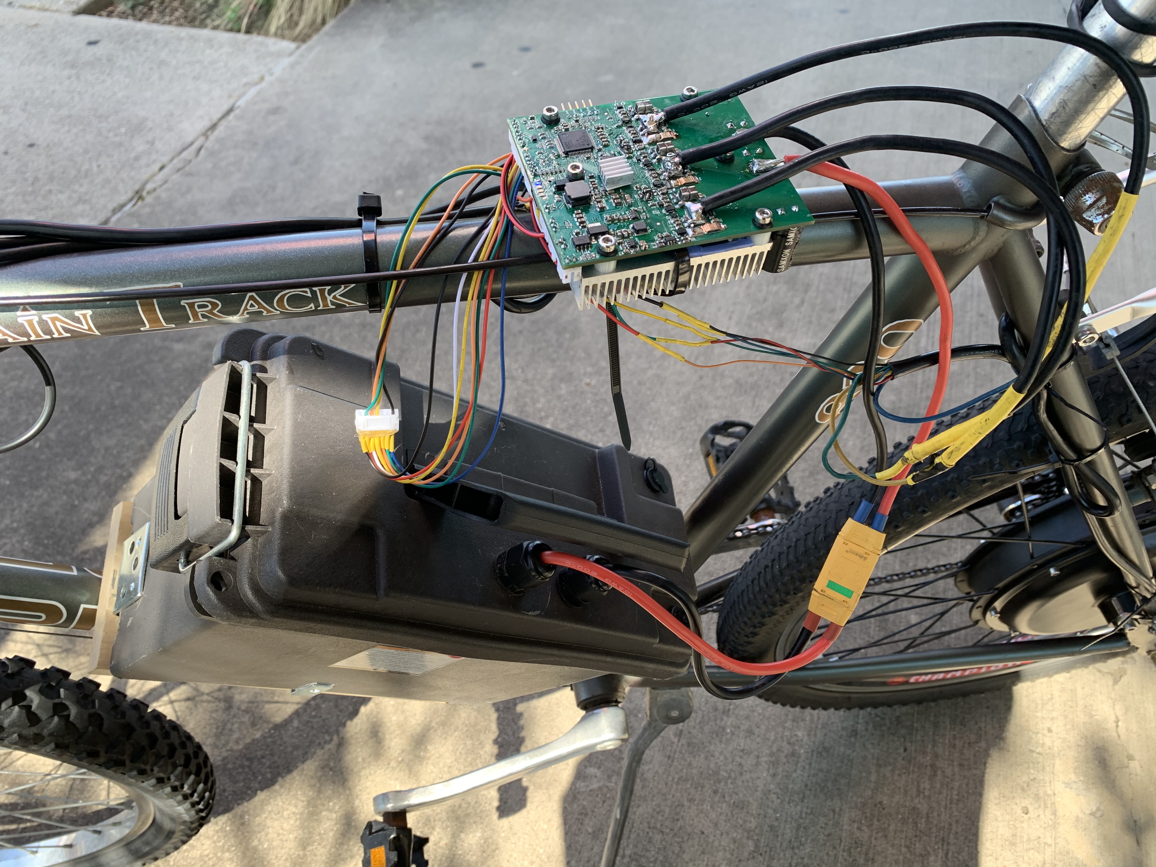

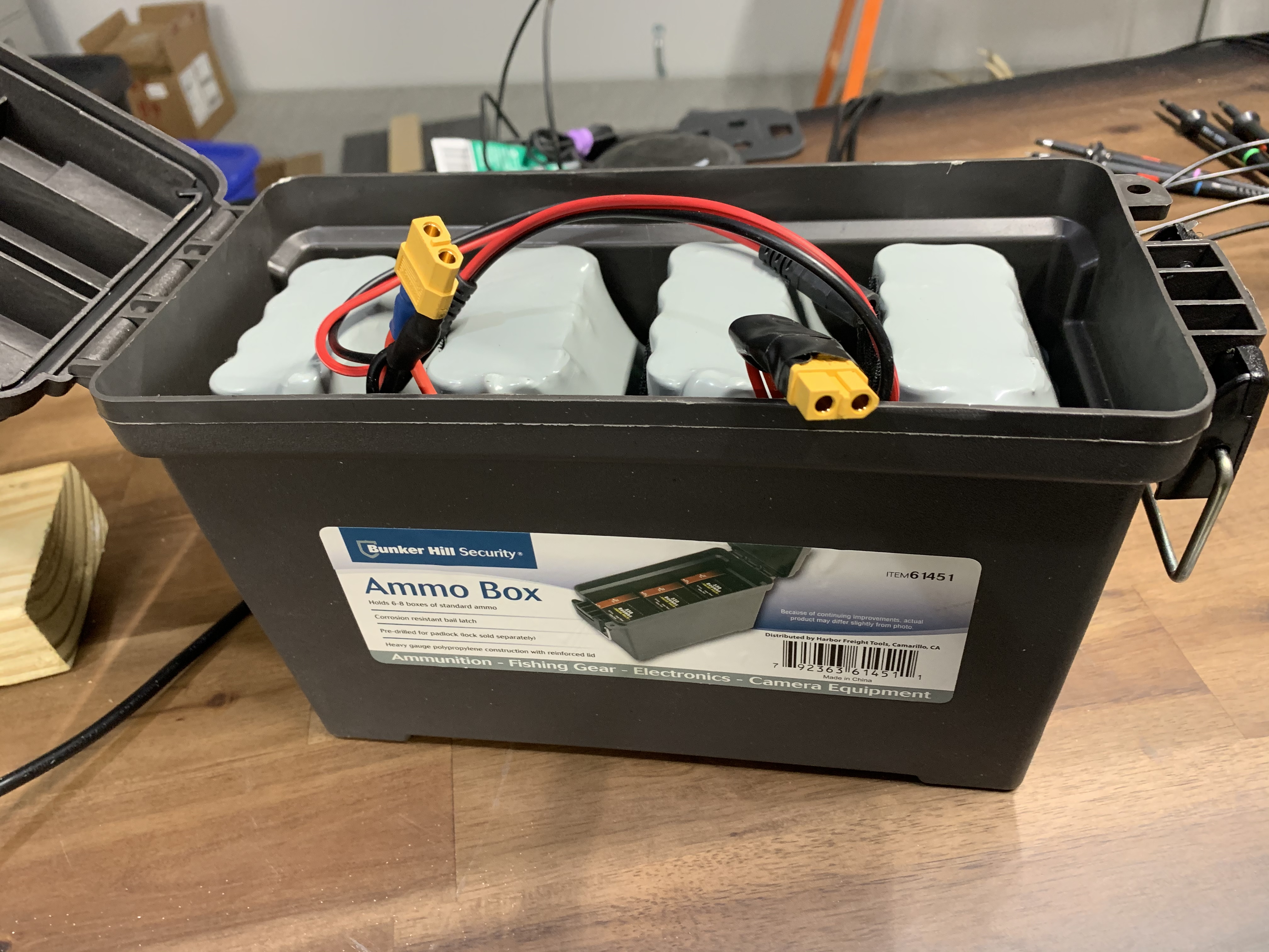

I actually use 4 of those hoverboard batteries in my ebike. I made connectors so that I can configure them for all parallel or 2S2P(referenced to the modules themselves). This then gives me whatever voltage is appropriate for testing my controller. So far I haven’t had an issue with regen braking and I have the battery regen current set to about 20A.

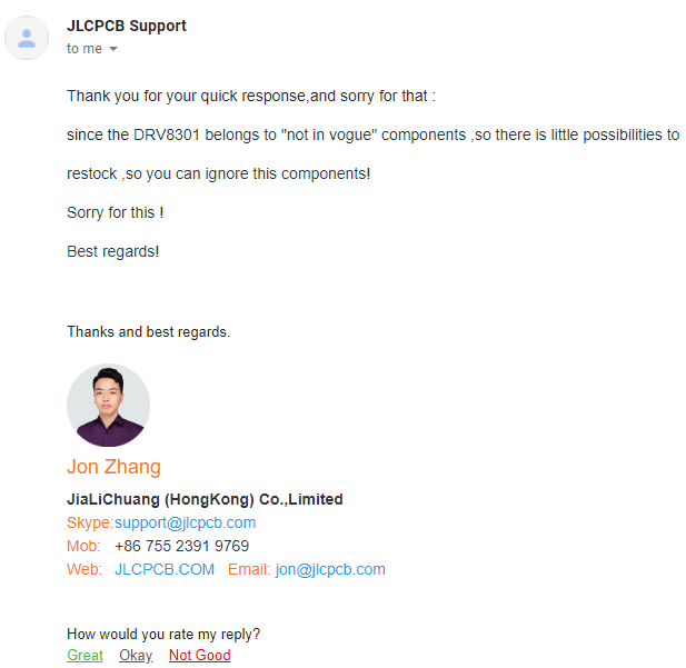

“not in vogue”? Curious what that means. Either way, doesn’t sound good for the DRV8301 to remain in stock. Not the best for the CFOC2…but that doesn’t mean I’m stopping
