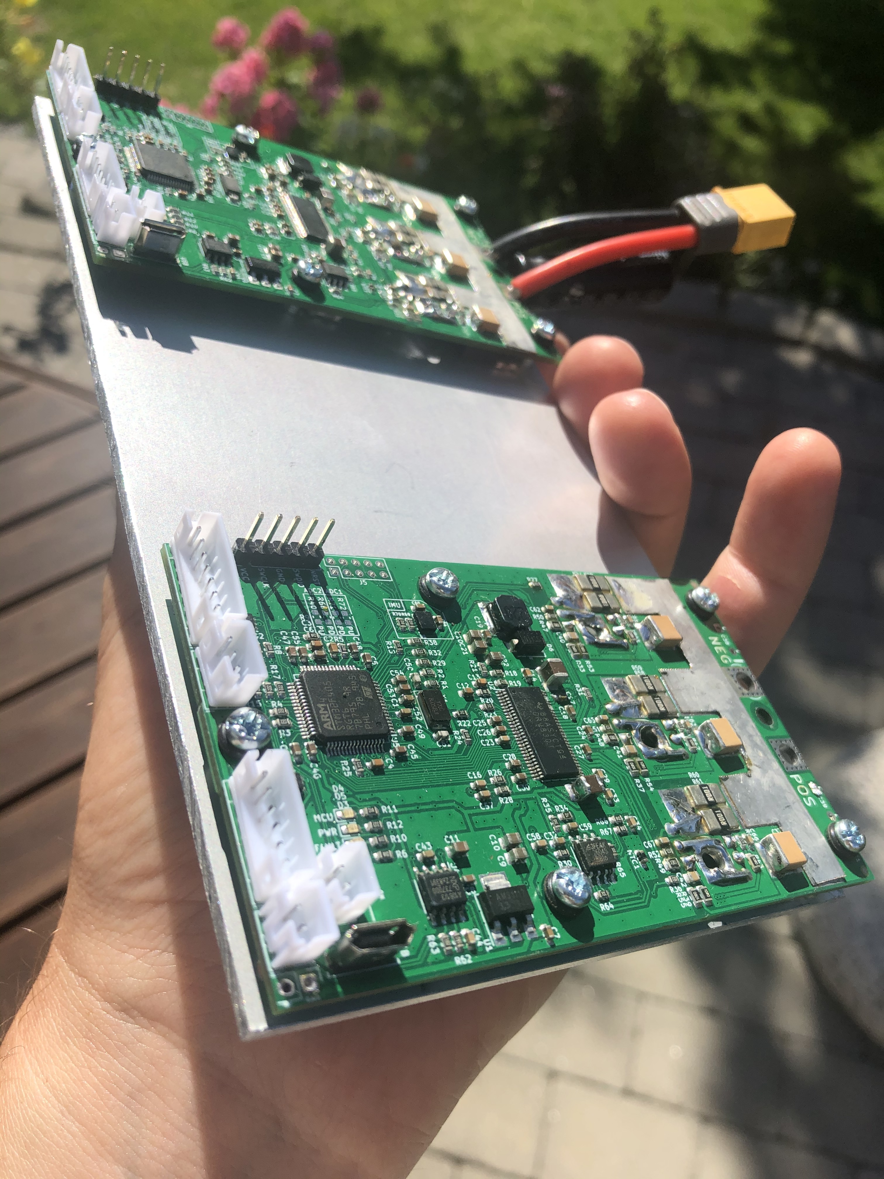

Also, I don’t have the recommended heatsink at hand but will see how well a 3mm thick aluminum plate will do. Will be slimmer than using the heatsink with fins.
Did anyone try that approach?
This is my starting point. I don’t really know what to expect here. My gut feeling is that it is not enough. My dream is to reduce the plate to the size of one focer :crossed_fingers:t2:
