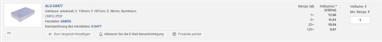

Im looking at options for enclosures, really like the aluminium cases i also use for a200s and CFOCER1.
They are cheap (7€ for a single 12€ for a dual) and the heatsink is included. Mechanical protection is great too.
You can get them in all sizes.
122x85x55mm (its too high, i use this for the a200s):
122x96x38mm (a bit too large but the height is perfect)
It almost fits a dual setup:
This would be good for a dual:
That looks like very close to the 1590BB format I was planning on using.
“Stompbox” might be a more common name for people to find from other sellers.
1590B3 looks ok for a single.
Maybe a 1590U for a dual?
On ebay, I’ve found the 1590BB dimensions at 120x94x34mm or the 125B/1590N1 at 122x66x39.5mm
some of the stompbox options are also offered with “waterproofing” gaskets, though unless you’re grommeting power/phase leads, the benefits are debatable
If you really want waterproof, grommets won’t quite do the trick. You really need cable glands like this…
Can’t you mount one on the lid and the other at the bottom of the box? Like they would face each other when closed.
