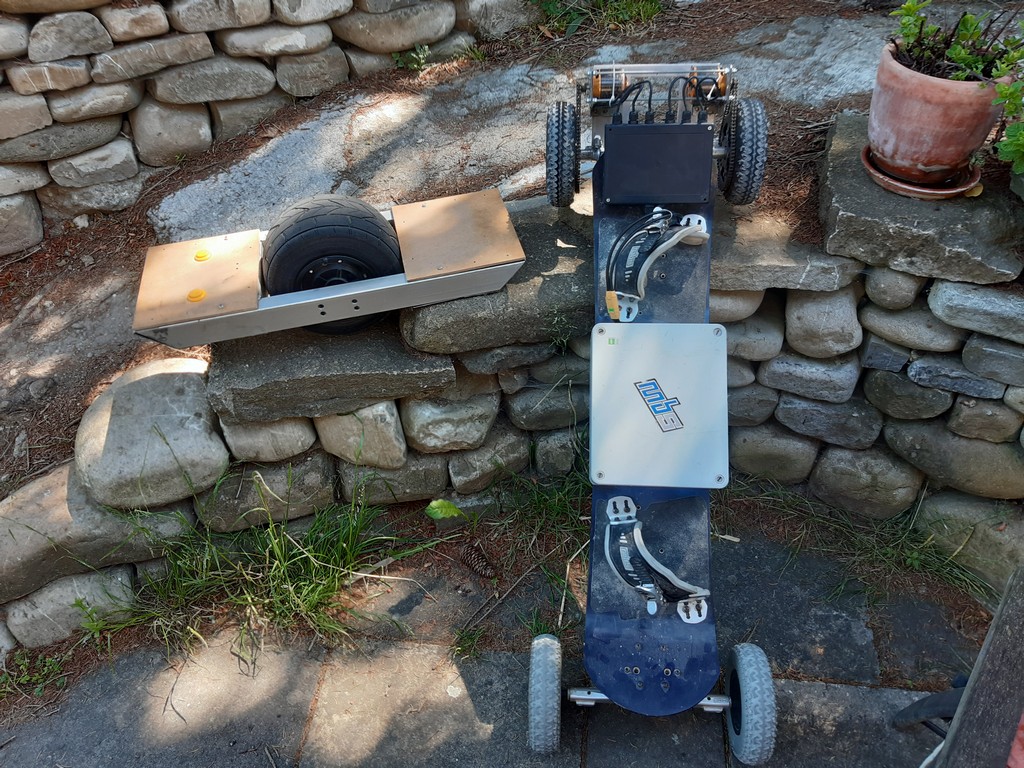

CFocer v2 now installed on 2 of my rides and ready for some testing.
Awesome, looking forward to hear your results :slight_smile:
I’ve got a CFOC2 in this ride now…
And hopefully I’ll get the other two in this ride in the next few days…
Large hubs can be tricky to control correctly with a vesc. I don’t use the detection wizard for them and I do manual detection. I’ve done up to 80A with my ebike hub motor so it’s just a matter of dialing in the settings
