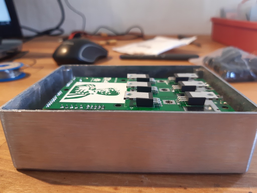

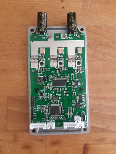

It really just fits these 1590B boxes (122x66) from ebay:
@Tamatoa
Thats a great idea, i did not think of that.
To be able to stack them we would either need a longer (>122mm) or higher (>45mm) case to acommodate the elcos.

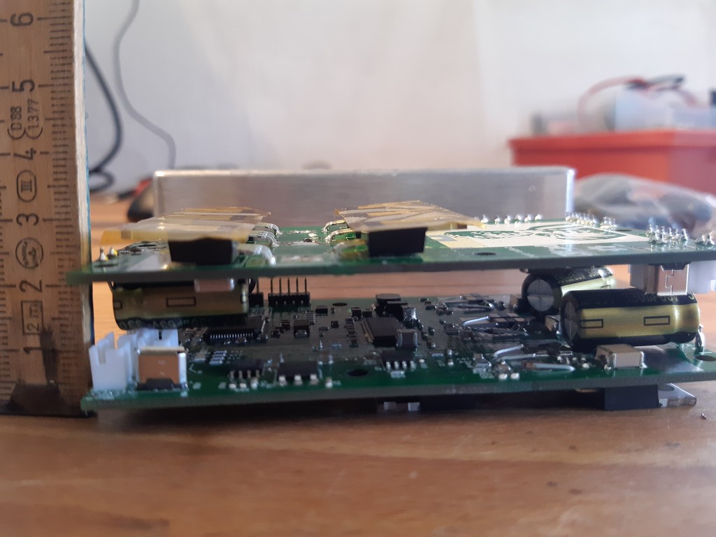

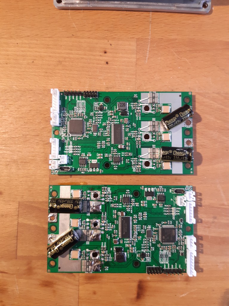

It’s too late for those caps, but it seems like you could leave slightly longer leads on the caps and then fold them back over the board to make it a bit more compact.
Alternatively, they sell lots of plastic spacers on Ebay to add a bit of height to those boxes.
You mean like the ones on the lower board?
It looks to me like the ones on the lower board are long enough to hang the caps off the end, but not long enough to lay the caps down over the board. With them laid down over the board I would think both boards would fit in the box - caps and all.
Now i get what you mean. This could actually work.
122 x 66 x 39mm sized dual esc for under 80$ how awesome is that!
Awesome find Doomy…
This was @Tamatoa idea and @ziploc for the folded caps.
118x96x39 and 415g with cables.

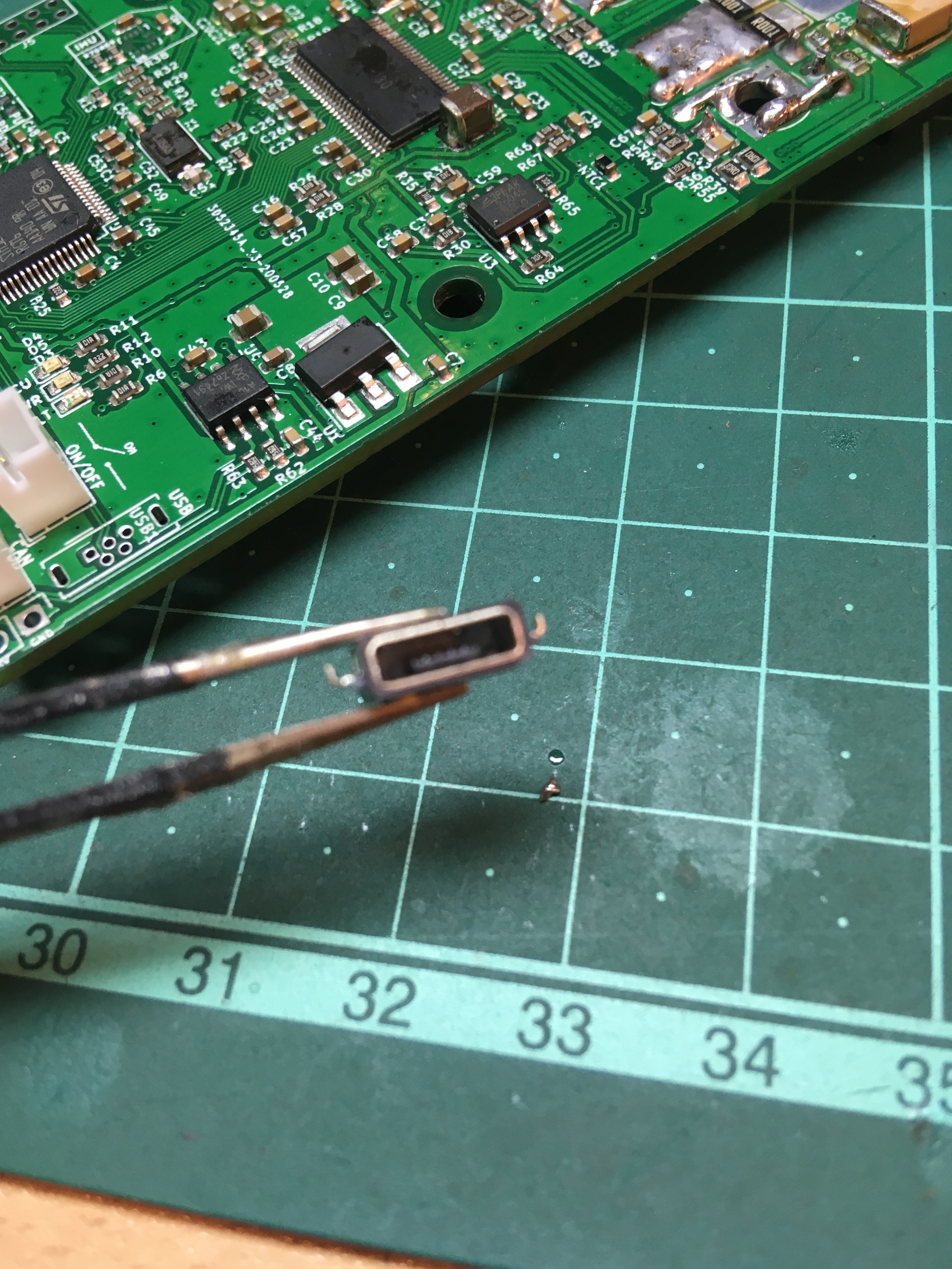

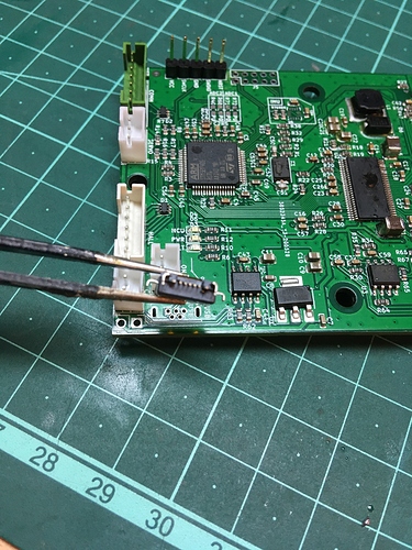

Hi, does it matter the orientation I place this part?
The one in the tweezers? If so that’s the BMI160 and orientation absolutely matters
Yep, what should be the correct orientation? Couldn’t find any reference in the assembly guide.
I also found out that the USB ports I received from LCSC will not fit in the FOCer PCB. What happened here? :disappointed:
@Style Referencing the CAD drawing you can see that the indexing point of the IMU is positioned to the south east corner of the board - if the north point of the board is where the Electrolytic Capacitors are.
I would wait to get confirmation from @shaman or any of the others that did assemble with IMU’s in place.
Edit: As for the USB - can you show me the Order confirmation from LCSC with the line item that you got for the USB. (keep PII obfuscated please).
