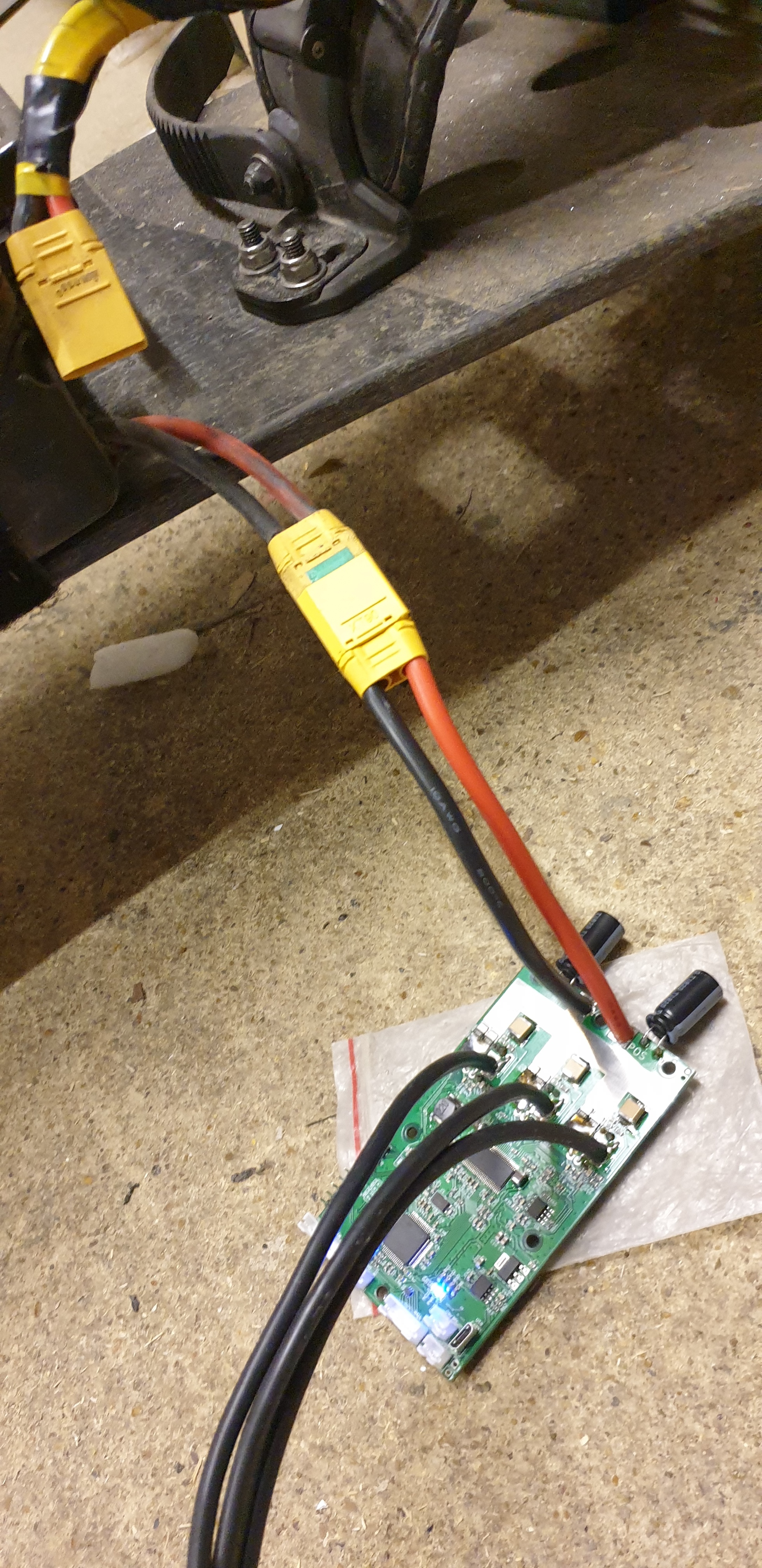

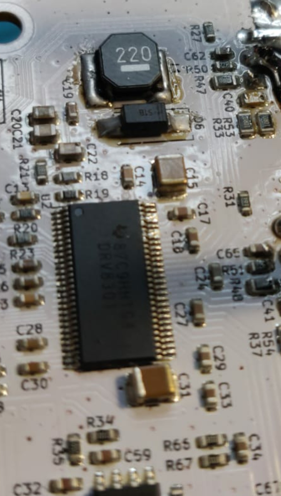

Ok guys so I have been running some tests on the focers with my funwheel. Everything works perfectly but…ah theres always a but…the electronics on the 5v rail run really hot and the heat increases with increased voltage input. If I power directly through the 5V rail, bypassing the main power supply and drv, its all cool, but if powered via a power source, the D6 diode and the L1 inductor immediately start to get hot, they are warm at 12V and as I increase the voltage, the heat increases to a 5sec-touch-only level. I have tested 2 focers and both have the same issue.
What Ive done so far:
The diode is correctly oriented
I have swapped it out for another diode
Reflashed firmware (correct one).
Changed inductor.
Made sure drv ground pad has enough solder on the bottom and reflowed it.
Nothing solves the issue.
Anyone else experiencing this?
@Lee_Wright @doomy
No but I can check mine…
Do these components get hot with no external load on the 5v circuit? Or just when you start powering devices?
Nope. Nothing else on 5v.
Heres the board
I’ll run mine in a sec and check

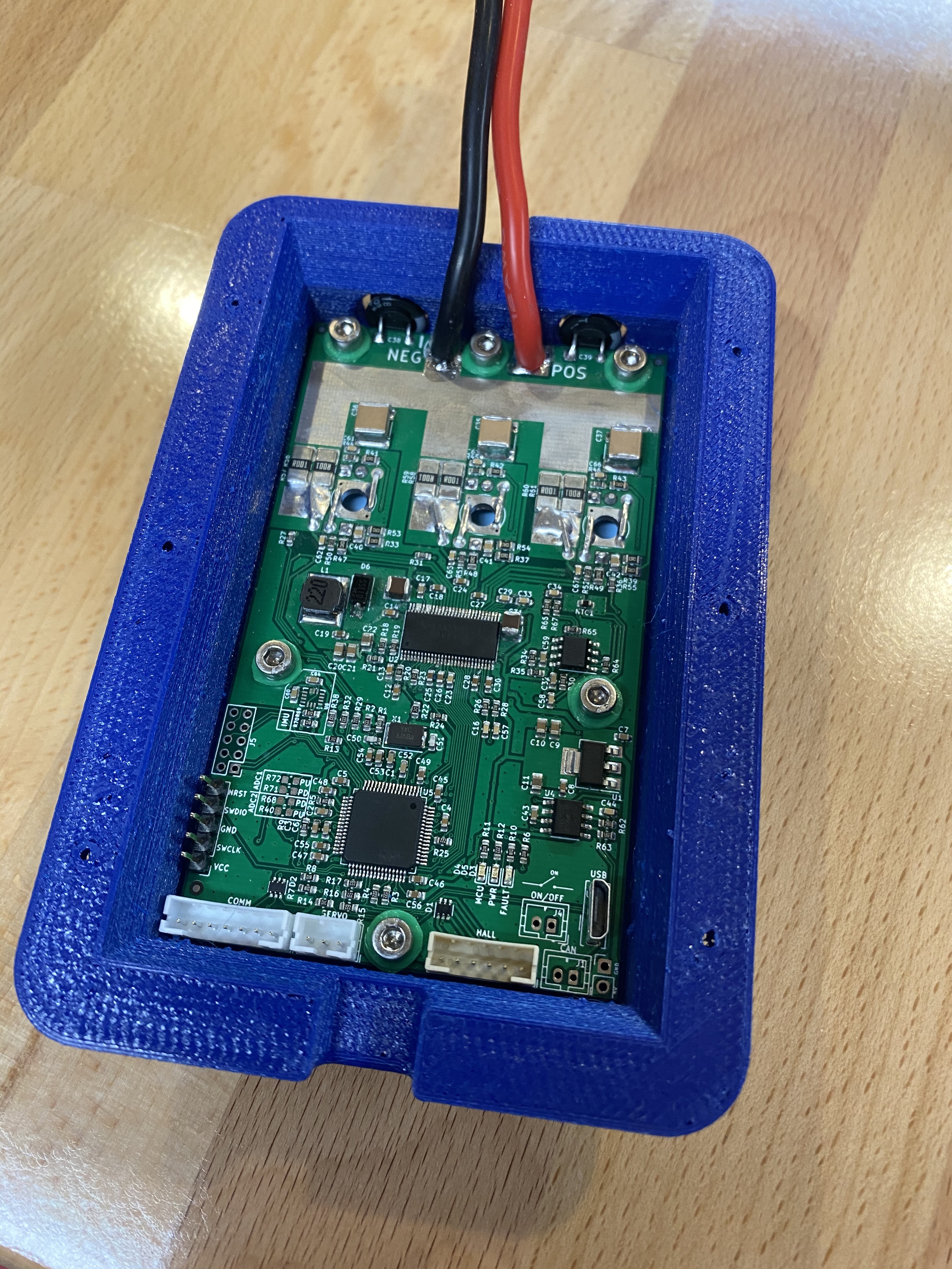

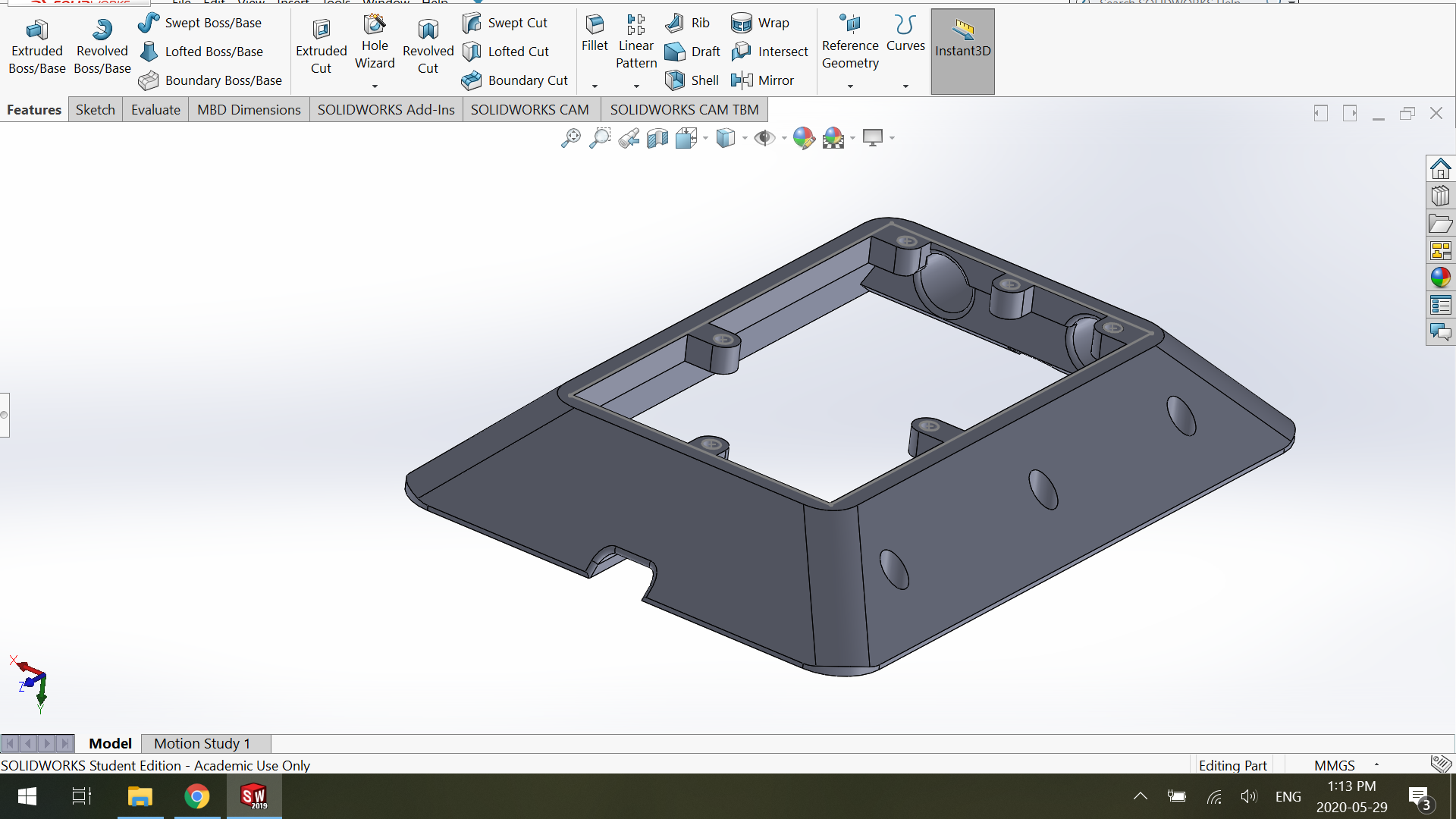

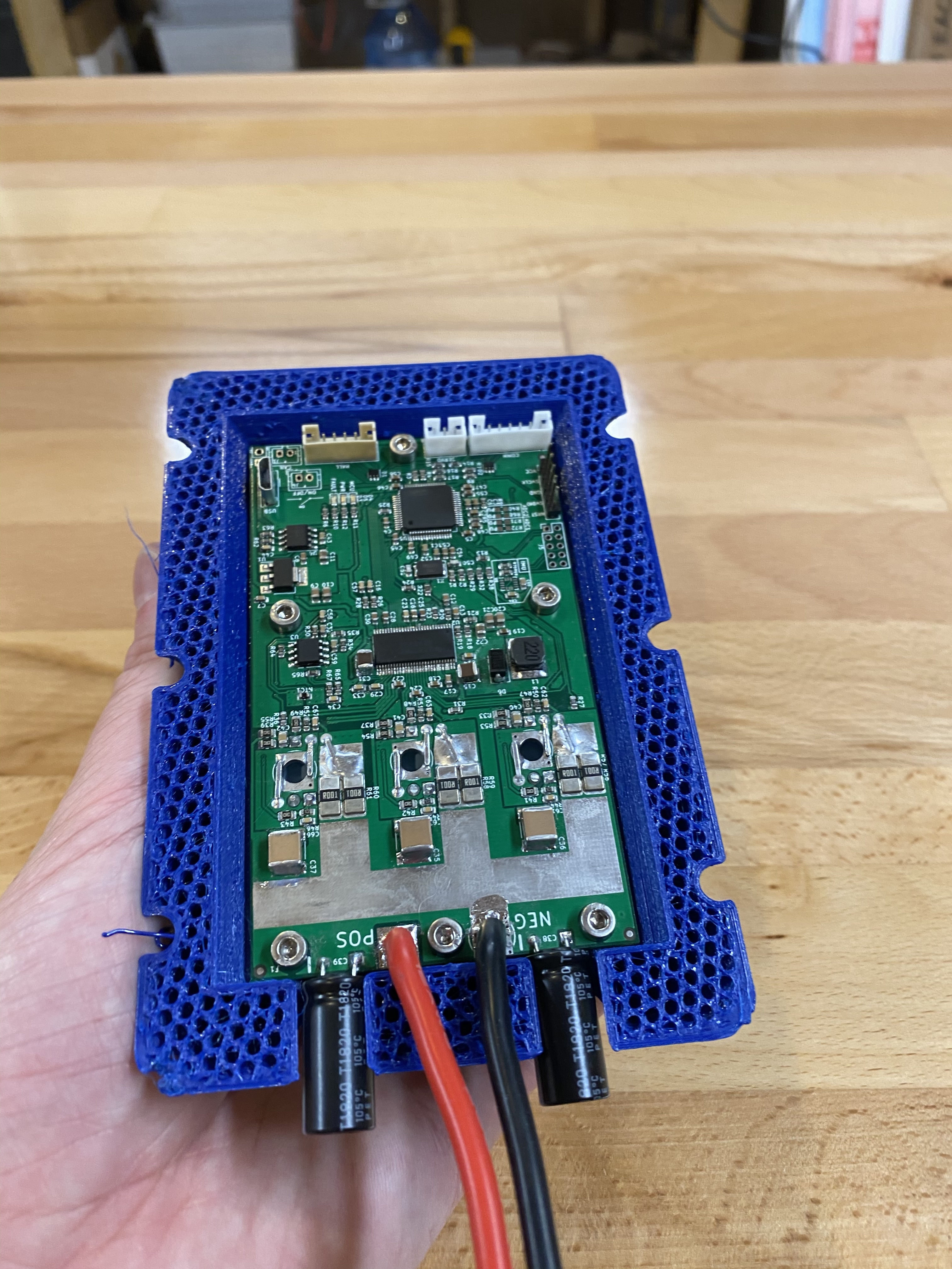

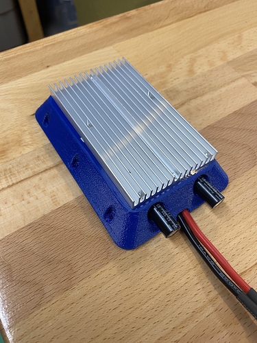

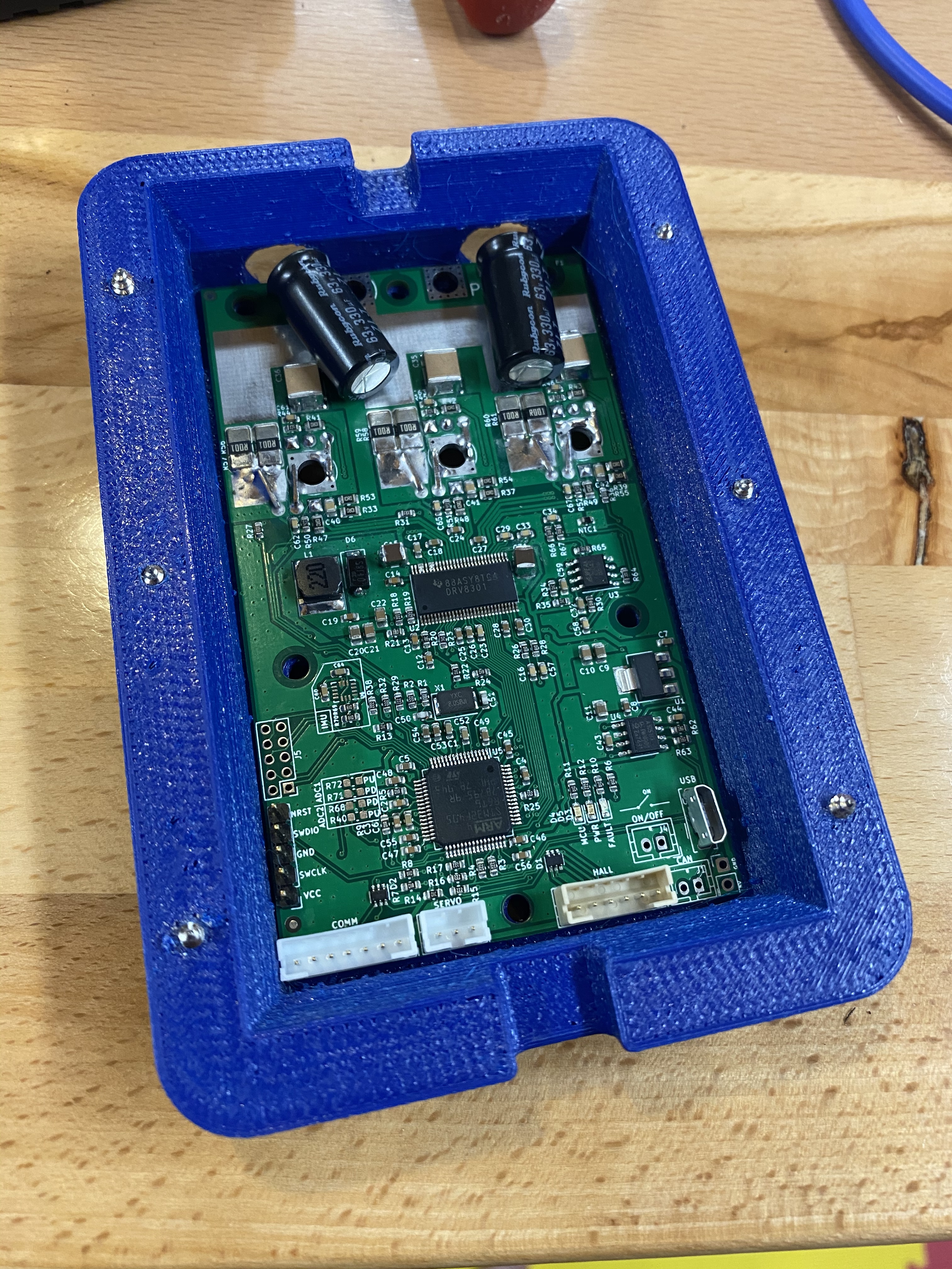

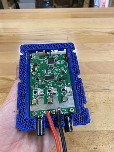

First partial test print. Everything fits. Caps need the holes slightly moved. Chamfer angle is way to shallow.
So I checked the two I have made and even powered for 5 mins there was no noticable temperature difference on that area
10S battery at about 38V
The steeper angle looks way better.
Plenty of room for a receiver and Bluetooth module.

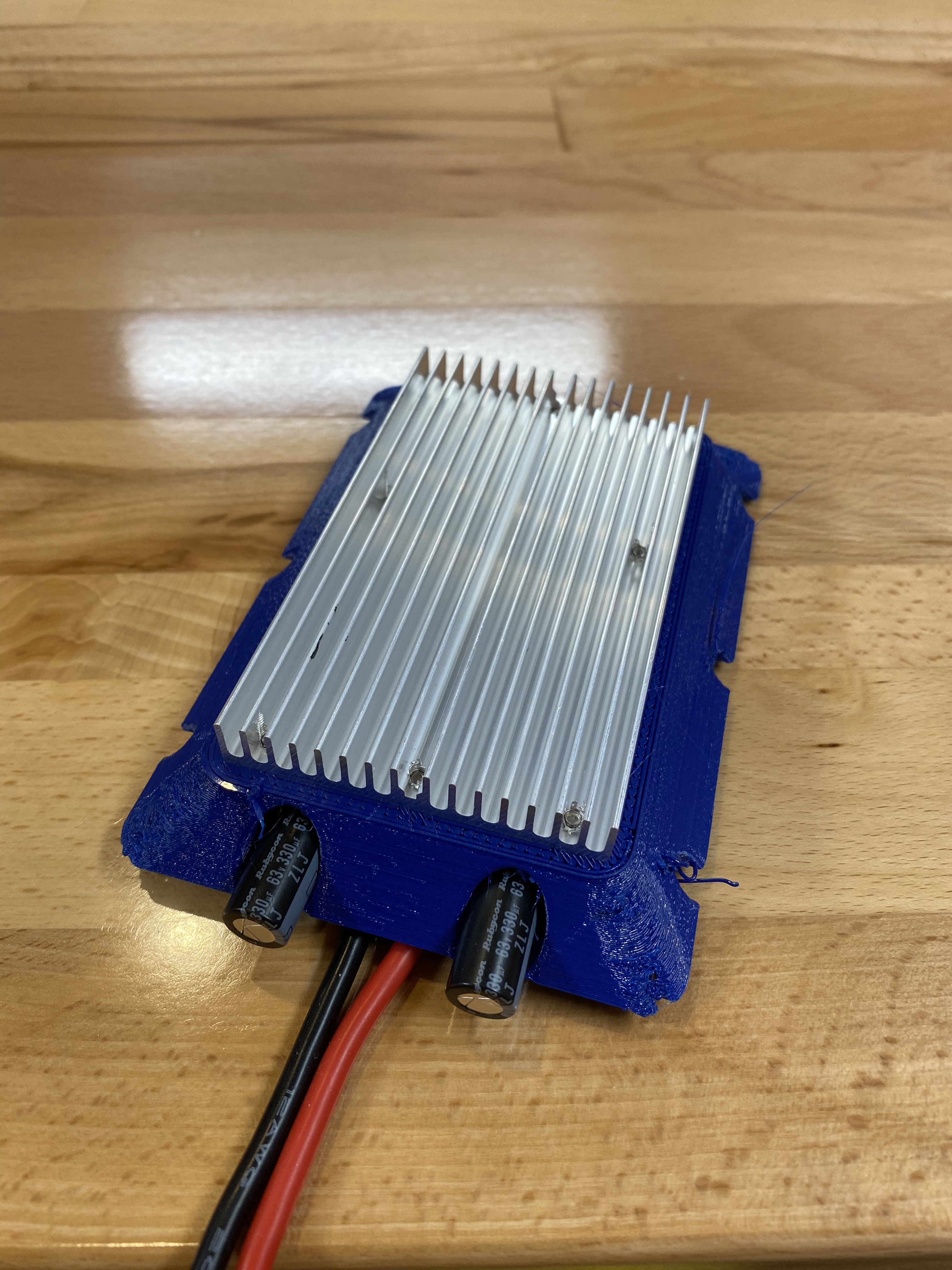

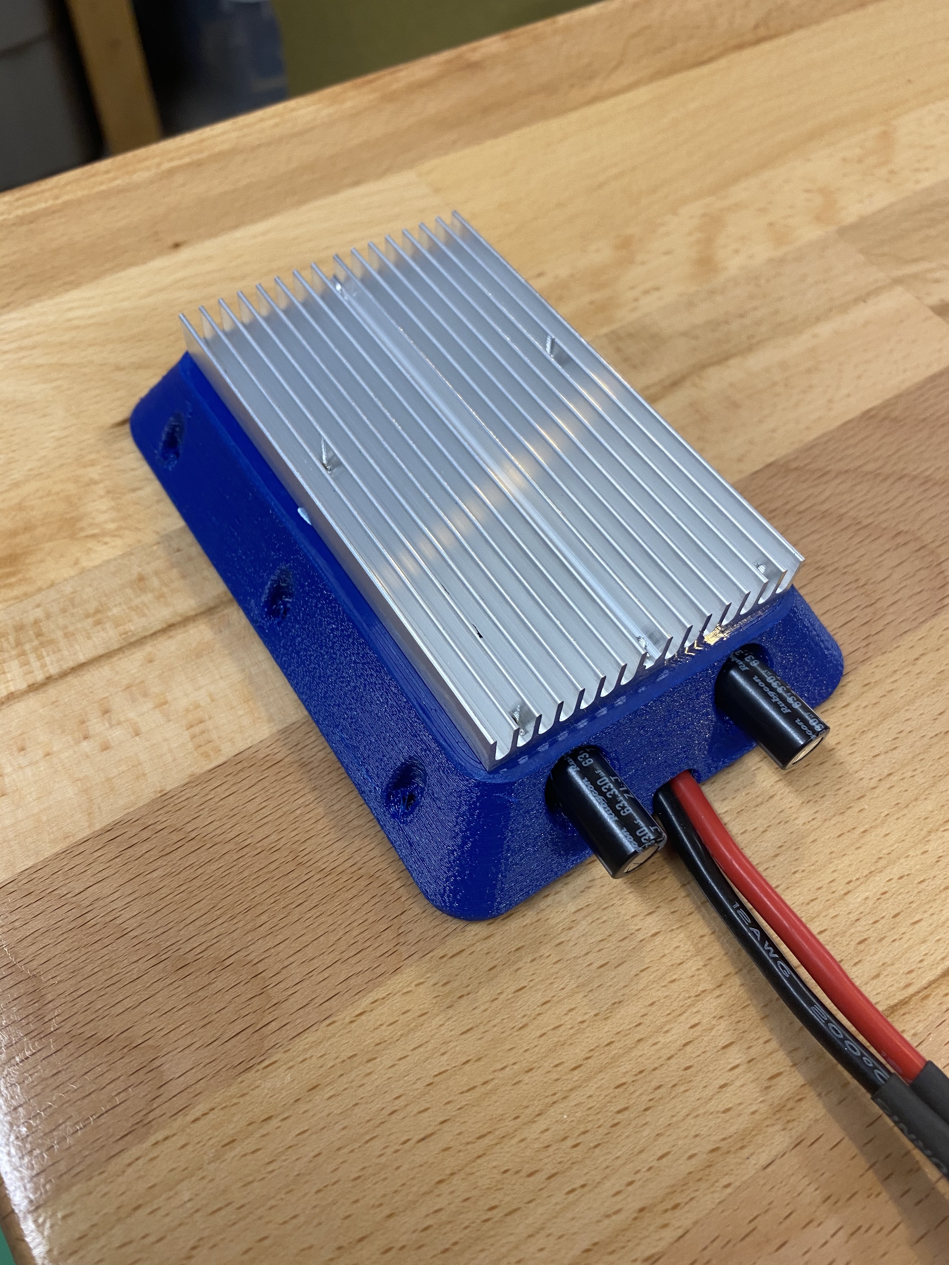

Didn’t like having the caps sticking out of the enclosure.
Is that in danger of the cap wrapper wearing through and shorting?
