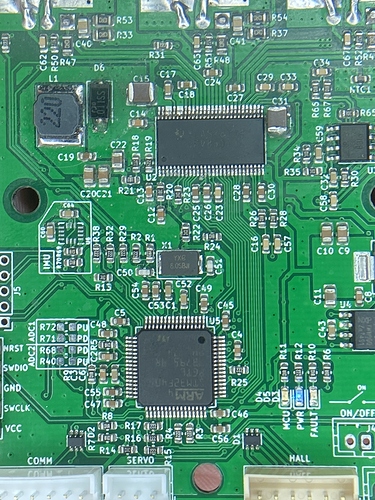

Yeah turns out keeping it on a shelf in my basement for two years didn’t do it any favours.
I have some fresh stuff on order to do the imu’s.
I grabbed the IMU with tweezers and mounted them one at a time in my little panavise with pads sticking up. I used an X-acto to spread a TINY amount of solder paste - aiming to really get light but complete coverage around the edges.
Then I remove them from the vice with tweezers and place them on the board. I then line them up very carefully with the tip of the X-acto.
Once the IMU is sitting on the board, I mount the board in the Panavise by its edge. This lets me hold the board horizontally - extended out over the edge of my desk. Then I approach if from underneath with the hot-air.

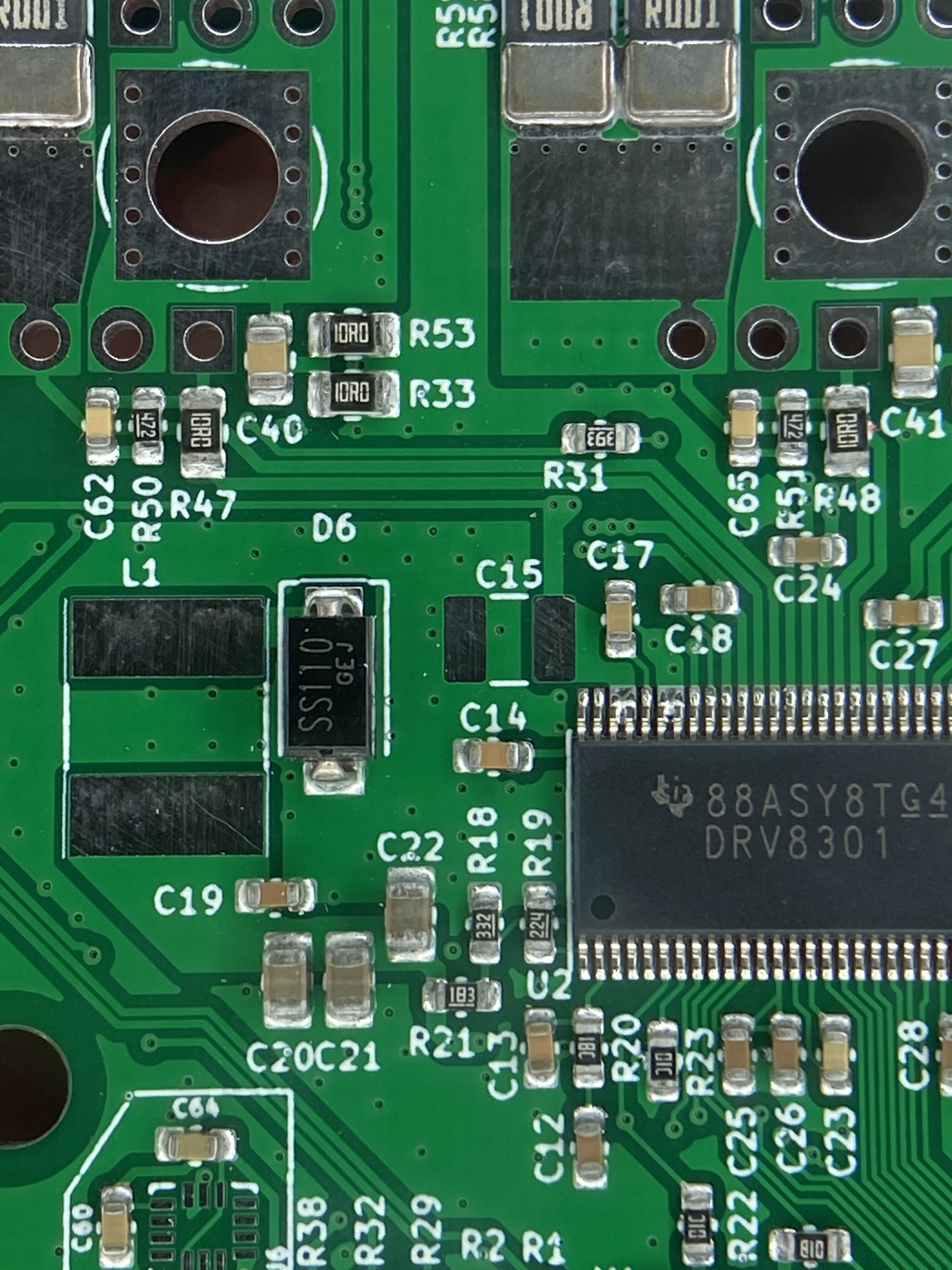

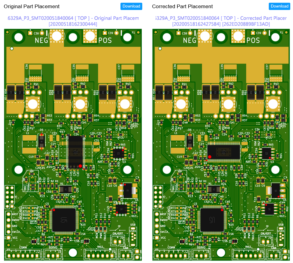

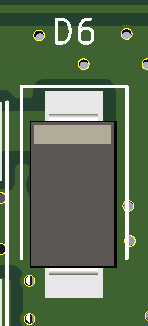

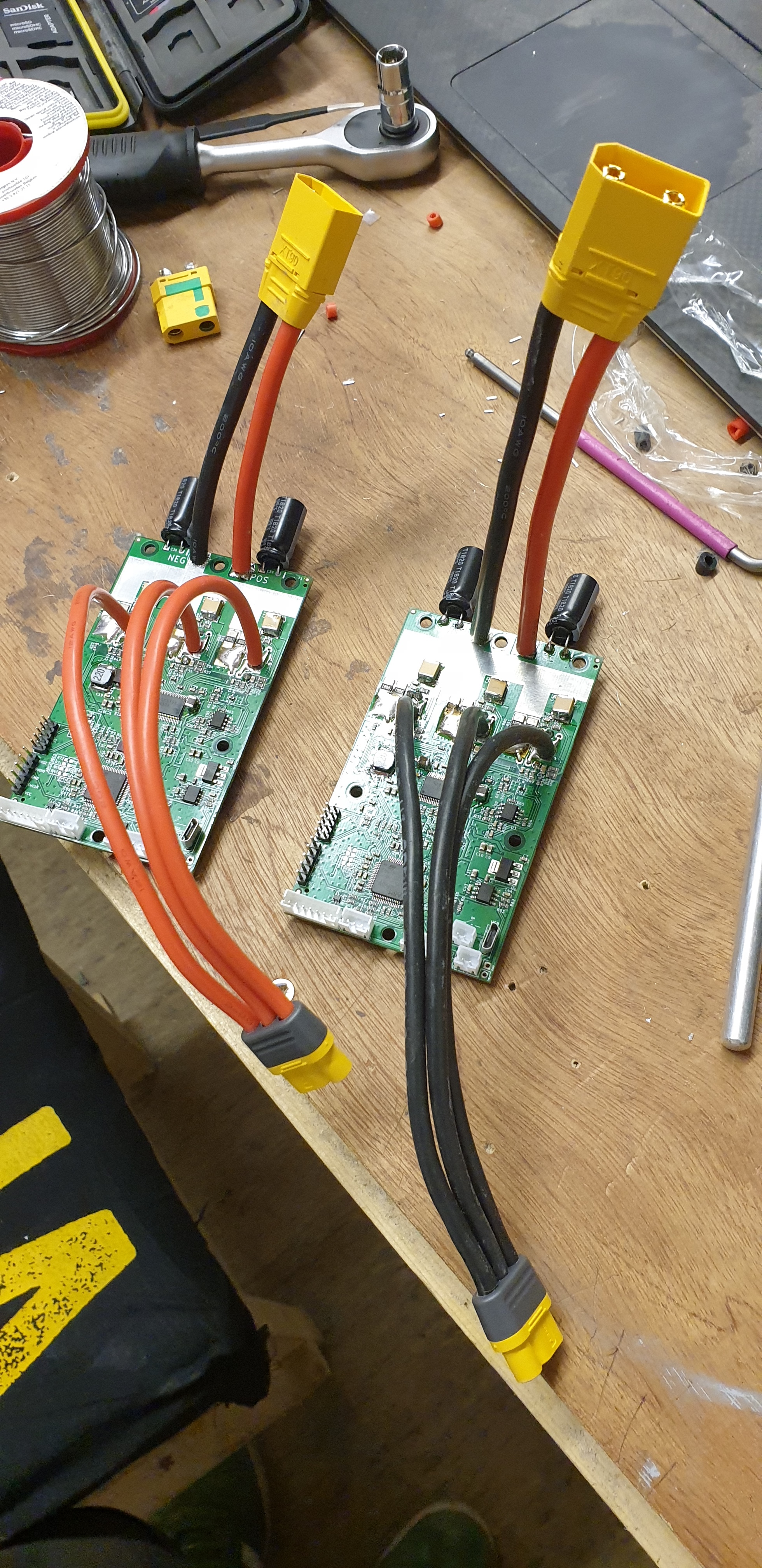

Just an heads up to others. JLC soldered my D6 shottkys the wrong way. I figured that out when my first board didn’t power up.
Thanks Georg,

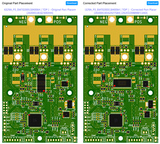

Hope they did it right with the 50pcs i ordered. It looks good on the corrected placement image.
Really not in the mood to turn around 50 diodes :sweat_smile:
Yours seems to be corrected “correctly”
Where do I find in their website how they corrected my order? Just placed mine yesterday.
Order History -> [DFM Analysis]
Thanks, found it.

Turns out I rushed to blame my expired solder paste.
All my boards have D6 flipped.
A bit of soldering later and I have success.
Uh oh…
So this is the second time this has been reported. Sounds like I need to make a JLCPCB-specific position file.
They don’t use the IPC standard position format but have always seemed to figure it out in the DFM review…until now
Yeah probably worth making a custom file so they get it right every time.
