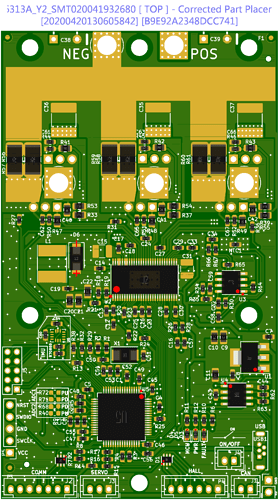

@shaman thank you for all your help in getting yhe the pcbs and components right (hopefully).
Just got these in the mail. The fets have been delayed due to…you know what…but looking absolutely gorgeous.
Heres some pics and size comparison with the vesc 4 aka expensive focer.
The repo has been getting reviewed and adjusted this past weekend by a few volunteers from this community of who I’ll give credit to after release and after I have their permission.
It’s really starting to look good btw…
Question space-wise.
Is that kind of standard from JLCPCB, because it looks like you could shrink it down a lot and safe some space?
The PCB is 2-layer w/ all the SMD components on one side. This ultimately causes the PCB to be the size it is. The VESC 4 is 4-layer and double sided which allows for the size to shrink but this is much more expensive. The absolute smallest I could get the CFOC2 PCB is about 50mm x 100mm. Of course you’re more than welcome to try and shrink it down yourself after I release the design files.
Ahhhhlright, i see :slight_smile:
I´m not an PCB expert, so others should see what they can get out of it, but i think you did an awesome job sofar!
I´ll see if i can build a few for some cheaper builds later on.
:+1:
Yeah the whole 2-layer and mostly single sided design decision is to facilitate low-cost and to maximize assembly from JLCPCB.
My corrected part placement looks ok, but it looked ok to me before it was corrected too lol! The only incorrect thing i noticed was the DRV lol!
Cool. Yeah JLCPCB is good about correcting part placement in their “DFM review”.
