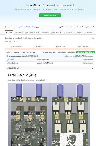

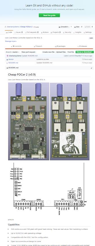

Yep. And even all the stuff needed to order from JLCPCB and LCSC is done. Lately I’ve just been working on material that guides you through the ordering process. I’ve got all of this uploaded on a private GitHub repo and I’m having a few people review it before I release it

Just a teaser showing that I’m not BSing

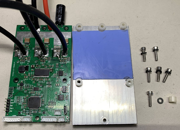

I’ve been giving some though to securing the transistors to the heatsink.
I wonder if a 3d printed clip would work well or if nylon bolts would be a good option if pressure alone doesn’t work.
Edit: Looking back this is not an issue at all as they are sandwiched between the board and heatsink. Disreagard.
Yeah the whole idea is that the PCB itself is used to compress the MOSFETs to the heatsink. You get the same benefit of spring clips.
For some reason I had it in my head that that was not the case. Spent way to much time thinking about a way of pressing them against the heatsink.
And then I went back and looked at the assembled pictures.
I’ll just wait till I have one of these in my hands before I start thinking about making accessories for it. A 3d printed enclosure should be easy enough.
I’m working on a document that explains assembly including hardware assembly with the heatsink. That document should help people understand how exactly the mosfets are getting compressed to the heat sink
You need to recommend adding drops of thermal compound or thermal stickers in between, to enhance the cooling :snowflake:
yeah that’s part of the assembly bro

Integrated On/off switch? Stop teasing lol. JLC is going to be backlogged the day you open up the repo on GitHub.
