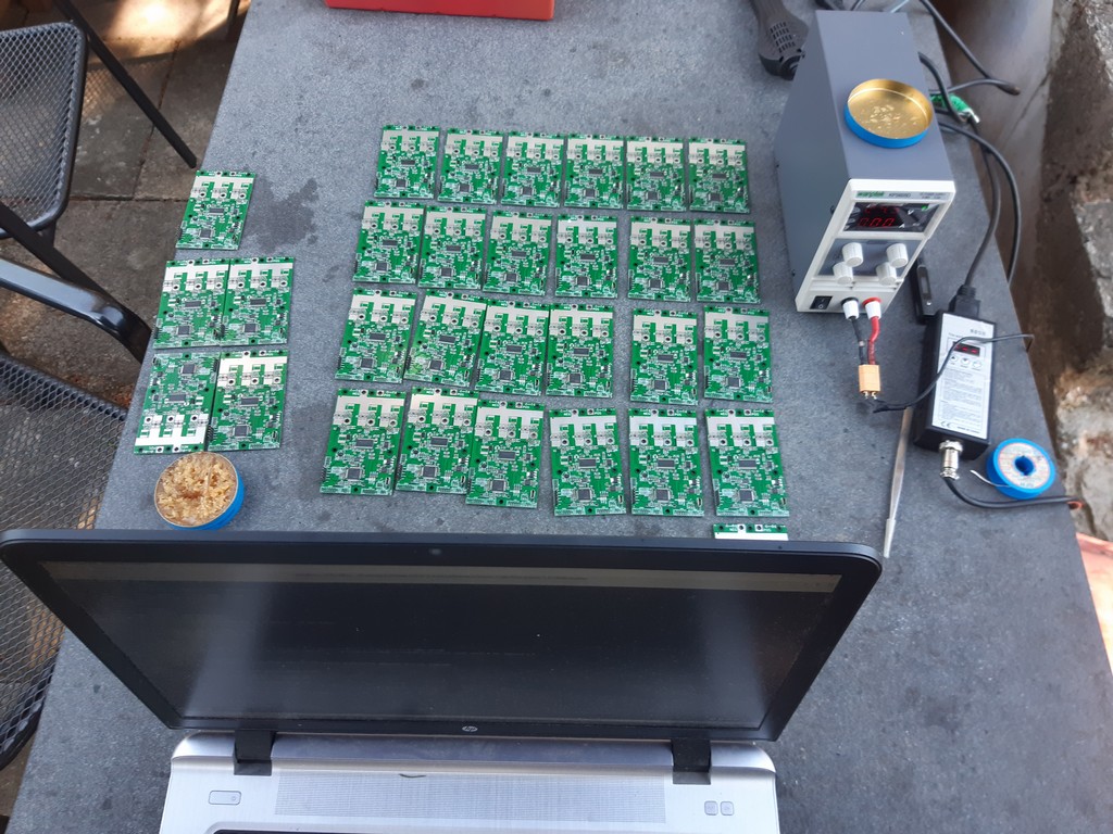

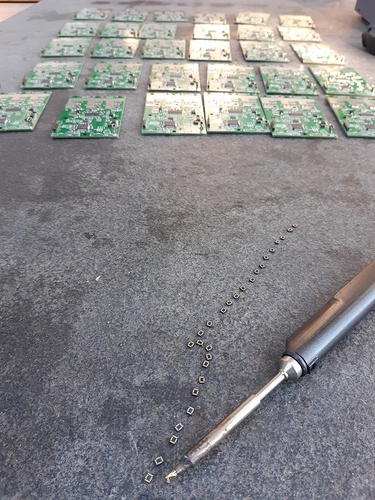

Testing and soldering the IMUs, practice make perfect, well almost. Right the good ones left the bad ones:

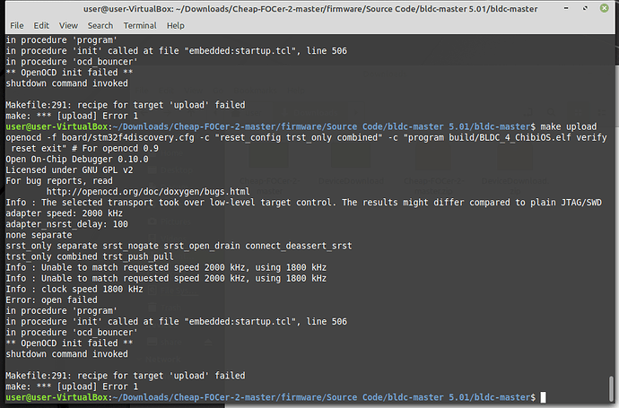

I also found another bad focer thats not willing to be flashed with the STLink… Maybe the STM chip is broken. :confused:

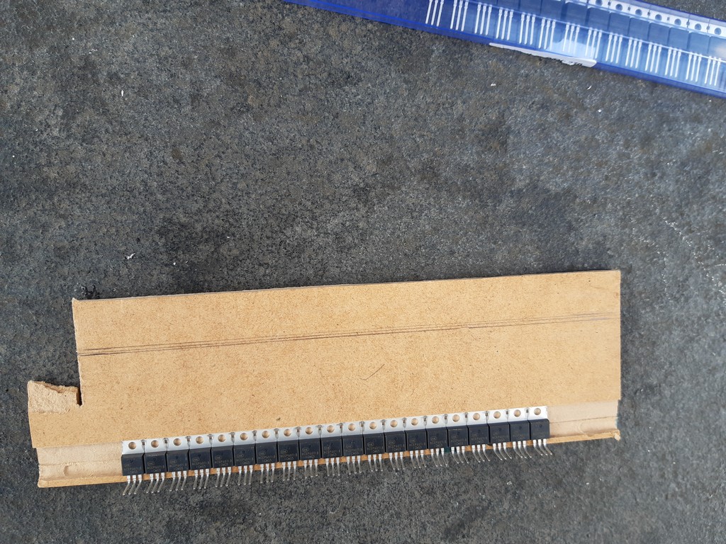

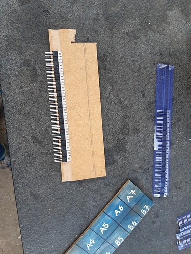

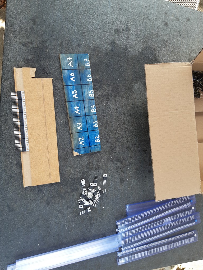

Bending MOSFET legs was a breeze tough, thanks to the bending jig it only took me around 15minutes. Well, making the jig took a lot more time :upside_down_face:
@doomy your a legend. I hope enough people tipped you for your hard work :wink:
Thank morpheus!
Some statistics, i got 49 of the 50 IMUs working. One flew away while i wanted to grab it with the pincers, it probably fell on the ground somewhere never to be found again.
Out of the 50 boards from JLCPCB there are 48 in working condition (i tested only the IMU/MCU by connecting them to VESC tool).
One was damaged visualy (burned traces) and the other has a probably broken MCU. I tested the programming leads.

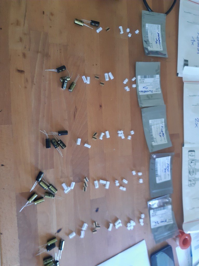

Sodlering more SMD components:
can I suggest keeping all the PCBs and components on something clean, don’t keep glasses of liquid on the same table you’re working on, don’t stack PCBs on top of each other. I’m sure I’m missing some other things but you get the point :+1:
Sure you can, do you also want me to wear a antistatic braclet and wipe my iron every time i touch something with it ?
nah just keep doing what you’re doing :v:

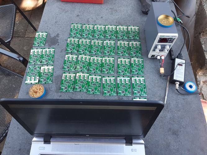

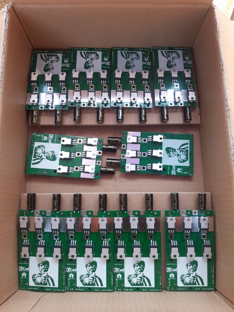

I finnaly finished soldering all the FOCers :slight_smile:

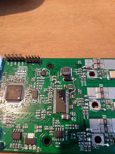

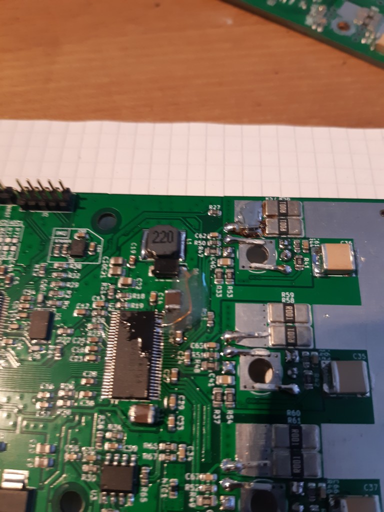

I also managed to repair the broken unit with the lifted traces and used the time to install it to my onewheel.
When testing the powerstage for the first time the motor would not turn and there were some trouble with motor detection. I also noticed the voltage was way off (71V instead of 44V). I expected the worst. Flashing the precompiled 5.1 file via vesc tool luckily solved the problem.
I think something is wrong with the firmware i compiled. So you should flash your FOCers with a good firmware before using them.
Also i leave it to you to beef up all the mosfet connections (front and back). You can easily do that before and while installing the wires.
