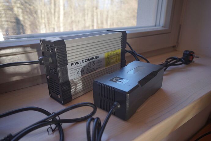

Can anyone here explain to me why esk8 chargers are so huge? Do they scale in size with power, or current? i.e. would it be worth going higher in voltage to get a smaller charger? Or perhaps by paying more you can get a charger with more energy efficient components that results in a smaller overall package?
I’m just quite upset at how much larger my 16s 5A charger is compared to this 10s 5A one:
Would 18s be even larger? What voltage would be the best to optimize charger size per power?
This thread would also be a good place to share any small chargers people have found. Maybe making your own is the way to go?

I’m no expert, but I would assume that the key aspect of a charger is cooling, hence why the case is big, so they can add a fan, and in the case of your 16s charger, a big metal case that acts as a heatsink.

I would guess it’s poor engineering, why devote a lot of resources to make something really compact when making it larger it’s easier, you can share a PCB and enclosure between a bunch of models
On the other hand there is the Grin Satiator that is really power dense, they put the resources to develop it, and due to that it’s expensive
I’ve noticed the ones without fans are much smaller and much quieter. Not sure about non-10S options though.

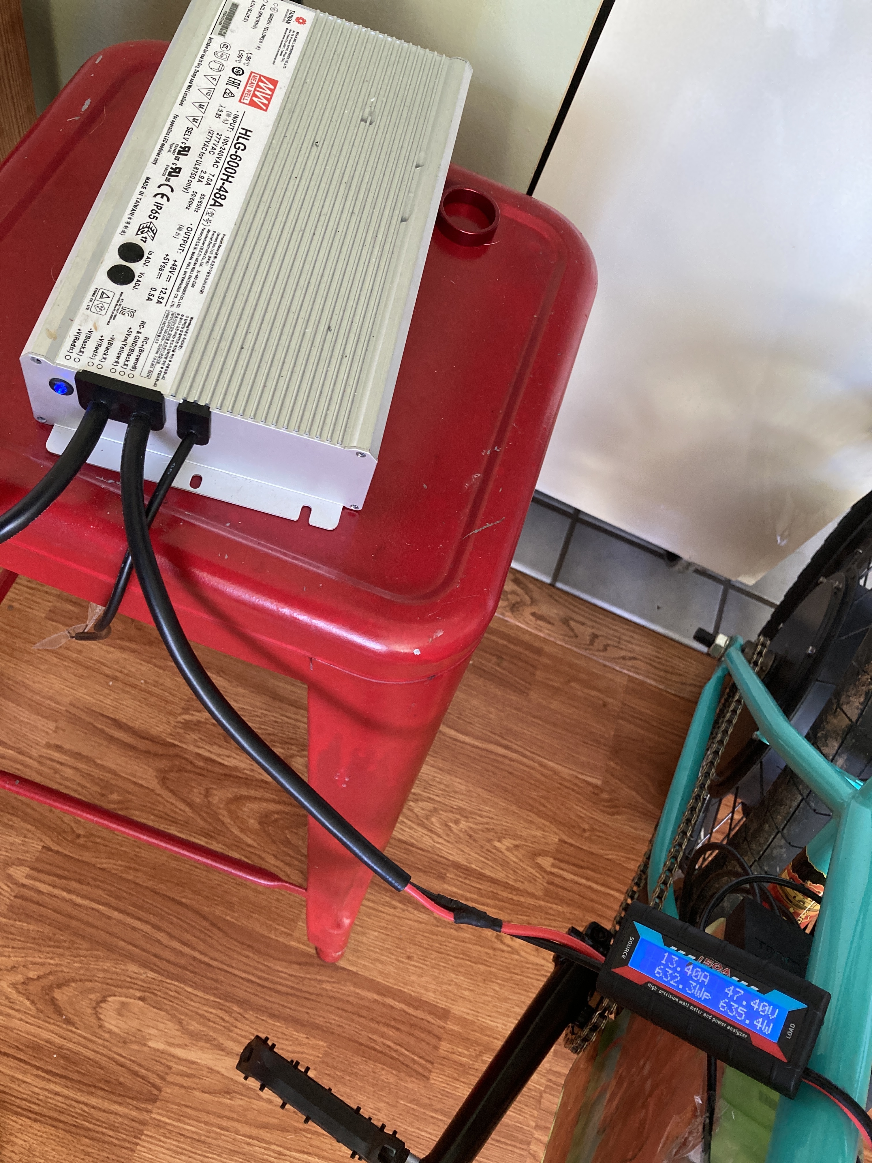

13 amps but so big.
I’ve been on a hunt for the smallest high power supply out there. The meanwells are easily alterable and relatively cheap. Wonder if a small one could be liquid cooled and altered for high current…something like adding ice. I don’t know much electronics but was told there’s more than just cooling needed for higher current.
