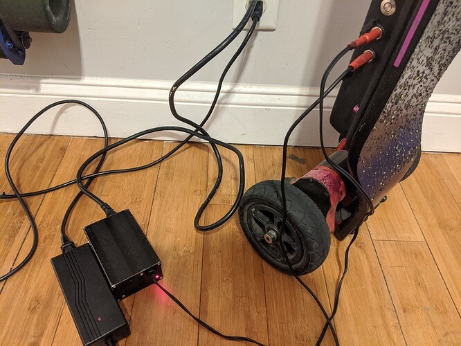

The easiest way I found to go “smaller” with chargers is to dual port charge with lower amps.
2 of those TB 4.5A chargers for 9ish amps and is way more portable and lighter than those chunky ass chargers. Not really sure how that would scale for higher voltages as I did this for my 12S board.
d9bb9957f1005b016062d4c03cc1abd5156bb0b2_2_666x500
@kevingraehl has been doing that for 6 months now without issues (using 3 chargers), but there was a thread a while back explaining why with some chargers that might be a bad idea.
For the record, I sometimes use 2 chargers on the same BMS & battery and haven’t had any problems either.
It does make me nervous leaving them both plugged in when they’re green though. I typically only do that if I’m waiting for the charge to end, which also means it’s unlikely they’ll sit for a while on green.
As long as they’re charging and red, I don’t foresee any problems.

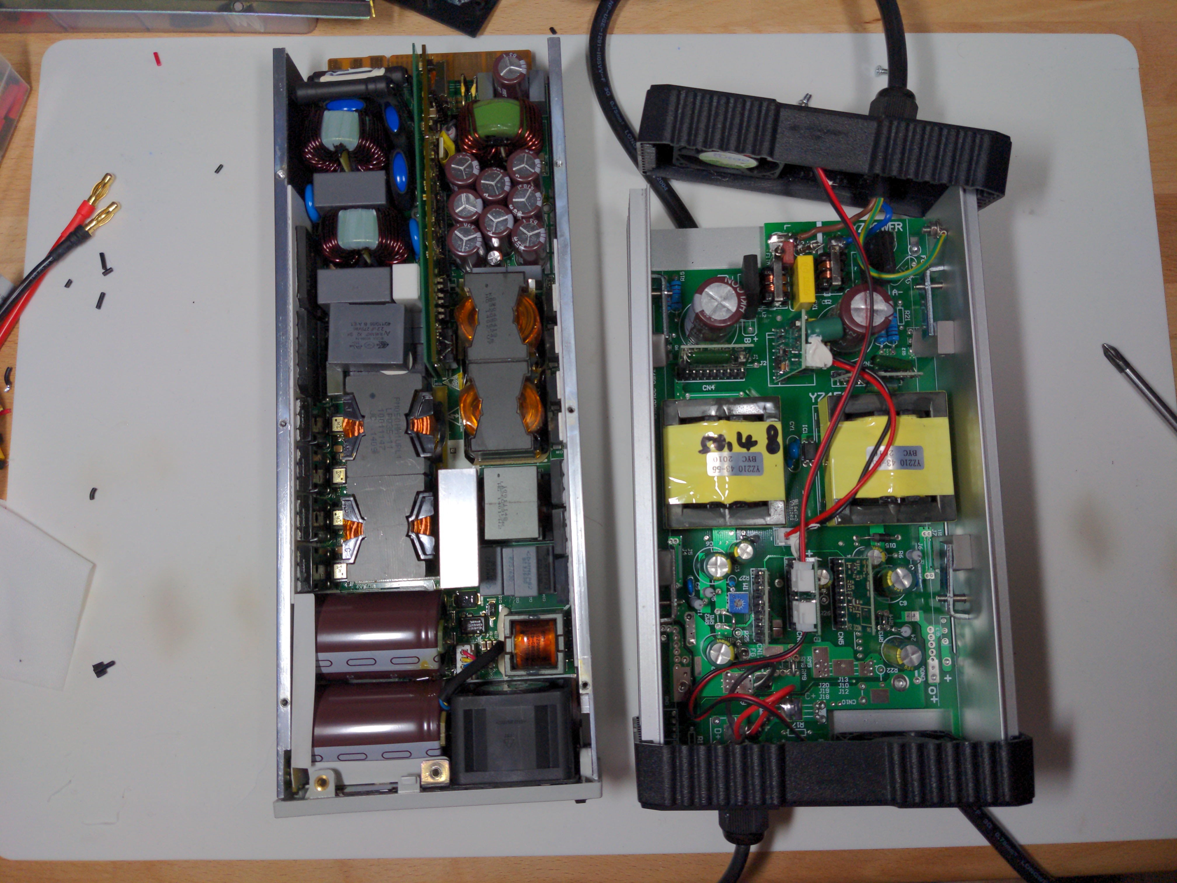

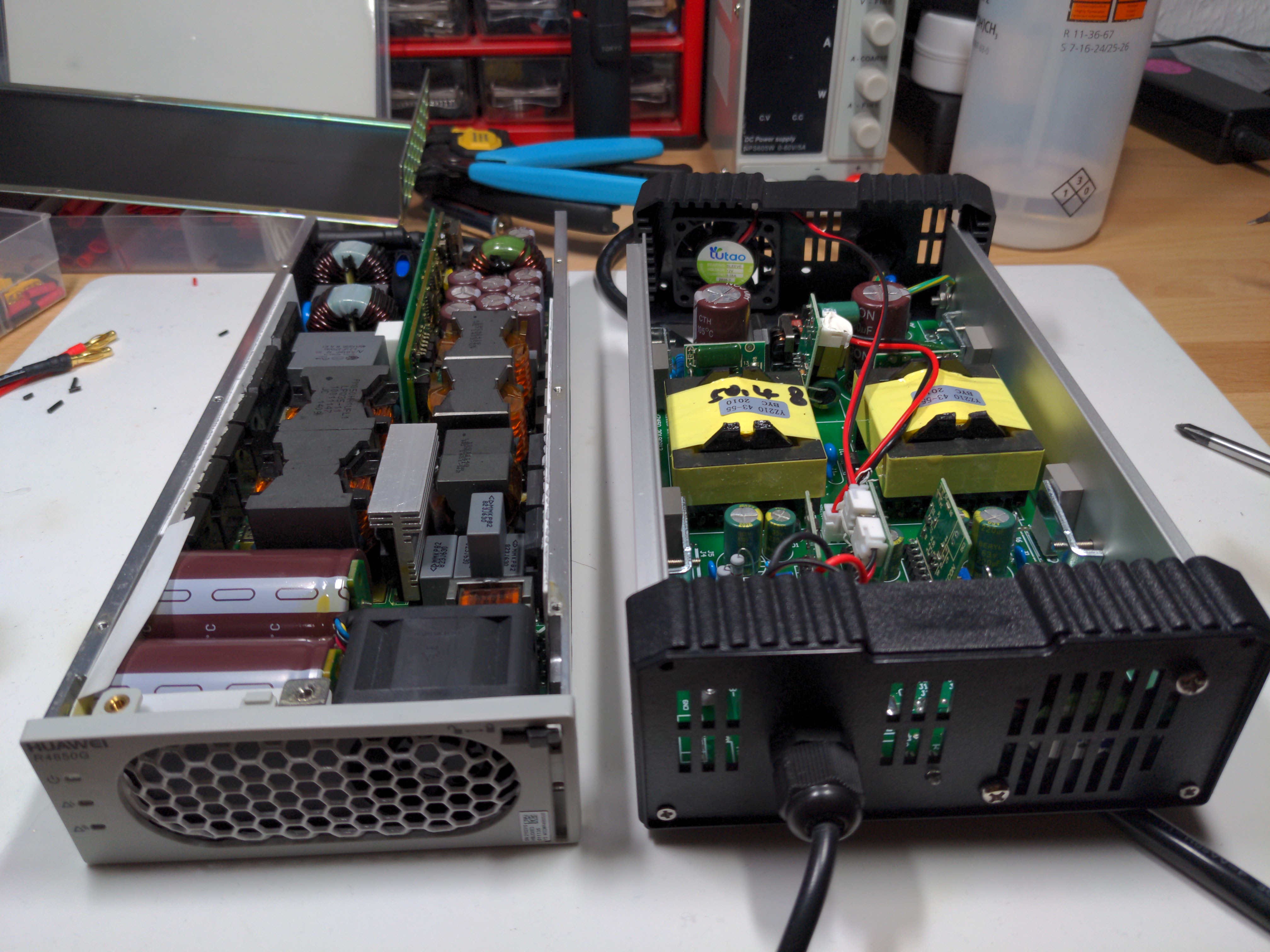

Here is a component density comparison between Huawei PSU and a 50.4V 8A charger…
I think it speaks for itself xd

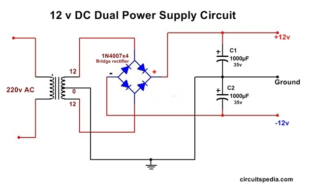

Here’s technical explanation, anyone correct me if I say something retarded :sweat_smile:.

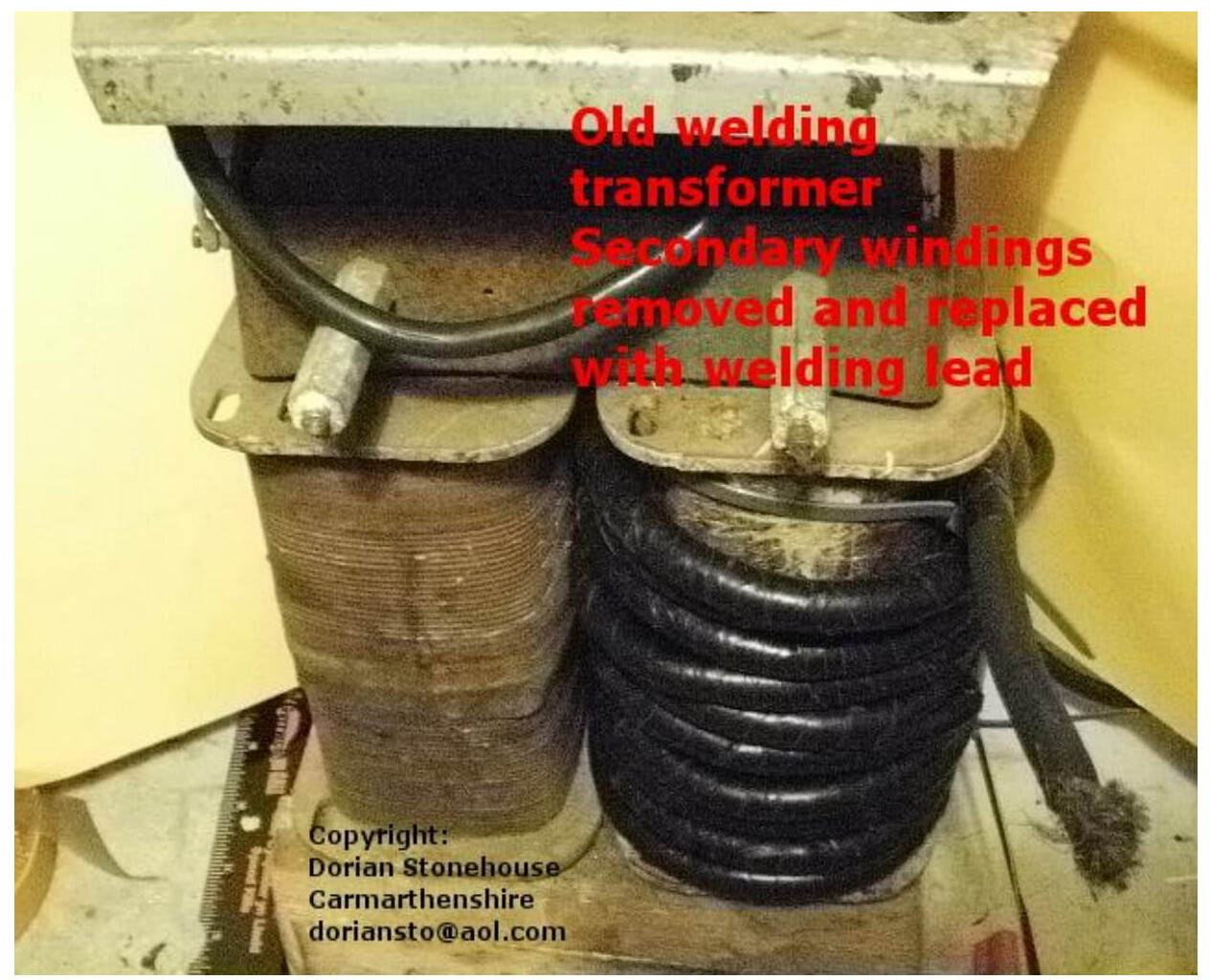

Back in the day a standard AC-DC power supply was one transformer (output power was dependent on the size of the transformer and windings), a diode array, and a capacitor to smooth out output.
While they are decent, they have problem of being bulky, heavy, needing lot of copper for the coil alone:
having not so great stabilization and main disadvantage, not having variable voltage output and curren’t control.
Here’s and old arc welding coils with some chunky windings for high power use, there are variable power ones that have many times more windings

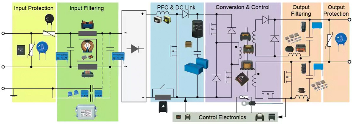

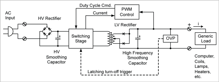

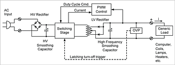

Nowdays most of the power supplies are switch mode power supplies. Why? Because they can be more compact and lightweight. Instead of using one large transformer at the start you can go straight to rectifier and use smaller coils, Voltage can be changed using one potentiometer, current can be controlled quite easly (good luck implementing that into reguler AC-DC power supply without solid state devices). Here’s couple of images of bare minimum and regular switch mode power supply:
The extra stuff you see at the start and at the end of schematic is mostly to make sure that the output is truly stable. Cheaper and smaller power supplies aren’t as stable due to lack of stabilization, bad capacitors etc. (I have lost so many hours on debug just because of some cheap shitty switch mode power supplies having really bad stabilization on output).
So yeah, good power supplies aren’t going to get smaller. However have tinkered with idea of making my own AC-DC power supply with specific current in mind, for esk8 use. As long as it stays specific it should be smaller in size Safety is huge concern however that I haven’t adressed.
Getting cost down for the chargers is the main prio. Most of them use double/single sided PCBs, which means the parts that you can actually make dense (which are a very small part since coils and caps are huge and already take up so much space, + w/e isolation they might need) is impossible.
Last post pokes best on why chargers look the way they do. If you were to feed your charger a DC voltage you could get rid of the rectifier stage making the design less bulky. But most of us have AC in our homes.
