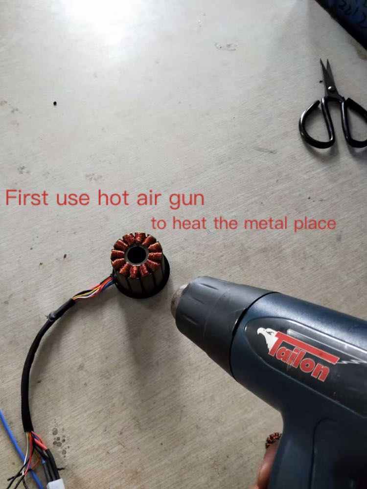

Careful with heat, you really don’t want to delaminate the windings.
That would be a bad day.
Yeah, but if it’s epoxy only a bit above 100°C would be enough, I only have a hairdryer as source of heat anyway
I was looking at my motors again and I think there is a chance that it’s held only by friction, that would be a pain to remove
Friction fit would be rather difficult to remove.

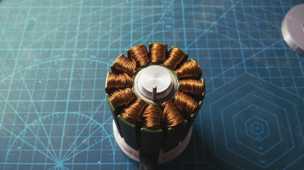

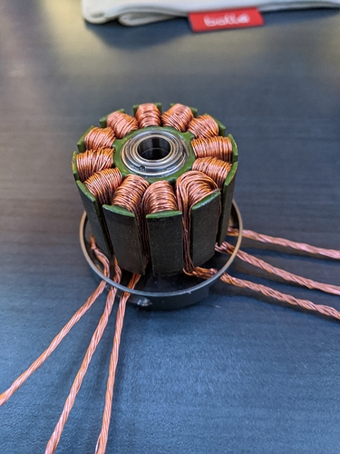

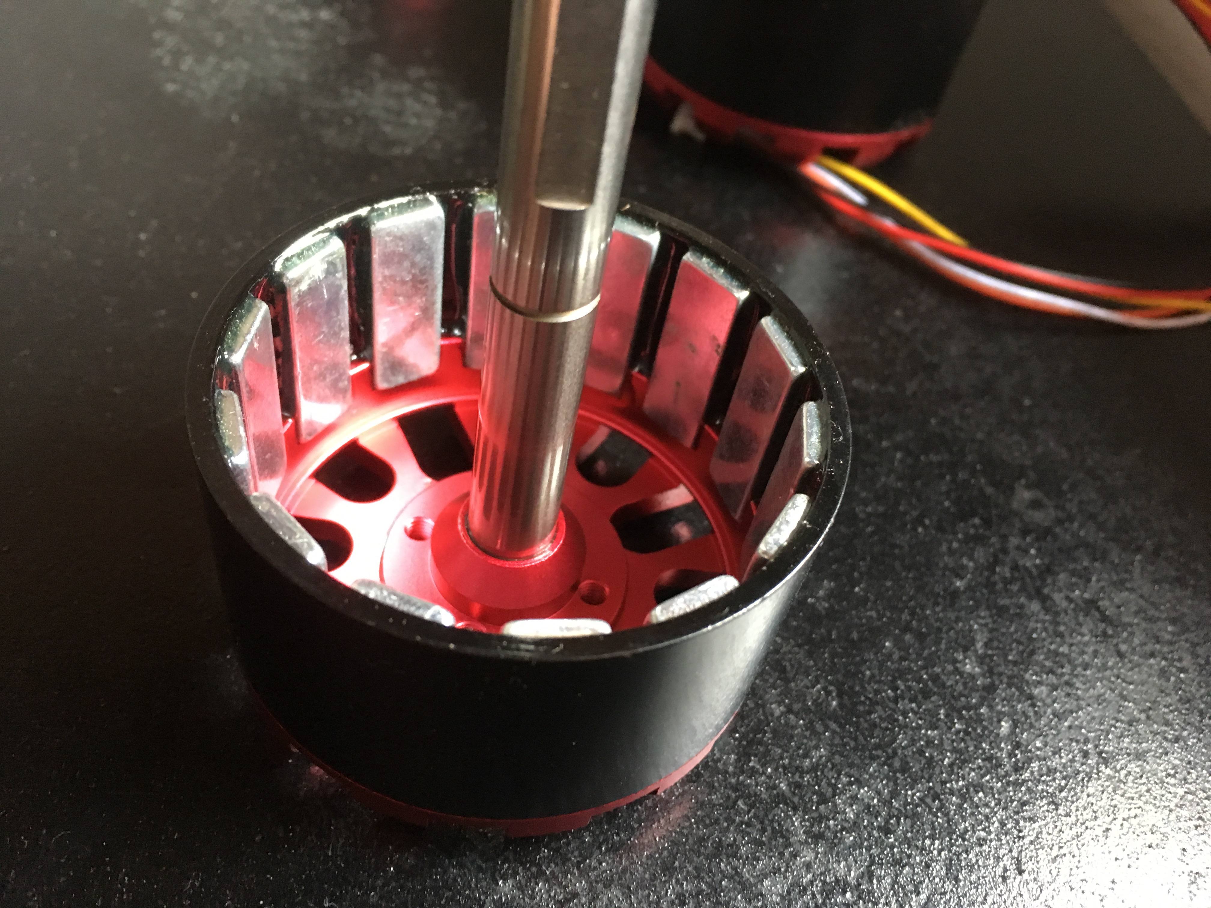

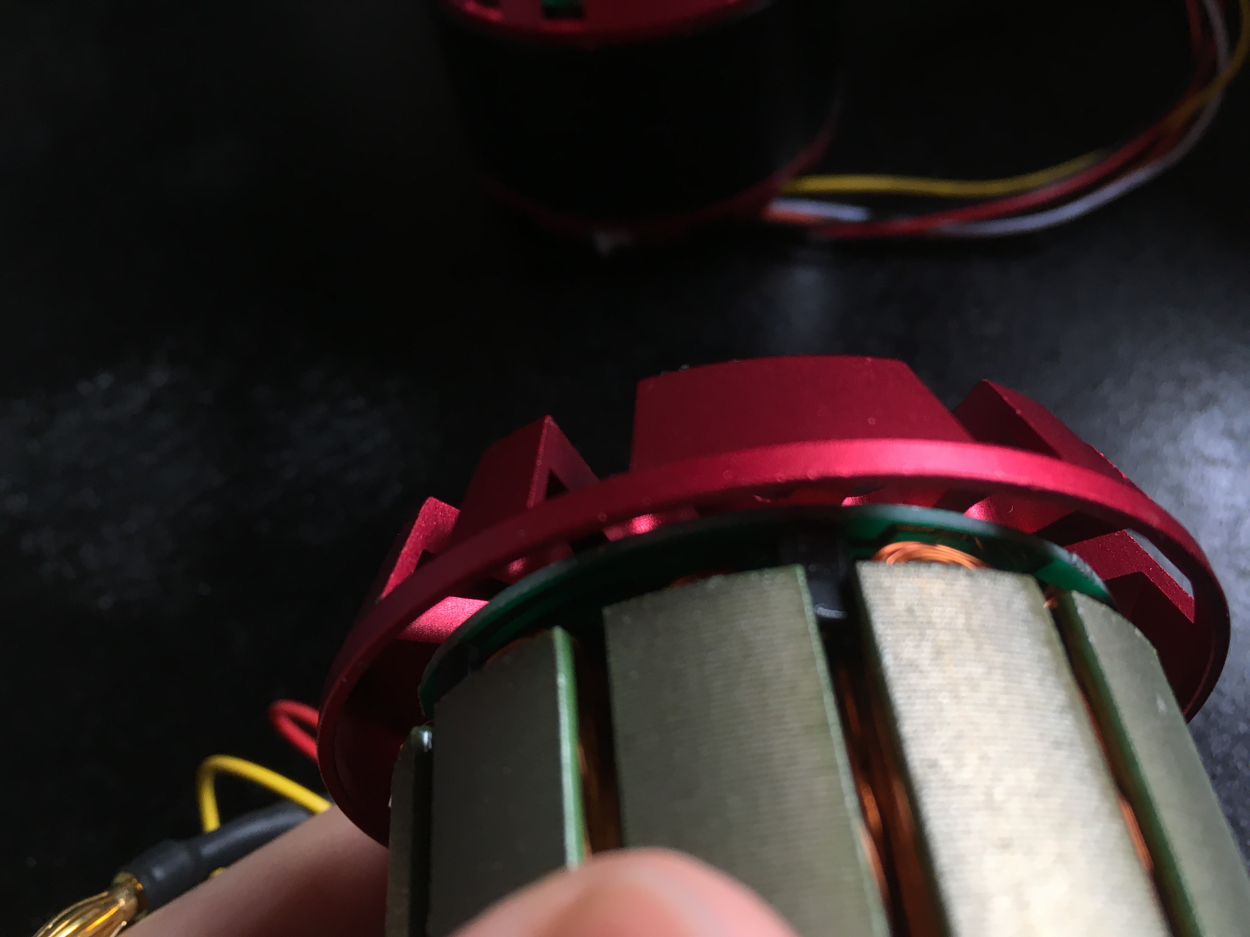

you do not see the glue. If there is epoxy (optional) is only at the rear contact point between the pipe and the stator. Believe me they are all connected in the same way. Whne I talk about heat I mean a heat gun not a torch. Doens’t have to be crazy adn only at the back is where matters. IT has to be enough to soft the epoxy. For the rest they are all held in polace by friction. You need a find a tube or pipe of the same diameter and hammer it slowly but with precise hit from the front. I think I posted pics in the older forum. One the stator is out most of the time a key way will follow. Of course you have to remove the bearings before.
Same for the shaft. There there is no glue, one or 2 grub screws instead. then place the plate on heavy surface having the shaft in the air. Hammer it on the shaft alone form the outside and walla’.
th keyway is inside but placed like this most of the time
(I used a different pipe, first 2 pics are from the facotry when I asked how to disassemble the stator the first time)
maybe you did not realized how much friction there is between a stator and pipe. Pliers won’t work. As for milling machine bearing replacement you need a pipe of the same diameter so that you focus the pressure in a specific point.
