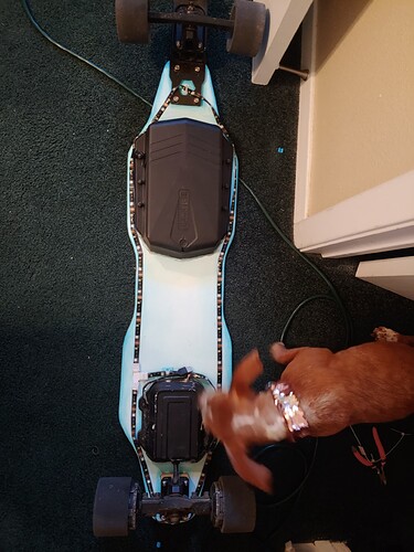

Here is what it looked like earlier this year before the LEDs killed themselves:
Here is what it looks like now ft scuff marks from my shoes and other road dirt that needs to be cleaned off:
Once my arm is less sore and useable I’ll be cleaning it up again and removing the dead LEDs and the dirty hot glue holding the wires for it onto my esc enclosure. Might even finally fix my right motor sensors too.

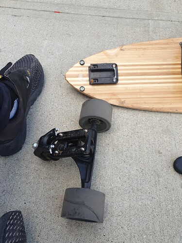

I got some better photos of the break for you. The texture at the break in the other seems a bit misleading since it wasn’t a clean cut through the material.
(The truck got scratched up after the surf adapter broke)
To me it doesn’t look porous, but I’m no expert when it comes to metals. Also the company has claimed that they will be doing more testing as a result of me managing to break it lol

I still need to confirm with the company but I believe I found the issue. The adapter I originally got was always defective, but I just didn’t know it was/ realize there was a problem. When it arrived I could never move the plates with my own hands and even in use it took a heavy lean to ever see the plate rotate.
The new one they sent I could easily rotate it with just my hands even with still being injured. I was also able to easily do a u-turn on a one lane road with room to spare when before I needed it to be a wide road and even then I would get really close to hitting the curb. I never thought to loosen the nut on the original one as the package stated not to as it was not a king pin although that may have been talking about the rail adapter. Trying to loosen that bolt now is impossible for me and I need to give it to some stronger people to see if they can undo it.
Without the ability to freely rotate that bottom plate that broke would have constantly been under excessive force from every single bump and rough surface. It is honestly impressive that it could hold up for as long as it does, and now I trust the product so much more knowing that a defective product took so long before fully failing.

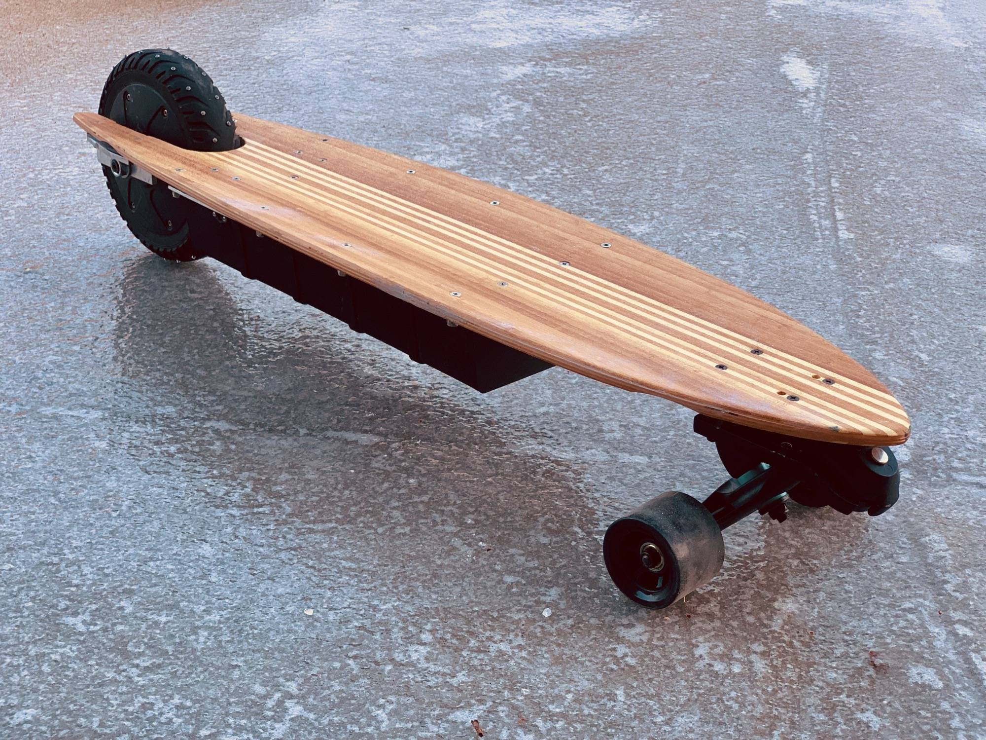

I figured I should probably update this thread to help add some reassurance to any one looking at buying a surf adapter. Since I just realized it has been a while since this happened
My current main board is using a surf adapter I bought second hand and it currently has had no issues. I did replace all the bearings as well as paint it red because aesthetics but it has continued to work as expected.
The replacement adapter the company sent is still in great shape but I haven’t used that board in like a year so it has seen less use than the second hand adapter. I have not tried the new version they have with an extra part you can swap around to change how the board carves but the design is super similar to the OG adapter so i’d trust it too if I bought one.
The concept of having a single wheel in the back combined with a surf adapter is not a bad idea at all.
