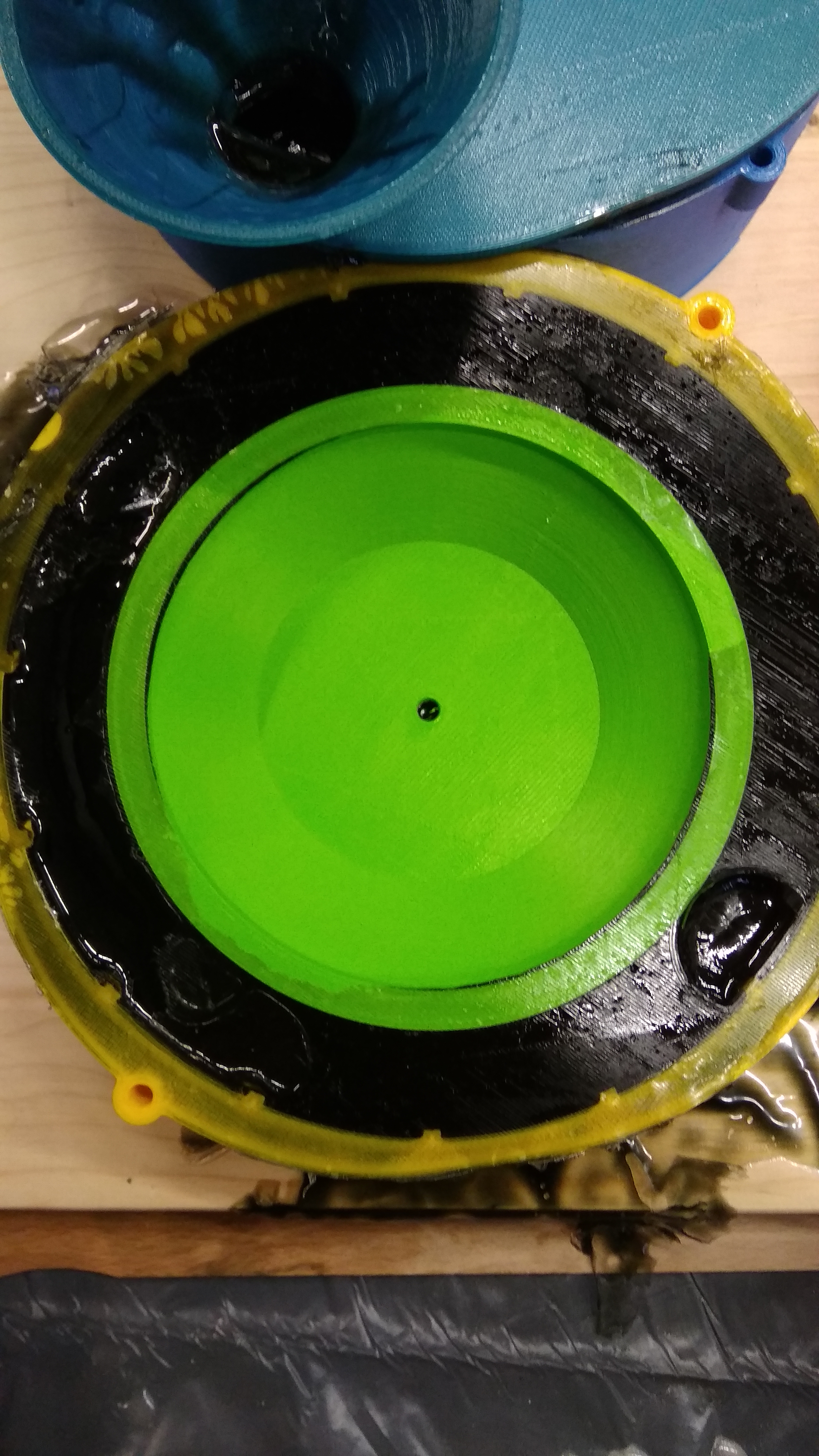

So little update. Did my second pour and it did as intentioned but i didn’t use enough PU. But these are prototypes so all is good.
You can see that the enclosed mold did it’s job providing a smooth outer surface but the lacking of enough PU is a shame. Gotta change my design so one pack of PU is enough for one job.
Update
So i broke my 2nd batch of wheels free and it was as expected a fail. One of the wheels didn’t rly harden completly and i guess it was because i didnt take enough time mixing. I probably relied on the mixer too much, which i attached to my drill. It is probably good to get a rough mix but you still need to work it with a spatula and scratch the bottom and walls, that would explain why it only had some soft spots but still unusable.
Secondly, if you 3D print a mold, take a lower layer height. Printing it too fast makes the mold leaky and it pushes through the layers, it doesn’t affect the pour that much but it wastes PU. The good news is that the closed mold did it’s work and gave a smooth finish on top, if had enough PU…I will redesign the wheel a bit so it takes less PU. Just enough that i can get one batch out of PU Kit.
I will probably just use 2 wheels i poured and mix them with normal 6" tires i have.
