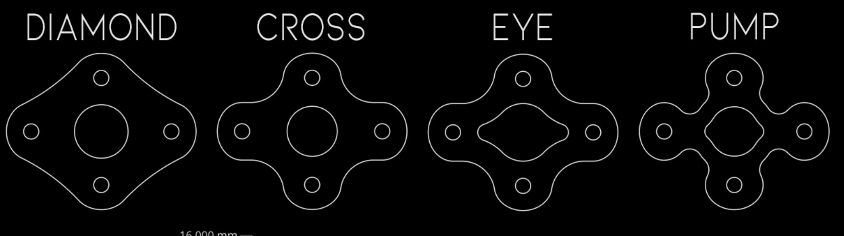

inspired by rojas…
here are the different available shapes of that big center bushing, rojas offers:
@RipTideSports Do you think one of those shapes can really give a “linear” resistance?

Enlarging one of the holes controlling the hanger will do this and make the center less stiff and the response more linear. Double the diameter of the stock hole in the bushing so it does not initially engage the control pin until you are off center a bit.
